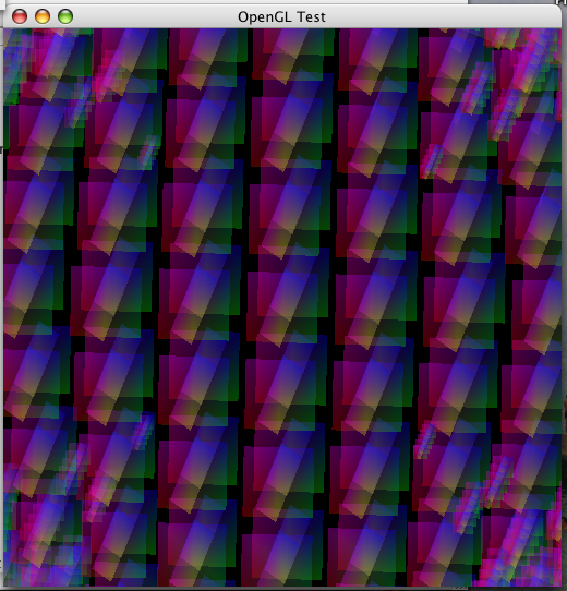

Krazubu Posted July 15, 2008 Share Posted July 15, 2008 Ok, Im back with the results. I attached the 2 dumps, with and without drivers. With drivers, anything that uses OpenGL will crash as soon as it tries (screensaver panel, Xbench, OpenGL extensions viewer). I joined the crashlog, I thought it might be useful. Did this under 10.4.8, using 10.4.7 GFX kexts and OpenGL.framework PS : Maybe you already knew but I noticed that ATIRadeon8500.kext is not unibin anymore in Leopard. crashlogOGL9250PCI.txt dump9250PCIdriver.txt dump9250PCInodriver.txt Link to comment https://www.insanelymac.com/forum/topic/113238-qe-problem-on-some-radeons-investigations/#findComment-820403 Share on other sites More sharing options...
Slice Posted July 15, 2008 Author Share Posted July 15, 2008 Ok, Im back with the results. I attached the 2 dumps, with and without drivers. With drivers, anything that uses OpenGL will crash as soon as it tries (screensaver panel, Xbench, OpenGL extensions viewer). I joined the crashlog, I thought it might be useful. Did this under 10.4.8, using 10.4.7 GFX kexts and OpenGL.framework PS : Maybe you already knew but I noticed that ATIRadeon8500.kext is not unibin anymore in Leopard. I read your reports. No answers but new questions. You have exactly the same crash.log as me. Why? 1. You have no AGPGart so it is not problem of the AGP driver. 2. Your DevID is directly supported by Radeon8500 so it is not problem of incorrect patch. 3. You have dedicated memory while I have shared memory so it is not problem of addressing. So I can suppose that the problem in ATIRadeonGLDriver or in OpenGL.framework. Thread 0 Crashed: 0 ...apple.ATIRadeon8500GLDriver 0x0ea75964 gldChoosePixelFormat + 1974 1 GLEngine 0x0e90670c gliChoosePixelFormat + 78 ATIRadeon8500.kext is PPC only in Leo because Apple didn't make a whole set of ATI drivers for R200 in Intel flavour. Significant part of PowerPC driver contains in EFI that inject it in registry | | | "driver,AAPL,MacOS,PowerPC" = <6d74656a000000000f4154592c526f636b486f70706572320000000000000000000000000000 0000101806400000006112e446973706c61795f4475616c486561640000000000000000000000000 000000000000000000000000000000000000000000000000000000000000000000000000016e6472 67669646f01000000> But it is useless for us. Link to comment https://www.insanelymac.com/forum/topic/113238-qe-problem-on-some-radeons-investigations/#findComment-820532 Share on other sites More sharing options...

rjstrat Posted August 2, 2008 Share Posted August 2, 2008 I found in IOKitUser project by Apple some routings like GA.plugin. It is new chance for investigations. Hi Slice, I just returned from trip, I am posting results/errors of ATI 9800pro-i865g combo, I apologize if this is redundant, just trying to give all info possible. It is interesting that I have ATI Dev: 0x4e48, which is supposed to be native support in 9700.kext, yet nothing seems to work. With 9700GA plug I show QE and CI support, yet neither seem to function, with or without AGPGart.kext. Open GL fails to initialize and I will get blank black or white window. CI also gives same result. Also, with 9700GA plug and AGPGart loaded, I get very slow scrolling/window redraw even though I show QE/CI. Let me know if I can test anything. Thanks again for huge effort, rj 9800pro_i865g_logs.zip Link to comment https://www.insanelymac.com/forum/topic/113238-qe-problem-on-some-radeons-investigations/#findComment-842399 Share on other sites More sharing options...
Slice Posted August 2, 2008 Author Share Posted August 2, 2008 Thanks for testing. Really new results. I see crash log is always different. Different reasons? Or different effect for a one reason? Needs to think. Aboud bad XBench UI result - no news. I think it is framebuffer problem and I am trying to make new one. ATIMonitor crashes with the same reason 3 com.apple.CoreGraphics 0x90326543 CGSNewRegionWithRect + 371 4 com.apple.CoreGraphics 0x903d4283 bindDisplayMapping + 337 5 com.apple.CoreGraphics 0x90325169 updateAllDisplayInfoAsNeeded + 193 It is allocating region to write into display. Typical task for framebuffer. And DVD crash with Binary Images Description: 0x1000 - 0x1acfff com.apple.DVDPlayer 4.6.5 /Applications/DVD Player.app/Contents/MacOS/DVD Player 0xc102000 - 0xc1a1fff ch.rafz.naegeli.christoph.xvid_codec 0.x.x /Library/QuickTime/XviD_Codec-r58 (Intel).component/Contents/MacOS/XviD_Codec 0xc257000 - 0xc2c8fff com.DivXInc.DivXDecoder 6.2.5 /Library/QuickTime/DivX Decoder.component/Contents/MacOS/DivX Decoder 0xc2d6000 - 0xc375fff com.apple.QuickTimeImporters.component 7.4.5 (67) /System/Library/QuickTime/QuickTimeImporters.component/Contents/MacOS/QuickTimeImporters 0xc399000 - 0xc4ebfff ch.rafz.naegeli.christoph.ff_avi_importer 1.0 (0.0) /Library/QuickTime/AviImporter-r7 (Intel).component/Contents/MacOS/AviImporter 0xd38d000 - 0xd3e1fff com.apple.AppleVADriver 4.0.3 /System/Library/Extensions/AppleVADriver.bundle/Contents/MacOS/AppleVADriver May be Xvid is not correct? Link to comment https://www.insanelymac.com/forum/topic/113238-qe-problem-on-some-radeons-investigations/#findComment-842657 Share on other sites More sharing options...
