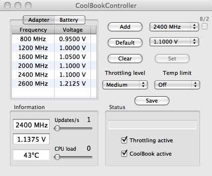

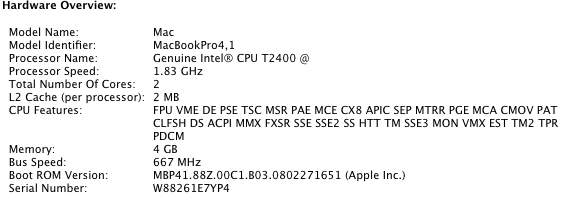

mitch_de Posted June 1, 2008 Share Posted June 1, 2008 Hi, i tried CoolBook, ist shareware but running as non regisered good as normal speedstep addon. http://www.coolbook.se/CoolBook.html Only for changing (clock down/clock up, chaning VCORE) you can buy it. (May that didnt work with non Macbook/MacbookPro/iMac !!!) I would be careful with that (if you buy it) may damage your bord/cpu if VCORE changes went wrong! But, as an steedstep CPU cool down and temp show ONLY its great without registering. Before, like you and others i tried some steedstep things found here, but never worked real. Go in the CB App package (FInder open package), go into coolbook2.kext (FInder open package) and change one of the Madell IDs found in its plist. They are all for iMac and iBook, Macbook. So its not usable (shows no temp, speedstep didnt work)) until you change one of them to your ModelID. Save changed info.plist. set owner / rights back root:wheel that kext can be used/loaded later! Terminal: sudo chown -R root:wheel ***DRAG & DROP coolbook2.kext here **** sudo askes for admin passw. Then give it a try. Start CB. ( if you started before you changed Modell ID, you must delete coolbook2.kext first from the system/Extension, and you wil be askes at 2. CB Start for install that(your modded) again. You will see immediatly if it worked if CB Window shows CPU TEMP and Clock (you can set in the Apps Preferences that CB shows CPU TEMP in Menü if it runs) You can test cooling if you give CPU Load with the slider. CPU Temp rises much (speedstep gives CPU max. GHZ). Then set CPU Load back to 0 (normal!). CPU Temp cool down quick, also GHZ will be mostly down, if nothing else uses CPU. CoolBooks speedstep works WITHOUT CB running all the time. (coolbook2.kext works as speedstep in background, even if you reboot after first install/run). You need running CB app only of you cange some CB Preferences like Menü Temp. Your ModelID is show in the About this Mac window. My is MacPro3,1 - it depens whisch AppleSMBIOS.kext you use. Will only work on C2D , CD or E2XXX CPus (no Pentium D, no AMD i think, its different ) . Sure, you should have an method to boot from an other HD , if CB fails (Kernel Panic). It isstalls andf loads the cb.kext at first run of the app - so it works immediatly (no reboot) or not. Link to comment https://www.insanelymac.com/forum/topic/108148-using-coolbook-as-speedstep-for-cool-down-cpu/ Share on other sites More sharing options...
Chrysaor Posted June 3, 2008 Share Posted June 3, 2008 Are you sure it is working, is it changing steppings? I have registered version and it just sits at the 12x stepping, voltage changes doesn't take effect. Link to comment https://www.insanelymac.com/forum/topic/108148-using-coolbook-as-speedstep-for-cool-down-cpu/#findComment-769391 Share on other sites More sharing options...

Memorial Posted July 27, 2008 Share Posted July 27, 2008 Works for me. I am using Superhai's SMBIOUSResolver, its awesome. CoolBook tells me that its working, I can start MATLAB and it will show that is is throttling. My problem is sysctl still reports the min cpu frequency at 1.5 GHz (which is the set frequency for the laptop). I am a little irked that the license only has 1 reset (i.e. I can only reinstall once). Link to comment https://www.insanelymac.com/forum/topic/108148-using-coolbook-as-speedstep-for-cool-down-cpu/#findComment-835327 Share on other sites More sharing options...
