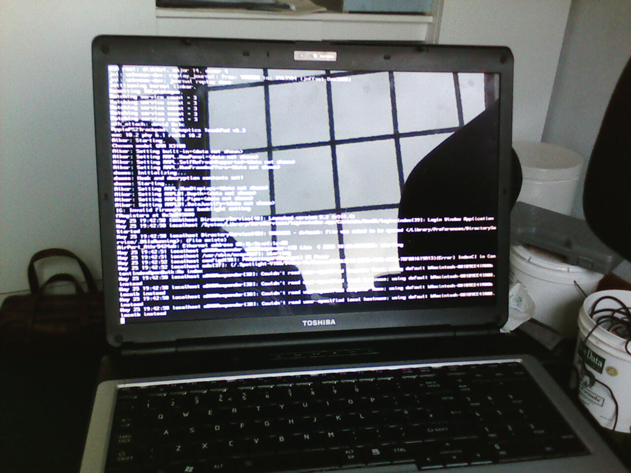

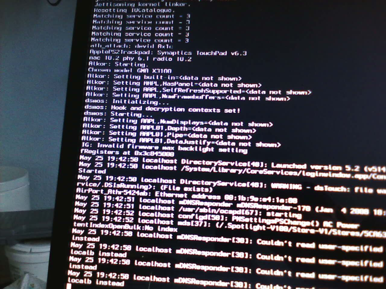

Jonty! Posted May 25, 2008 Author Share Posted May 25, 2008 Toshiba Equium L350-10L EDIT: Added some screens below. Sorry for rubbish quality the lighting isnt the best. I found if I plugged in an external monitor the white went away but it went back to these lines. If you want photos of other bits of the screen just ask please! Thanks Link to comment https://www.insanelymac.com/forum/topic/106811-x3100-help/#findComment-758475 Share on other sites More sharing options...
