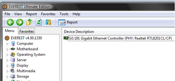

nguzun Posted October 31, 2008 Share Posted October 31, 2008 hello, i have the same network card on my notebook, and with everest it's show that it have a RTL8102cl chipset, plss guys i need this driver, if I can help with something, i will be ready in any time. thanks a lot Link to comment Share on other sites More sharing options...
ole2 Posted October 31, 2008 Share Posted October 31, 2008 hello, i have the same network card on my notebook, and with everest it's show that it have a RTL8102cl chipset, plss guys i need this driver, if I can help with something, i will be ready in any time. thanks a lot what do you mean by: "and with everest it's show that it have a RTL8102cl chipset"? it it PHY one you have connected to? maybe you mean RTL8201 ? Link to comment Share on other sites More sharing options...
nguzun Posted October 31, 2008 Share Posted October 31, 2008 i kwon that, i have tried many drivers but without succes, i don't kown what i must do !! Link to comment Share on other sites More sharing options...
Slice Posted October 31, 2008 Share Posted October 31, 2008 Yes, NIC contains two chip: PCI and PHY. In your case first is SIS, second is Realtek. Link to comment Share on other sites More sharing options...
