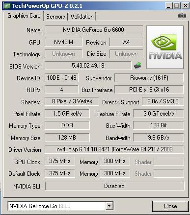

kc78 Posted May 17, 2008 Share Posted May 17, 2008 hello inquisitor06, i used gpu-z to figure out a bit more about my card. maybe it could help. Link to comment Share on other sites More sharing options...
inquisitor06 Posted May 18, 2008 Author Share Posted May 18, 2008 I'll boot into windows and see if it matches. Link to comment Share on other sites More sharing options...
