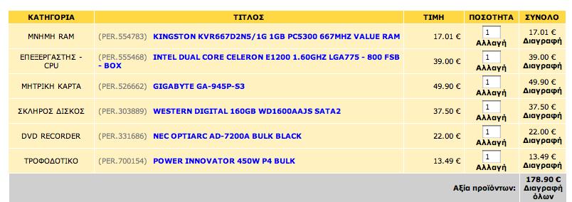

macmagix Posted April 27, 2008 Author Share Posted April 27, 2008 hey guys thank u i just check the hardware and i build this(see the attachement) i want to use it as downloading machine, and media server don't want display i will administrate it via VNC. ( i will back up music on it,(with a second backup disk with time mashine) so the computers on my home net will use the itunes sharing and iphoto sharing to use everything photos music video nothing else ) is it good? what do you think?? Link to comment https://www.insanelymac.com/forum/topic/101533-cheapy-hackintosh/#findComment-726063 Share on other sites More sharing options...
Xosx86 Posted April 27, 2008 Share Posted April 27, 2008 Looks good to me Just to let you know you could set up leopard server on that thing. After you install kalyway and run all the updates. All you have to do is move the server tools and other server files from the Leopard 10.5 server DVD. You don't need to patch the Server image or dvd at all. Then you have a hackintosh server good luck:) Link to comment https://www.insanelymac.com/forum/topic/101533-cheapy-hackintosh/#findComment-726385 Share on other sites More sharing options...
