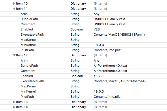

1. just put 2 kext HS80211Family.kext & AirPortAtheros40.kext  .../OC/Kexts and make sure inject via config.plist
  do not inject IO80211NetBooter in the plist (must do research so i leave there in plugin),  I remove IO80211NetBooter from plugin so as not to confuse
see my pict below just add 2 value

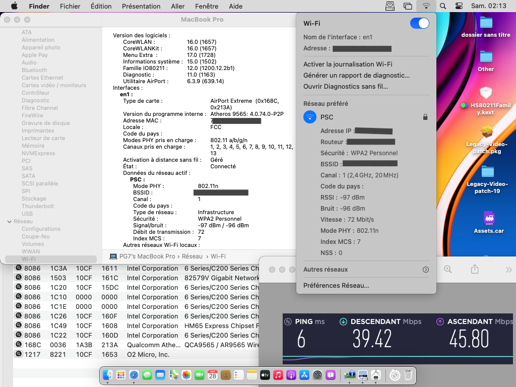

1 hour ago, oldman20 said:
Im using AR9285 and after edit plist file wifi work with OpenCore-BigSur/ Catalina. But can't work with Clover-Big Sur/ or Catalina, what should I do, thank?
problem already solved in the next commit, it has been solved and is working without problems!
I leave here a folder with Clover r5127 where it solves in BigSur but using BOOT.efi as well as CloverX64.efi and the kext that are already ready for AR9285 that I use myself
Spoiler
ar9565.thumb.png.280c02178709c06e3502b62a69458f8b.png1201907248_ar9485-2.thumb.png.c23f48cccabb80089b4f3f368093d32d.png662883162_ar9485-1.thumb.png.b9a21ee87e16c765b8261bc838e23bf7.pngar9285.thumb.png.f779f1e3b640eff7227147efbf4479ba.png
r5127 BOOT + Drivers + Kext Ateros ar9285 BigSur.zip
  • Like 3
  • Thanks 3

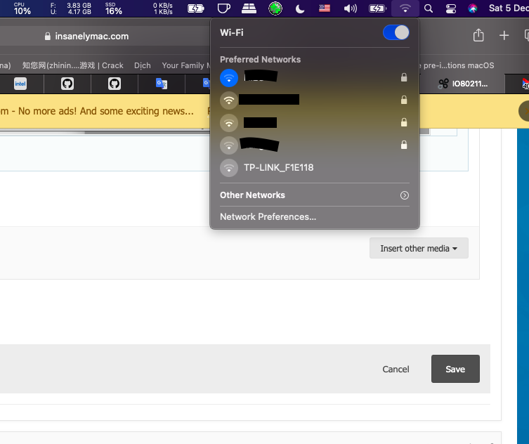

btw, how can you make wifi menu more detail like that?

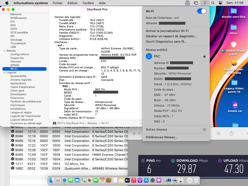

1123152749_Schermata2020-12-07alle19_34_19.thumb.png.badd3553500081587aa2a536126249ff.png
Hi I tried the kext for Wifi Atheros 9485. The wifi works, the download / upload also works quite well.
The only thing that doesn't fit me is the range of channels that it can see and the wifi icon always shows only one notch. Even if I'm very close to the wifi source?
Is there something I'm wrong?
