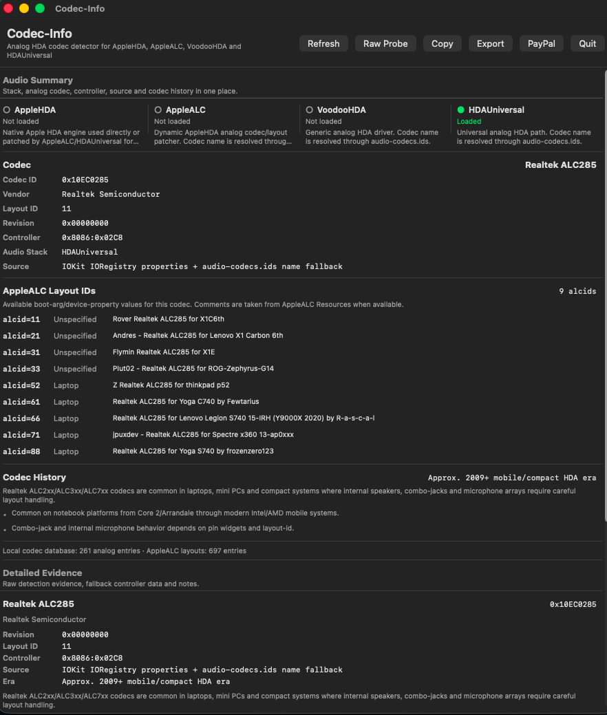

Just installed HDAUniversal from here on my HP EliteBook 850 G7 laptop running Tahoe 26.5.2 (25F84). The installation could not have been any easier: Remove other audio kext from /Library/Extensions (in my case, I removed VoodooHDA.kext) Set csr-active-config = <03000000> and Reboot Run HDAUniversal.pkg When prompted, Allow HDAUniversal in System Settings > Privacy & Security Reboot Set csr-active-config = <01000000> Audio quality is outstanding! EDIT: What I continue to love about this is the ease of installation, the fact that I can use it with SIP csr-active-config = <01000000> (Allow untrusted kexts) which is no different than injecting untrusted kexts with Open Core or CLOVER, and I don't need to unpatch/repatch every time I update macOS. It just works. Nice work, MaLd0n! Codec-Info

Installation of VoodooHDA.kext 3.6.4 was easy on my HP EliteBook 850 G7 running macOS Tahoe 26.6 Beta (25G5065a): Remove other audio kext from /Library/Extensions (in my case, I removed VoodooHDA.kext 3.6.2) Leave csr-active-config = <01000000> (No need to relax SIP when replacing VoodooHDA.kext with another VoodooHDA.kext) Modify VoodooHDA.kext/Contents/Info.plist: VoodooHDAEnableVolumeChangeFix = True sudo cp -R VoodooHDA.kext /Library/Extensions When prompted, Allow VoodooHDA in System Settings > Privacy & Security Reboot Audio working perfectly. I don't have AMD HDMI on this hack, so I can't test AMD HDMI/DP audio, but audio quality with my internal speakers is outstanding. EDIT: Codec_Info
