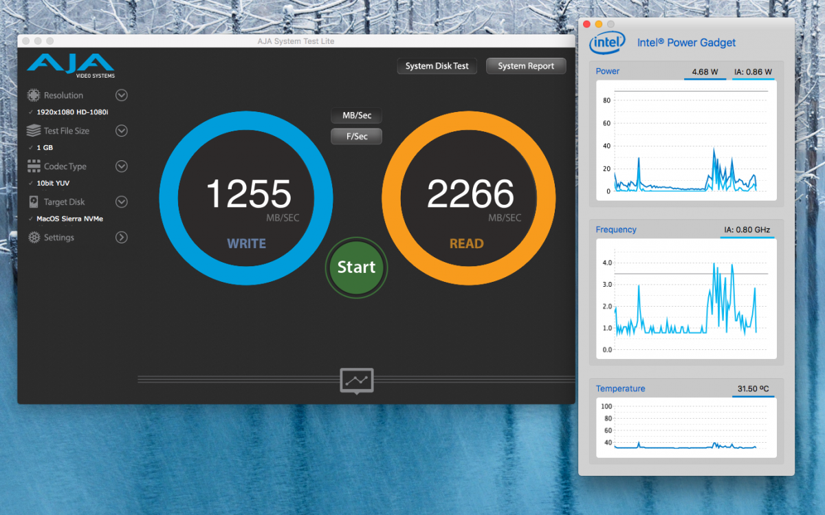

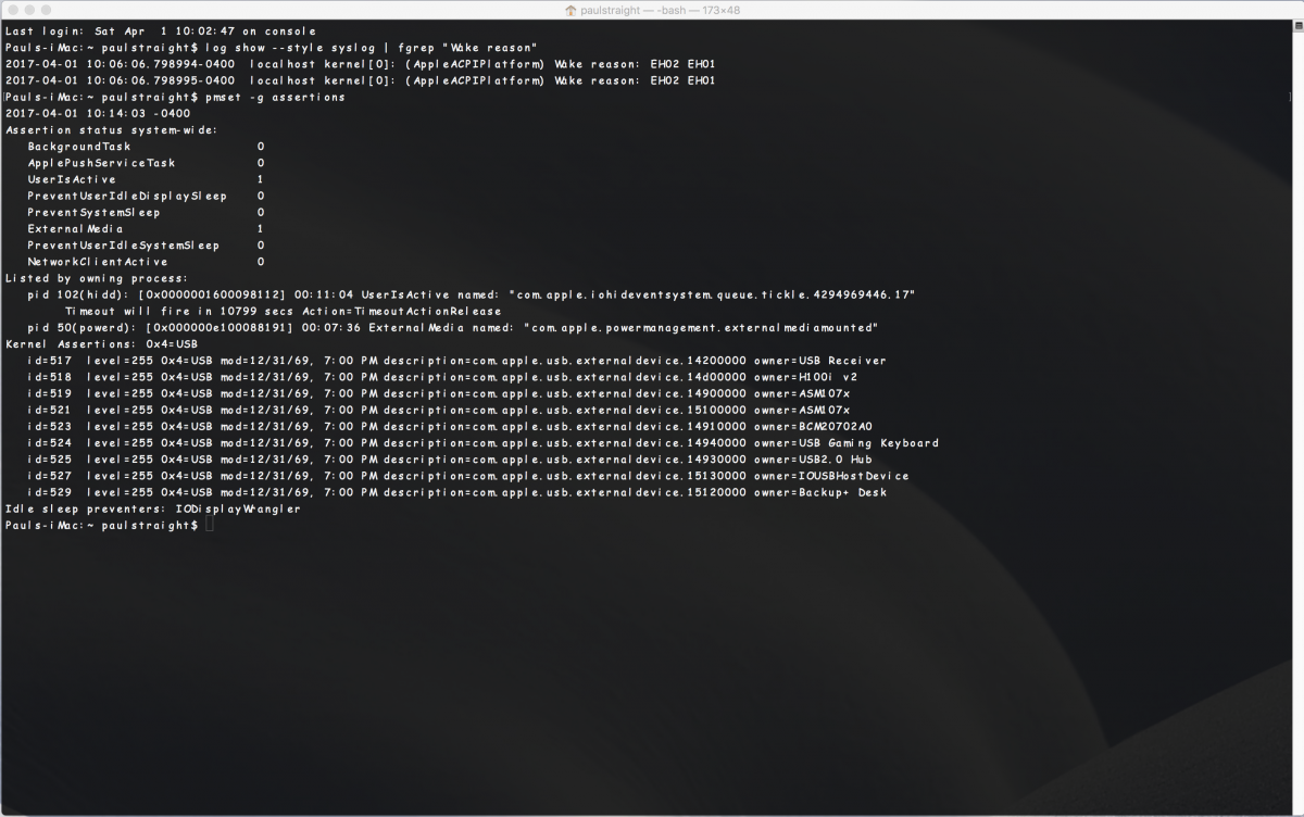

tikizondo94 Posted April 1, 2017 Author Share Posted April 1, 2017 Installed new clover folder. NVMe drive fires right up and amazing speeds! Powermanagement seems to be working on the CPU side. But still my machine auto wakes when going to sleep. Send me Paul’s iMac.zip Link to comment Share on other sites More sharing options...

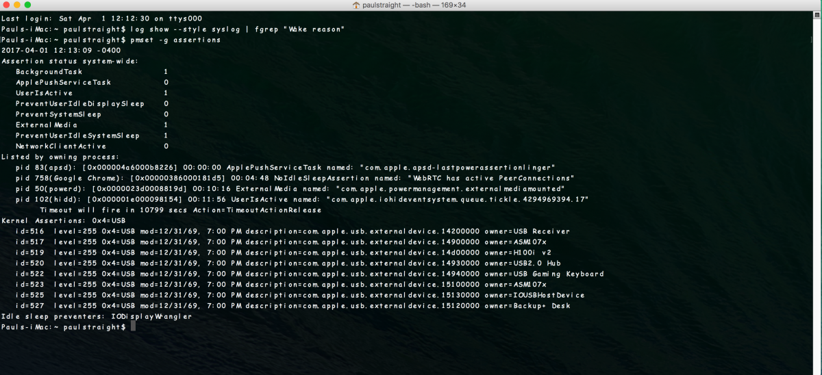

tikizondo94 Posted April 1, 2017 Author Share Posted April 1, 2017 Still the same result. Removed DSDT. Replaced with new. Cleared all logs, restarted. Tried to put to sleep. Wakes 3-4seconds after sleep. Im just wondering? I have and H100i water cooler on my system. And it has a USB connection to the board for Corsair controls in windows. I wonder if that could be the culprit? Send me Paul’s iMac.zip Link to comment Share on other sites More sharing options...
MaLd0n Posted April 1, 2017 Share Posted April 1, 2017 DSDT.02.zip EH01 and EH02 now lose power of wake Link to comment Share on other sites More sharing options...

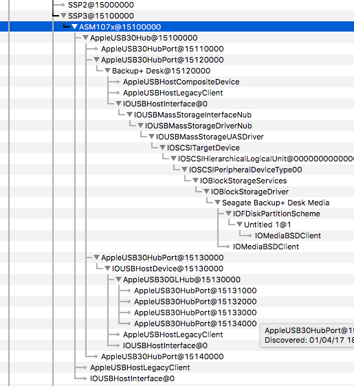

MaLd0n Posted April 1, 2017 Share Posted April 1, 2017 send me one ioreg IORegistryExplorer 3.app.zip u have many USBs device connect? Link to comment Share on other sites More sharing options...
tikizondo94 Posted April 1, 2017 Author Share Posted April 1, 2017 Not really. Keyboard, USB mouse, external hard drive and a usb 3.0- 4 port hub. Paul’s iMac.zip 1 Link to comment Share on other sites More sharing options...
MaLd0n Posted April 1, 2017 Share Posted April 1, 2017 Check, bro ASMedia usb is enable, i think the problem is there. btw, run Pike script, generate ur SSDT, save and compile --> SSDT.aml ssdtPRGen.command.zip Link to comment Share on other sites More sharing options...

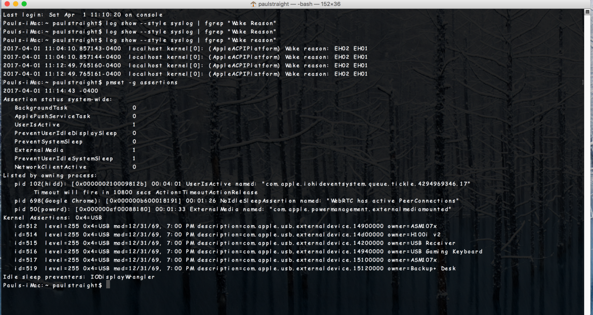

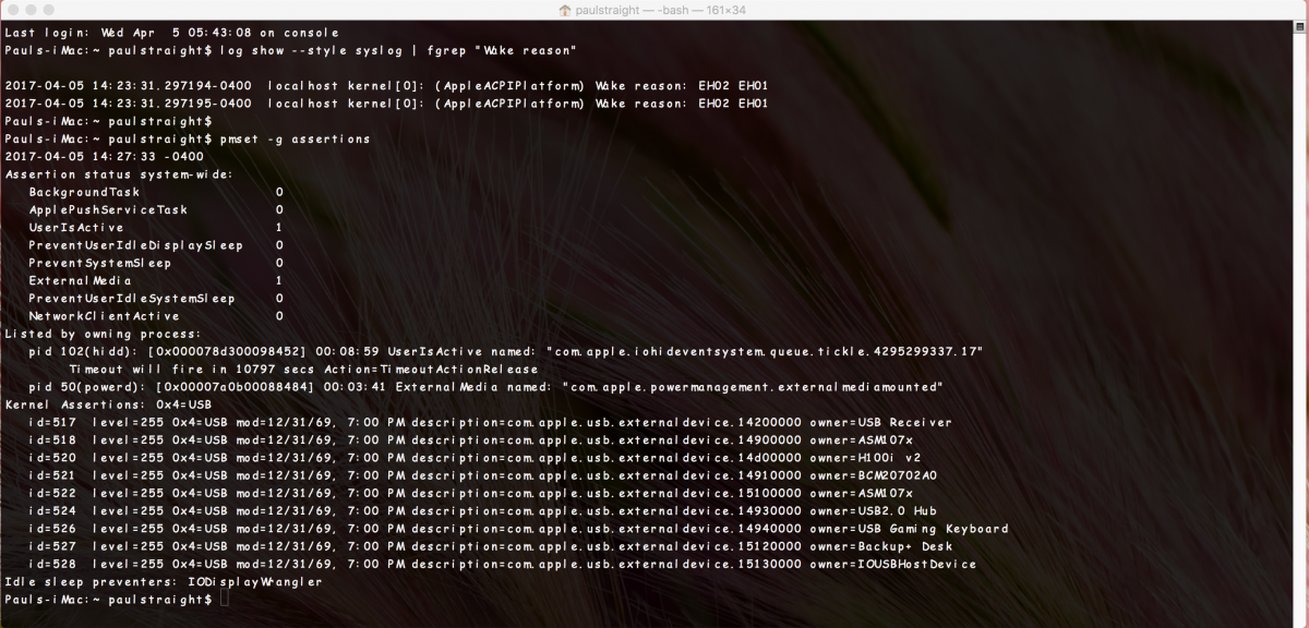

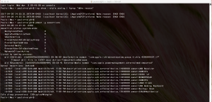

tikizondo94 Posted April 5, 2017 Author Share Posted April 5, 2017 I know its been a few days. Got my SSDT patched and installed and actually found ASMEDIA in my bios WAS turned on. "i disabled it now" It wasn't in the usual settings. Im used to gigabyte boards. ASRocks setup through me off. Anyways my machine still wakes directly after putting it to sleep. Heres a screenshot of my most current log. 1 Link to comment Share on other sites More sharing options...

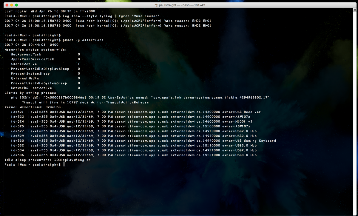

tikizondo94 Posted April 27, 2017 Author Share Posted April 27, 2017 Still cant get my hack to sleep but shut down works fine and after a few edits ive got my sleep log down to this point and now im lost. If anyone can help it would be much appreciated. Paul’s iMac.zip Send me Paul’s iMac.zip 1 Link to comment Share on other sites More sharing options...
MaLd0n Posted April 27, 2017 Share Posted April 27, 2017 Try DSDT.aml.zip 1 Link to comment Share on other sites More sharing options...

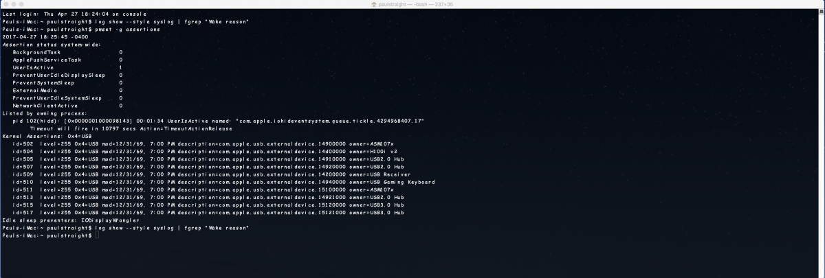

tikizondo94 Posted April 27, 2017 Author Share Posted April 27, 2017 Try DSDT.aml.zip Installed latest DSDT. system still reboots right after sleep. This time my display wouldnt recover. Just stayed as a black screen. "Both monitors" I use dual monitors. Heres my latest logs. Thanks again for all your help. I really do appreciate you taking your time to help me. Paul’s iMac.zip Send me Paul’s iMac.zip 1 Link to comment Share on other sites More sharing options...
MaLd0n Posted April 27, 2017 Share Posted April 27, 2017 remove fakesmc sensors, kexts cause many problems Use IPG Intel® Power Gadget SIERRA.zip i think ur hdmi audio work now, check It's hard and asmedia not disable, very strange. While asmedia is enabled, sleep will not work correctly 1 Link to comment Share on other sites More sharing options...
