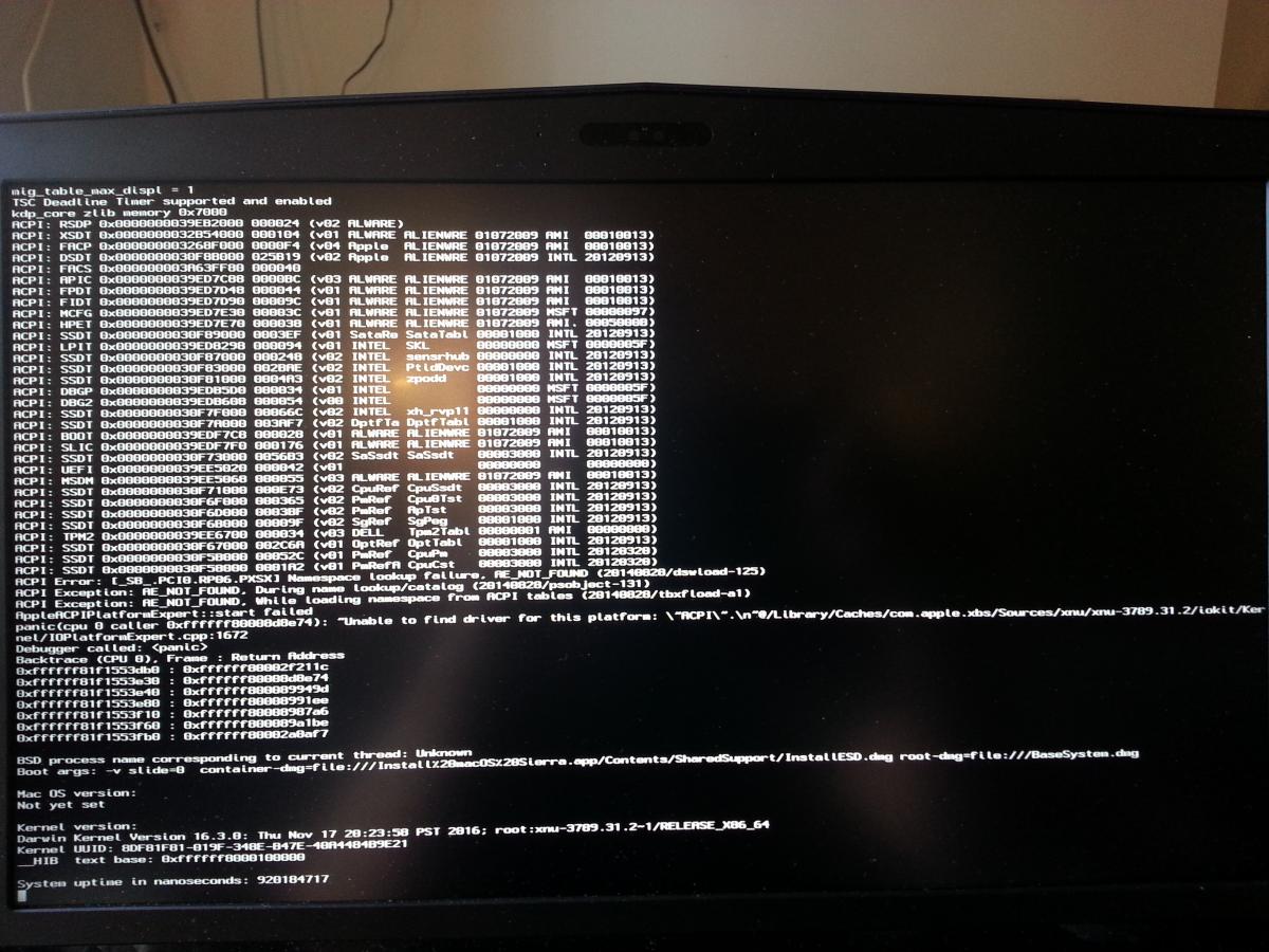

shaggymane Posted January 11, 2017 Share Posted January 11, 2017 I get this with my alienware 17 r4 skylake Link to comment Share on other sites More sharing options...
nawcom Posted January 12, 2017 Share Posted January 12, 2017 try booting with boot flag dart=0 and let me know if you still get the same error. It looks like Alienware 17 r4 comes with vt-d support and if it's enabled in the bios then it may be causing it which this boot flag will get around it. 1 Link to comment Share on other sites More sharing options...
shaggymane Posted January 12, 2017 Author Share Posted January 12, 2017 I disabled vt-d and tried dart=0 .. same error Link to comment Share on other sites More sharing options...

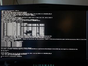

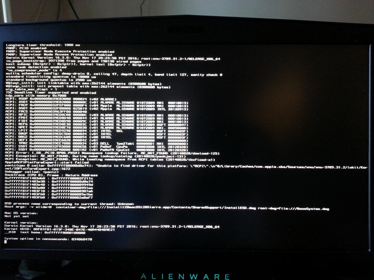

shaggymane Posted January 13, 2017 Author Share Posted January 13, 2017 any thoughts? still get same error I am not using any thing but -v dart=0 is there something else I should try? Link to comment Share on other sites More sharing options...
shaggymane Posted January 14, 2017 Author Share Posted January 14, 2017 tried a couple things.. this is what I get Link to comment Share on other sites More sharing options...

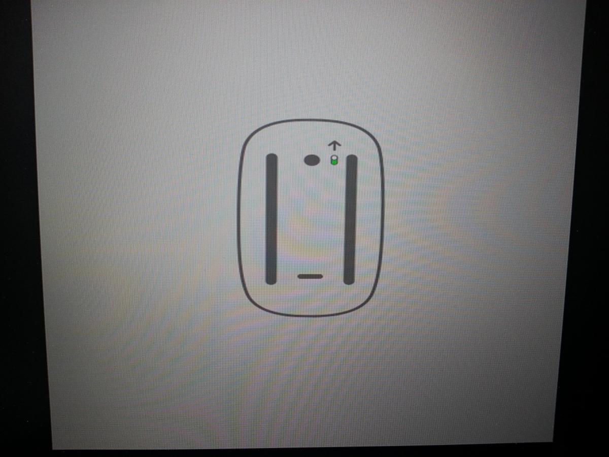

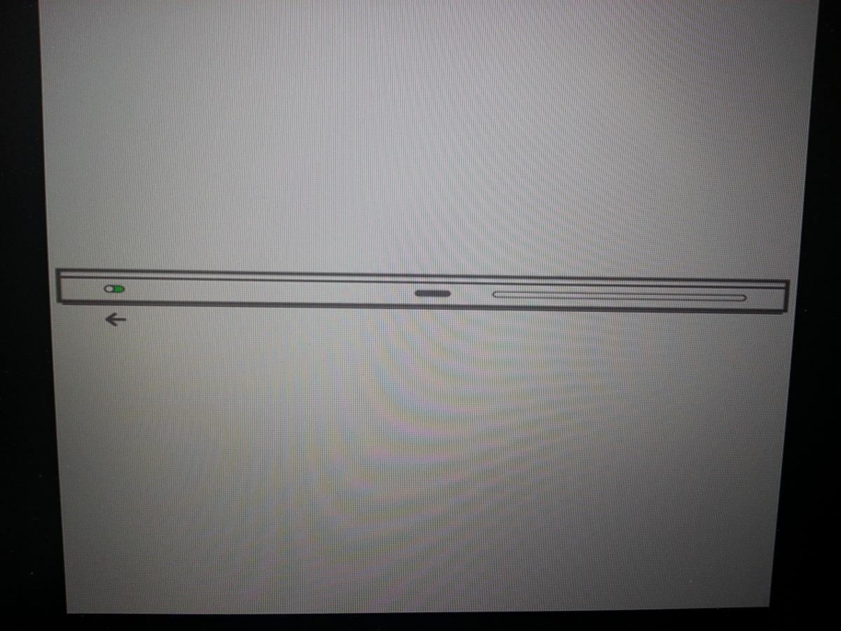

shaggymane Posted January 15, 2017 Author Share Posted January 15, 2017 kk I got passed the kernel crash by unclicking "airport" under dsdt.... this is what I get now when booting the installer.. Link to comment Share on other sites More sharing options...
nawcom Posted January 15, 2017 Share Posted January 15, 2017 What kext are you using for PS/2 support? keyboards and trackpads communicate through PS/2 on PC brand laptops while it connects through the USB bus in Macbooks so you need to include a kext to support it. Looks like your model has a Synaptics touchpad so this will work fine: https://bitbucket.org/RehabMan/os-x-voodoo-ps2-controller/downloads/RehabMan-Voodoo-2016-1208.zip ignore the VoodooPS2Daemon binary for now - just use the kext. 1 Link to comment Share on other sites More sharing options...
