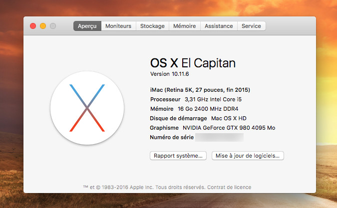

xiupe Posted July 25, 2016 Share Posted July 25, 2016 Hello everyone, I just installed successfully El Capitan on my PC (Clover, Full EFI). Nevertheless I encounter 2 problems: - My USB 3.0 ports do not work at all, including by applying the fix USB 3 Multibe4st Edit : Fix (it was simply install the package "Increase Max Port Limit" of Multibe4st) - I have the ALC1150 and I managed audio controller to have its functional by installing the version of the package AppleHDA Multibe4st to Yosemite, but when I listen to anything for a moment on the Mac, the reactivation of his or mounted volume via the keyboard or the menu bar works, but I started to hear sound after 5-10 second. Ago as an offset. My motherboard is an MSI Gaming M3 Z170a Thank you for your help and sorry for my English writing disgusting ^^ Link to comment Share on other sites More sharing options...
