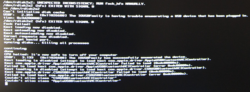

Ok, Installer finished with this alert window at the very end of process " System could not startup from HD Snow Leopard" (where I installed Mac OS X). Checked the disk with Diskutility and found no errors.
The machine doesn't boot, I left the USB installer plugged in and selected  the internal HD with fresh installation (after changing the kernel on the HD with legacy one as I did for the Installer). Clover starts and it stops at this point, shutting down the system, see attachement

Did you reparing permission and rebuilding cache  to the Install drive after changing the kernel?
I told you that in my last post.
I see in your picture C'ant initialise disk cache ?? :blush:
Try Put the drive to another PC and ran kexwizard like this
Yes Chris, I tried Kext Wizard repair permission and rebuild cache as well but nothing changed. I've just bought another PC on eBay, a very simple machine that should be more suitable for Snow Leopard. It's a HP 8000 Elite SFF, with a Core2 Duo cpu @3Ghz and 4Gb Ram. It was very cheap and hopefully it should work with SL, it seems this Z400 doesn't like that OS at all.... it can run Mavericks - Yosemite - El capitan perfectly but not SL or, at least, it's too tricky...

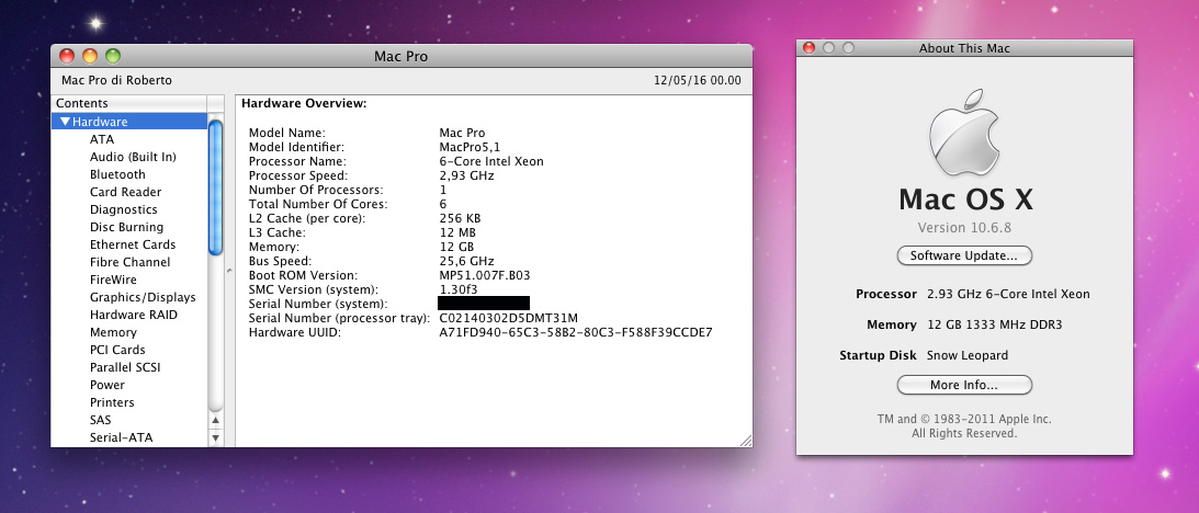

@Chris: I managed to boot my HP Z400 6 Cores from Snow Leopard. I had to remove AppleHPET.kext and Clover booted the machine, now I'm downloading 10.6.8 update combo........

Update to 10.6.8 went fine, system profiler reports correct informations about Cpu, Ram, Video card although I've only 1024x768 res and no acceleration. Are there some specific drivers for Nvidia Quadro2000 under Snow Leopard?

Downloaded and installed the driver you linked me, set nvda_drv=1 in Clover boot and everything works properly, video acceleration ok. The machine is quite responsive and fast.

Do you please post a screen capture with About this Mac  :D
