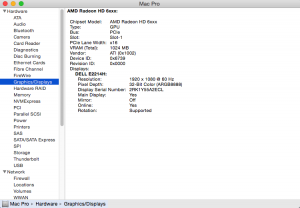

That's where i need your input, is this related to being PC card or not?

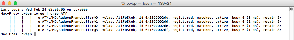

- Card being recognized as HD6xxx is EFI problem, and thats one thing i know for sure.
Yosemite is loading: AMD6000Controller, AMDFramebuffer and AMDRadeonX3000 kexts.

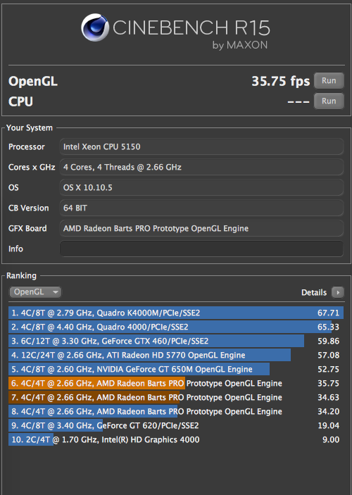

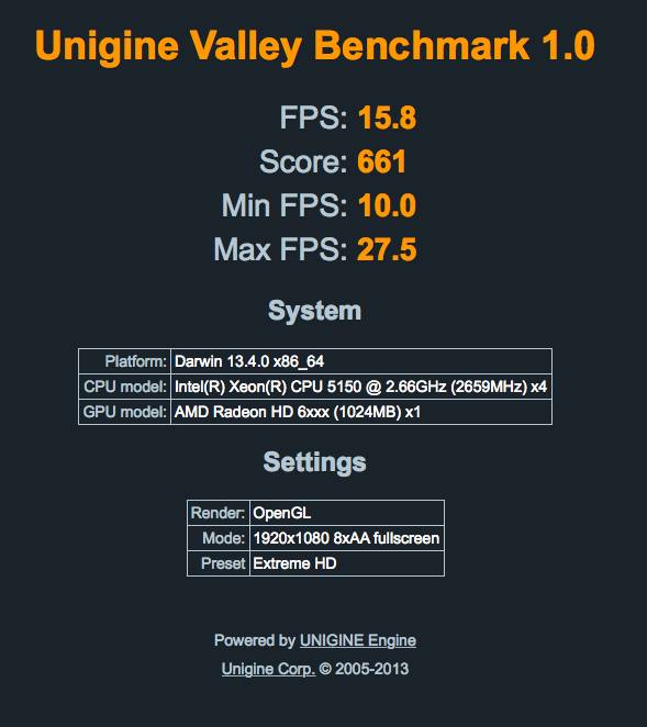

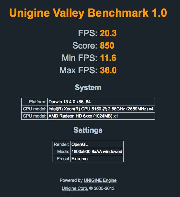

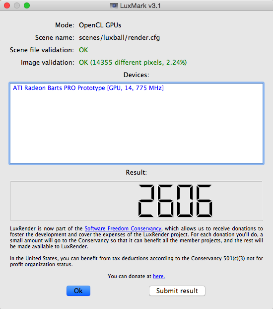

Next, few benchmarks are working OK, but i don't know if the results are as they should be?
post-1517990-0-79117500-1456020939_thumb.pngpost-1517990-0-68663800-1456020952_thumb.png
post-1517990-0-07430500-1456020960_thumb.jpgpost-1517990-0-59966600-1456020967_thumb.jpg

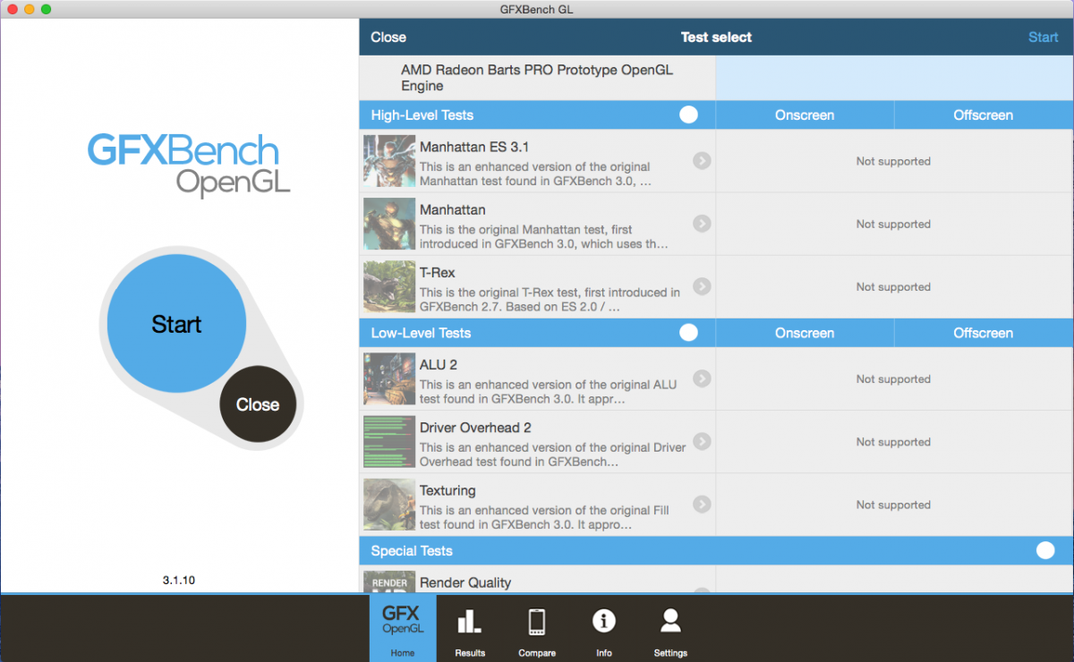

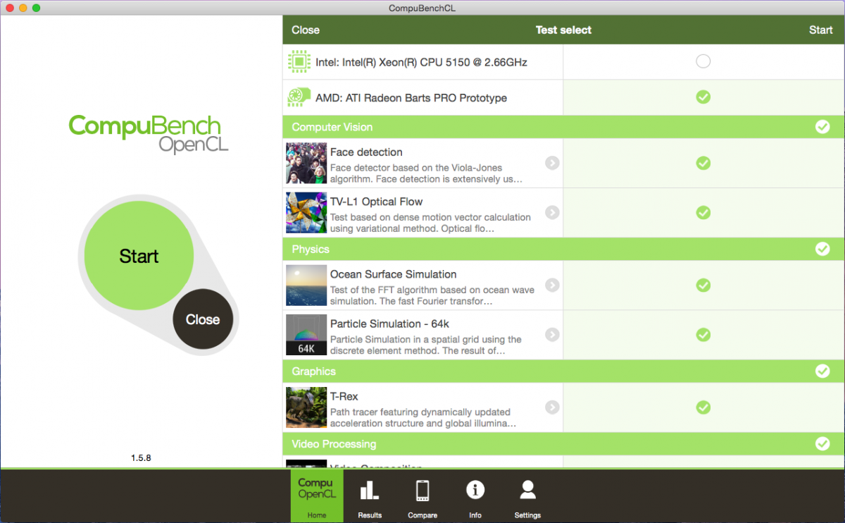

But GFXBench and CompuBench are not working at all.
post-1517990-0-11450200-1456021051_thumb.pngpost-1517990-0-93777000-1456021065_thumb.png
In CompuBench i can mark benchmarks i want to run, but it just goes through load process, as you can see in this video.

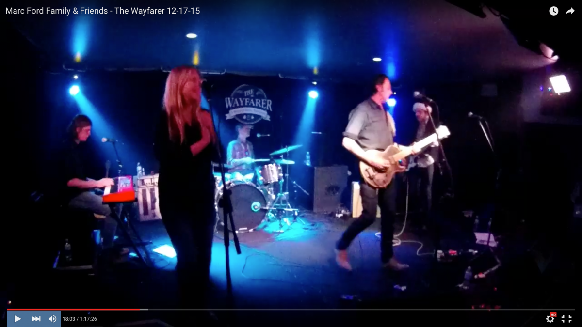

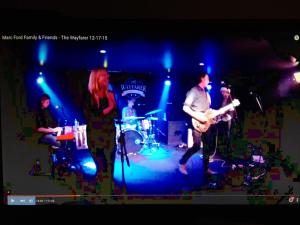

Also, i had twice the experience of bad pixelation in OS X and red, yellow and green dots on black screens in all videos (Youtube, FCPX, VLC...). The clock, icons on dock, all was suffering from strange graphics artifacts. It goes back to normal after reboot, and doesn't occur if i prevent OS X from going to sleep. then its all good. But if i keep it on with few sleep/wake cycles it happens. As far as i can tell.

I left it on sleep over night and upon waking, after 8 hours, it developed the same screen blurs and red/green pixels on dark video backgrounds.
I took the screenshots to show them to you, but after log out/in the screenshots were normal looking as was the whole display.
So system sees it as it should, screenshots are showing artifacts only when the whole screen is showing them too.
Next time ill take camera pictures. :thumbsup_anim:

I had it happened again today, after few hours sleep:
Screenshot of YT video (after reboot it looks normal, as you can see)
Phone picture of the screen
Hi, I'm not really sure what is the problem? Card seems working fine, benchmarks are OK for that card. You're lucky it worked as you didn't pick most compatible series of GPU's.

Yes, it works and it is really being improvement on all GPUs i had used so far on my hacks/PCs, just interested why  GFXBench and CompuBenchs are not supported and why sometimes, after a Mac sleep, it shows artifacts as in pictures above. Should flashing EFI fix those tiny problems, or if there's no need to flash it at all.
