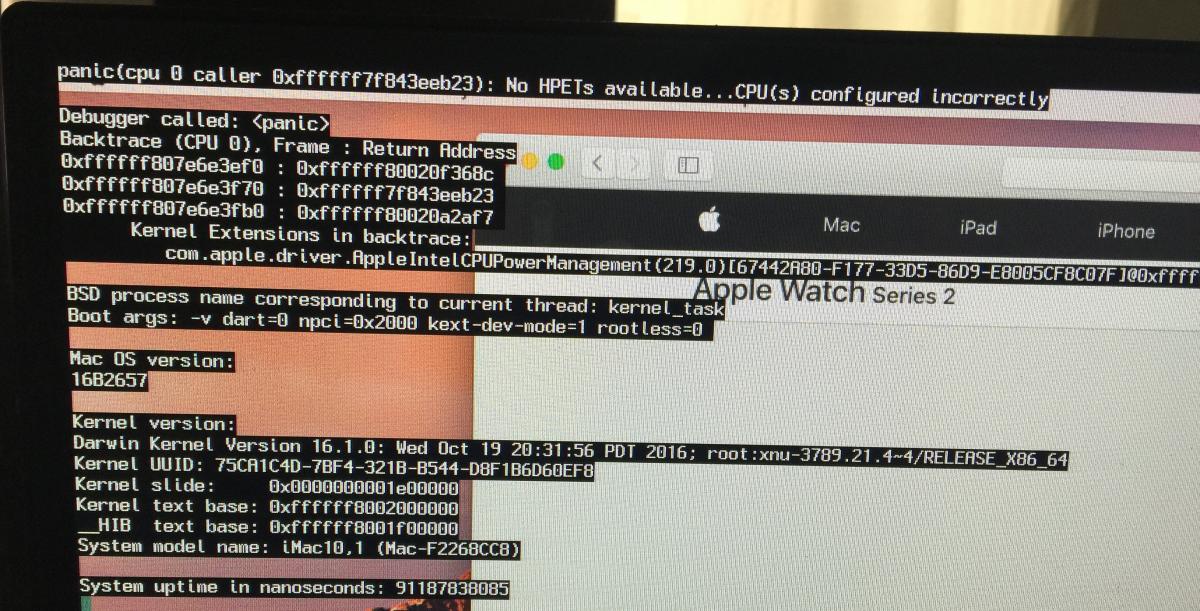

SLEV7N Posted March 16, 2017 Share Posted March 16, 2017 Ill check it with new ioreg Lan RealtekRTL8100.kext.zip kext by Mieze front or rear usb loose? Use it for usb problemDSDT.USB.zip front and rear, il try and report back edit: ethernet worked but i get kernel panic from appleintelcpupowerm... , shoul i put back nullcpupo...kext? i will try with the new dsdt atached before puting back nullcpupo...kext new usb dsdt works with usb but no audio, still get kernel panic from intelcpupower... im putting back nullcpupower management kext with the dsdt's where i loose usb i see in verbose that sound assertion happens but no usb on login Link to comment Share on other sites More sharing options...

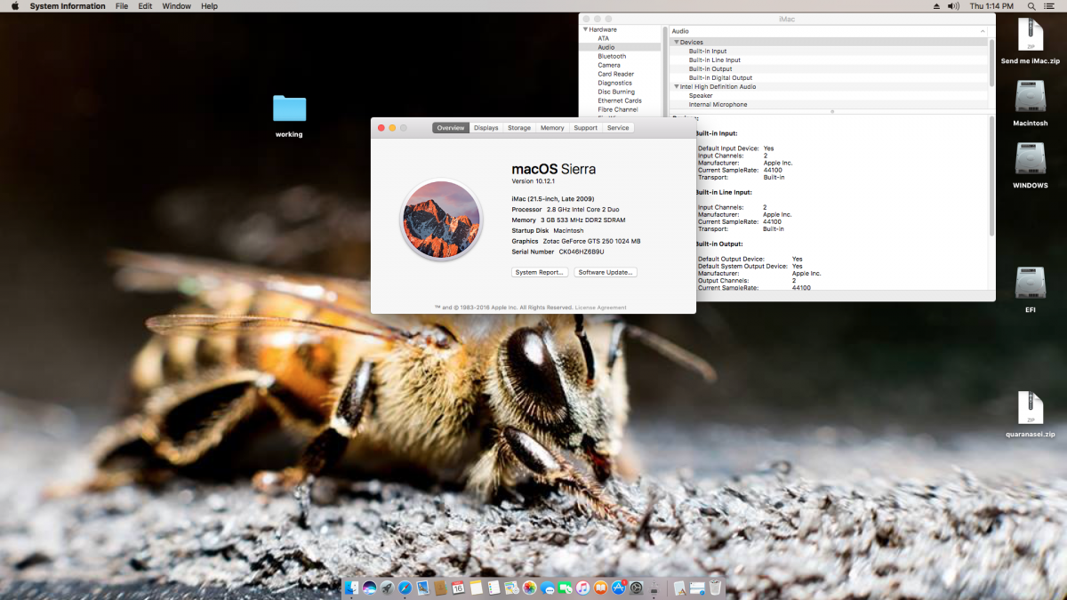

SLEV7N Posted March 16, 2017 Share Posted March 16, 2017 so whats working so far ethernet , graphics, usb not working , powermanagement(don't really care ) , audio i've put back nullcpupowermanagement.kext back in kext folder here is my ioreg many thanks maldopo Edit : AUDIOS IS WORKING! Send me iMac.zip quaranasei.zip 1 Link to comment Share on other sites More sharing options...
MaLd0n Posted March 16, 2017 Share Posted March 16, 2017 Good!!! same codec here, id 5 work Man, ur native PM is work remove NullCPUPowerManagement if u have a video lag, need edit AGPM Link to comment Share on other sites More sharing options...

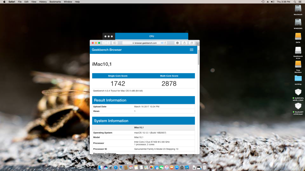

SLEV7N Posted March 16, 2017 Share Posted March 16, 2017 pretty much everything is working now, thanks a lot Maldon! I'm using the mackintosh as I type. here is a screenshot! ps: I hope you like the wallpaper Maldon! Good!!! same codec here, id 5 work Man, ur native PM is work MaLd0n 2017-03-16 às 17.09.28.png remove NullCPUPowerManagement if u have a video lag, need edit AGPM if I remove the nullcpupow...kext I get kernel panic from appleintelcpu....kext 1 Link to comment Share on other sites More sharing options...

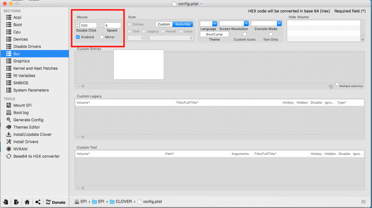

SLEV7N Posted March 16, 2017 Share Posted March 16, 2017 Activate USB keyboard and Mouse Support in bios Old gigabytes have this options, very suck. use it DSDT.aml.zip run it Olarila.command.zip send me last ioreg after reboot Use NullcpuPM at moment, we need a solution I have USB key/mouse enabled in the bios setting , I´ll try and report back thanks EDIT: alright ! usb are now working on clover, I don't know if it was your dsdt or this option in clover configurator (image) I attach the files from ioreg app and run me app, thank you maldon iMac.zipSend me iMac.zip I don't have graphics lag , I have some momentaneous lag in the system but I think is related to the hard disk or processor (while on load) , working pretty good in my opinion Link to comment Share on other sites More sharing options...

SLEV7N Posted March 16, 2017 Share Posted March 16, 2017 i put ssd 120 GB in my core2duo with 945 mobo...boom...it's fast last try for native pm replace DSDT, remove null DSDT.final.zip OK ill try and report back Edit: is a no go on the power management , kernel panic after boot, but I'm happy without it! thank you very much Maldo! thanks for the help and I hope it helps somebody else with the same board. Old hardware running Sierra FTW! Link to comment Share on other sites More sharing options...
