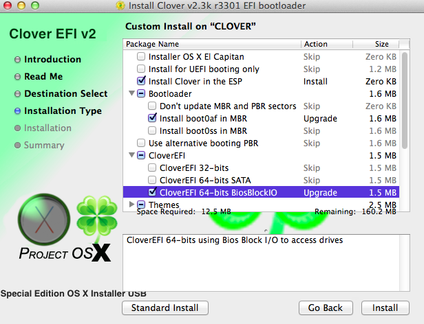

jgoens Posted October 24, 2015 Author Share Posted October 24, 2015 Did you try both boot0af and boot0ss? Screen Shot 2015-10-24 at 3.03.17 AM.png If yes, and it still doesn't work: Have you used that USB before for "other tool", and how did you format/erase your USB in Disk Utility? Choosing you usb name (partition you made) or whole drive (manufacturer name and model)? Screen Shot 2015-10-24 at 3.05.58 AM.pngScreen Shot 2015-10-24 at 3.06.11 AM.png It is possible that you have some leftovers from Chameleon/Chimera install from last time if you didn't format the whole drive (old boot files in EFI partition that is hidden in Disk Utility)... Edit: Or just to be sure, why wouldn't you format whole USB and then use Chris1111's installer to make bootable usb? http://www.insanelymac.com/forum/topic/307003-clover-os-x-el-capitan-usb/ I did not set any of those parameters. I did a usb erase with disk utility before I started using the install guide here--it is a new drive, but I had the tony's tools stuff on it--and did a format as master boot record. I followed the instructions exactly in the guide here. I have never used Chameleon/Chimera so that can be ruled out. I did not name anything as far as the Clover setup went. So, I guess I should remake the install drive with some of these parameters and see if that works? Unfortunately, I forgot my drive at home and the mac is here at work, so I will have to make a new one tomorrow and try the next day. The boot0af and ss are in the setup when making the bootable, I suppose. Maybe those might work. Thanks for the ideas..at this point I probably would have given up, as I have spent a couple hours now on just the installer part. As long as there are options to try I will keep working on it. I will try Chris's installer as well..at this point everything is worth a try--I think my issue has gone into more advanced troubleshooting. Quote Link to comment Share on other sites More sharing options...

fusion71au Posted October 25, 2015 Share Posted October 25, 2015 @jgoens, Maybe try the BiosBlockIO option instead of the standard Clover 64-bits SATA? When doing a legacy boot with Clover, the following chain happens (from Clover wiki)...BIOS>boot0(in MBR) > boot1(in PBR) >boot(CloverEFI) >CLOVERX64.efi(BootManager) >OSLoaderFrom what you are saying, it looks like you are reaching boot1 (hence message b1f) and boot (init5), but not CloverX64.efi (where you would see the message "Welcome to Clover version xxxx”), so my guess is that something is preventing boot (CloverEFI) from reaching CLOVERX64.efi (the actual boot manager and GUI screen).If you decide to upgrade your BIOS to UEFI, then you bypass this chain ieUEFI>CLOVERX64.efi(BootManager)>OSLoader Edit From the thread that @owbp linked above and posts from others who have had success in installing OSX on your motherboard, it seems like your best bet might be to update your BIOS to at least F12. I would recommend that you first try with F12 and Mavericks so you don't have to worry about how the beta U1l UEFI BIOS might affect your legacy Windows 7 installation. Should you later decide to upgrade to the beta UEFI BIOS and also install Yosemite or El Capitan, it is quite possible to upgrade legacy Windows to UEFI Windows without reinstalling from scratch- see post #359 in the AIO guides here. Maybe also post in that thread to get direct feedback from owners that have the same/similar hardware to yourself and the UEFI BIOS. Quote Link to comment Share on other sites More sharing options...
jgoens Posted October 26, 2015 Author Share Posted October 26, 2015 @jgoens, Maybe try the BiosBlockIO option instead of the standard Clover 64-bits SATA? BiosBlockIO option.png When doing a legacy boot with Clover, the following chain happens (from Clover wiki)... BIOS>boot0(in MBR) > boot1(in PBR) >boot(CloverEFI) >CLOVERX64.efi(BootManager) >OSLoader From what you are saying, it looks like you are reaching boot1 (hence message b1f) and boot (init5), but not CloverX64.efi (where you would see the message "Welcome to Clover version xxxx”), so my guess is that something is preventing boot (CloverEFI) from reaching CLOVERX64.efi (the actual boot manager and GUI screen). If you decide to upgrade your BIOS to UEFI, then you bypass this chain ie UEFI>CLOVERX64.efi(BootManager)>OSLoader PS One handy tip to make it much easier to access the EFI partition (so you can edit Clover’s config.plist and add remove kexts to inject) is to enable Disk Utility’s debug menu from terminal: defaults write com.apple.DiskUtility DUDebugMenuEnabled 1 The hidden partitions are shown after selecting "Show every partition" and the EFI partition can be mounted/unmounted by right clicking... Enable DU debug menu.png To disable the debug menu, retype the same command but change the 1 to 0. I will make a boot loader with the bioblock option and see if that works. Still wondering if the UEFI option is a good one or not--Anyone know how that will affect my windows 7 system. Also, tried to look into Kakewalk, not sure if that route will work. I tried the enoch boot loader a minute ago and it failed to install. I installed the El Capitan installer as per the tutorial link here I have been using and then opened the enoch 2779 pkg..but got a fail after it tried to install. Seems like these boot installers fail often for me. Clover 3292 has worked. I am considering just going for the Mavericks/ Chameleon route as well..but that will have to wait till midweek as I'll have to figure the steps for that which appear different than El Capitan. Quote Link to comment Share on other sites More sharing options...

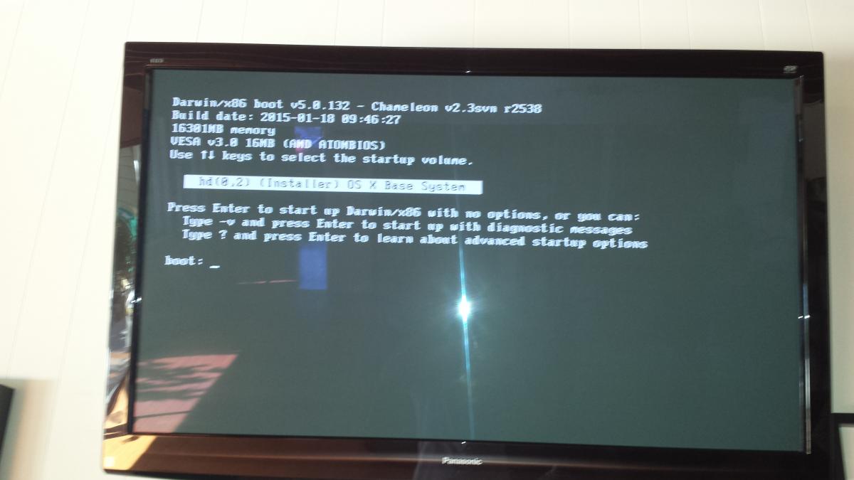

jgoens Posted October 29, 2015 Author Share Posted October 29, 2015 You're right, but (for fusion's guide) you could extract InstallESD.dmg image from OS X installer(s).app on your mac and then go crazy on Win! Also, BDUtility can be of great help to you troubleshooting your boot errors. In the end, it's up to you, but keep us posted! I just made 3 new USB's to try. 1 with the MyHack version. 2. An El Capitan version with Clover set at UEFI..just to see if anything happens. And the third I attempted that Mavericks link using Chameleon...I think I pulled a brain cell on that one;) Most likely I screwed that one up..but at least we'll see if anything happens. I will try them tomorrow afternoon. Quote Link to comment Share on other sites More sharing options...
jgoens Posted October 29, 2015 Author Share Posted October 29, 2015 You're right, but (for fusion's guide) you could extract InstallESD.dmg image from OS X installer(s).app on your mac and then go crazy on Win! Also, BDUtility can be of great help to you troubleshooting your boot errors. In the end, it's up to you, but keep us posted! You can try @cvad's BDUtility.exe to create a bootable Clover USB from Windows. From my experience, it is very reliable in making bootable USBs for booting OSX. You can even create a vanilla installer entirely from within Windows - see post#18. Good Luck! Ok, I got something. The Myhack installer gave a Boot0:GPT and Boot0:error. The UEFI installer did nothing. AND the usb I made with the Mavericks install link went into an installer screen with a bunch of verbose. Any ideas where to go from here? This is the first screen that comes up when I start the computer. I picked verbose and hit enter. I've tried using the cpus=1 for the boot flag and tried -x but the same result. I guess, this is a kernel panic? I also tried PCIrootuid=0 I'm just plugging in different flags hoping something works--seems like the CPU is not configured correctly, the bootcache control and bluetooth controller have issues as well. Figuring those with the knowledge here will know what to do. Tried unhooking graphics card and same result. Quote Link to comment Share on other sites More sharing options...
owbp Posted October 29, 2015 Share Posted October 29, 2015 Wow, great news, so Mavericks usb (Vanilla guide?) with Chameleon boots up! Finally some good news! What have you got in your Extra and Extra/Extensions folders except FakeSMC and org.chameleon.boot.plist? What other kexts and did you use any DSDT? Now ill do the next step with you until someone who knows your board shows up, Search your panic with your motherboard or OS X version (Mavericks in this case) and you'll find possible solutions. I know its a long shot but try adding to bootflags, GenerateCStates=Yes GeneratePStates=Yes and also boot in verbose (-v). Please, to help other members trying to help you, put your hardware specs in you signature so they always have it "right there". (Gigabyte GA Z68X-UD3H-B3, Intel I7 2700 CPU 3.5 ghz, Graphics AMD Radeon 6800) Quote Link to comment Share on other sites More sharing options...

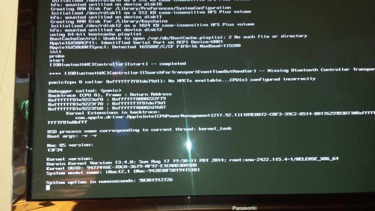

jgoens Posted October 29, 2015 Author Share Posted October 29, 2015 My research indicates the Bluetooth enabler transport has to do with graphics. I have tried "graphics enabler=yes." Guess I could go into the kext file on USB and delete some files? I keep adding to this post as I try other things, so that when you guys look at it you can rule out options. Wow, great news, so Mavericks usb (Vanilla guide?) with Chameleon boots up! Finally some good news! What have you got in your Extra and Extra/Extensions folders except FakeSMC and org.chameleon.boot.plist? What other kexts and did you use any DSDT? Now ill do the next step with you until someone who knows your board shows up, Search your panic with your motherboard or OS X version (Mavericks in this case) and you'll find possible solutions. I know its a long shot but try adding to bootflags, GenerateCStates=Yes GeneratePStates=Yes and also boot in verbose (-v). Please, to help other members trying to help you, put your hardware specs in you signature so they always have it "right there". (Gigabyte GA Z68X-UD3H-B3, Intel I7 2700 CPU 3.5 ghz, Graphics AMD Radeon 6800) tried that..still the same..Apparently graphic configurations are difficult. Quote Link to comment Share on other sites More sharing options...
