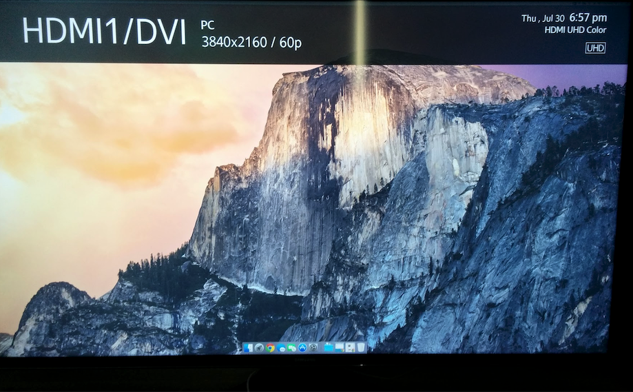

fokkerlit Posted August 6, 2015 Share Posted August 6, 2015 Plugged HDMI cable into video card and HDMI 1 on TV. Set Source type to "PC", went into settings and turned on UHD color for HDMI 1. Installed web drivers. Reboot, used "nvda_drv=1" Installed SwitchResX. Downloaded https://github.com/floris497/mac-pixel-clock-patch/ Ran the patch and rebooted. Opened SwitchResX and selected "3840x2160, 60Hz (NTSC)" Prior to applying the patch only resolutions with a pixel clock of 297 Mhz and less were available, now resolutions with a pixel clock up to 594 MHz are available (4k@60Hz). System: OSX Yosemite 10.10.4 Nvidia Web Drivers 346.02.02f03 SwitchResX 4.5.1 Samsung UN40JU6500F GearIT High-Speed 2.0 HDMI Cable EVGA GeForce GTX 970 FTW+ ACX 2.0 4GB Crucial Ballistix Sport XT 32GB Kit Samsung Electronics 840 Pro ASUS Micro ATX DDR3 2600 LGA 1150 Motherboards GRYPHON Z97 Intel Core i7-4790K IOGEAR Bluetooth 4.0 USB Micro Adapter 2 Link to comment Share on other sites More sharing options...

drlove Posted August 12, 2015 Share Posted August 12, 2015 Hi, I can confirm this method to be working! THANKS Regards, Marius 10.10.4 SMBIOS MacPro3,1 GTX980ti WebDriver-346.02.02f03 Philips BDM4065 4K monitor @ 60Hz @ Display Port :-) Link to comment Share on other sites More sharing options...
