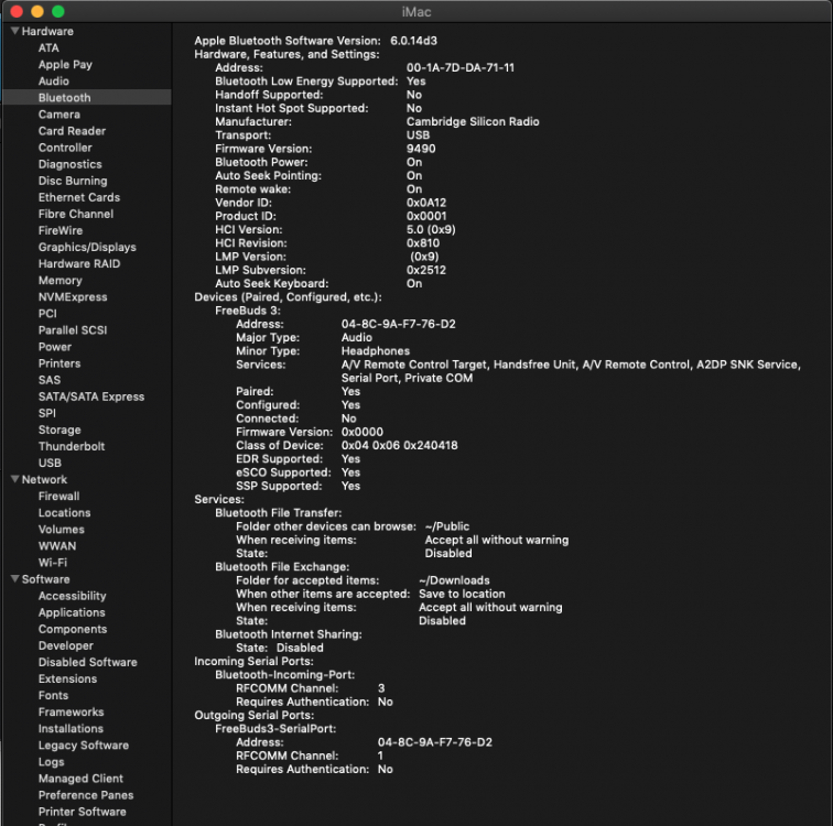

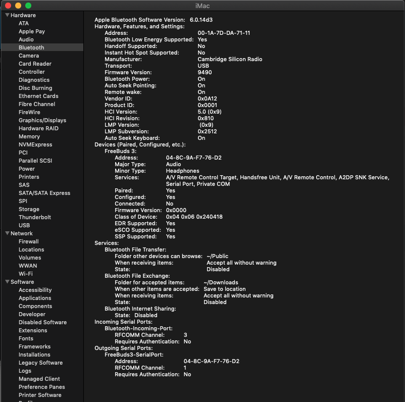

Hello,
Thanks for sharing, I have also tried this kext and the GenericCSRBluetooh.kext and the same thing happens to me with my dongle. I have tried with Sierra, High Sierra, Mojave and Catalina but I cannot make it work, with Windows it works. I would greatly appreciate the help provided.
