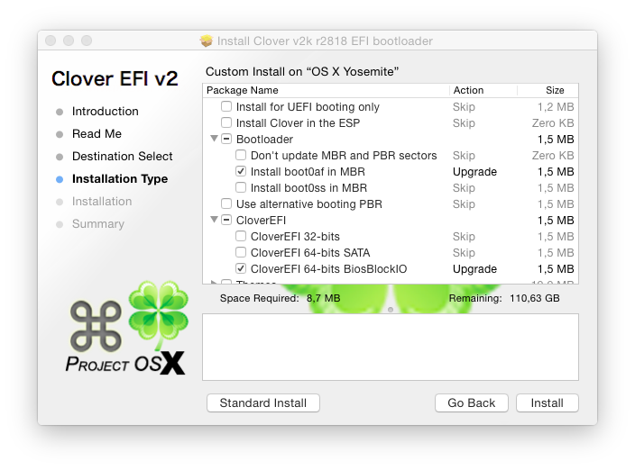

wern apfel Posted August 20, 2014 Share Posted August 20, 2014 Very quick guide Like described on the net restore the basesystem.dmg, packages... to your pen drive and install clover on it extract the attached file to clovers oem folder normally you can boot with this drive install yosemite after installation reboot from the pen drive and choose the drive where you installed yosemite, normally it starts install clover to that drive, copy the 0U695R folder from pen drive to clovers oem folder, your done you can improve this guide (not really a guide) ,if you want good luck Link to comment Share on other sites More sharing options...
krzysztofc10 Posted August 20, 2014 Author Share Posted August 20, 2014 Hmm to boot I must change in Clover Configurator Generate P&C States, kext dev mode = 1, Set Smbios in Config.plist to Macbook Pro 5,2. And the same result like always - Gui is working very slow. If I had copy kext and edit config in oem folder, system won't boot with Clover. I must edit in root Clover config.plist to run it Kexts droped to Kextutility.app and everything works except very slow GUI Link to comment Share on other sites More sharing options...

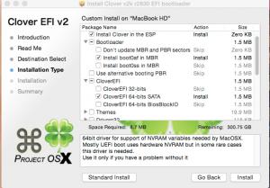

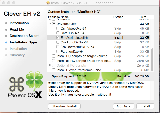

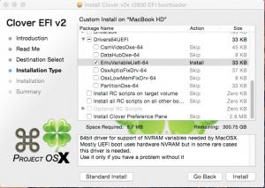

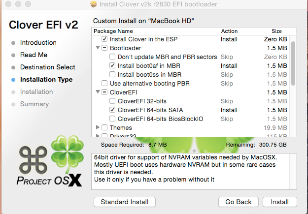

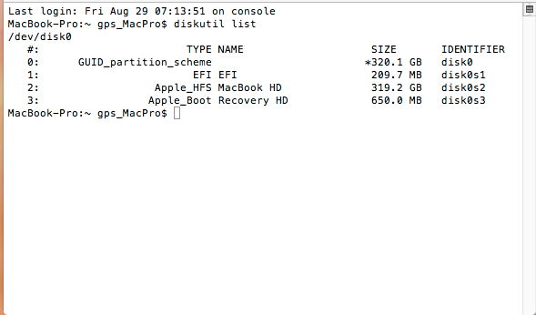

gpatpandp Posted August 29, 2014 Share Posted August 29, 2014 Since my initial post, here my basic original outline here has successfully booted every Yosemite release including the current Public Beta 2 release. Installing Clover in the "ESP" (legacy mode) is a simple as running the diskutil list command in Terminal to find out what the exact partition identifier name and number (ex: disk0s1) is of the default created Apple "EFI" partition once you have installed OS X 10.10 (shown in "Pic"). Then simply use the listed EFI partition identifier as shown in this following terminal command: sudo newfs_msdos -v EFI -F 32 /dev/rdisk0s1. Once terminal properly re-formats the EFI partition, download and install Clover in the "ESP" while checking all the boxes as shown in both Pic _1 & Pic_2. Create both a DSDT.aml and a SSDT.aml with DSDT Editor and place each in the "patched" folder of your Clover installation (Complete path: EFI Partition/EFI Folder/Clover Folder/ACPI Folder/patched folder). Then download and install the following listed kexts shown in Pic_4 and place them in your Clover install in the "other" folder (Complete path: EFI Partition/EFI Folder/Clover Folder/kexts folder/other folder). NOTE: A significant change since my initial post earlier in this thread is the addition/inclusion of the VoodooHDA.kext v.2.7.3 that was patched specifically for the IDT Audio Codec that exist as the Sound Card in my Latitude E6400. It has worked perfectly in every OS X 10.10 Yosemite version I have installed it in. Another significant edit to my initial post in this thread is a simple hardware part acquisition/installation that is so inexpensive and easy to perform given that once completed, you will have a natively/internally read Apple Airport WiFi card in your E6400 its a "no brainer". Simply go to the infamous auction site and pick up a WLAN PW934 DW 1510 WiFi Card and install it in your E6400 laptop and bingo...you now have a perfectly working native/read by OS X 10.10 as an official Apple AirPort WiFi Card. Enjoy your fully functional Dell Latitude E6400 Laptop running the very latest OS X 10.10 "Yosemite". 1 Link to comment Share on other sites More sharing options...

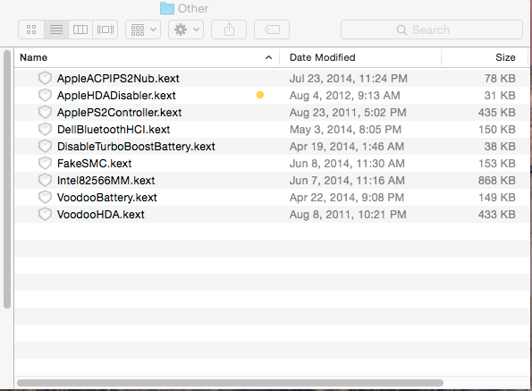

wern apfel Posted August 31, 2014 Share Posted August 31, 2014 What does the DisableTurboBoostBattery.kext ? Is there a sense to use it on a core2duo cpu? Link to comment Share on other sites More sharing options...
krzysztofc10 Posted August 31, 2014 Author Share Posted August 31, 2014 Herve tell me that this is only for INTEL I famili. I think to avoid KP. Link to comment Share on other sites More sharing options...

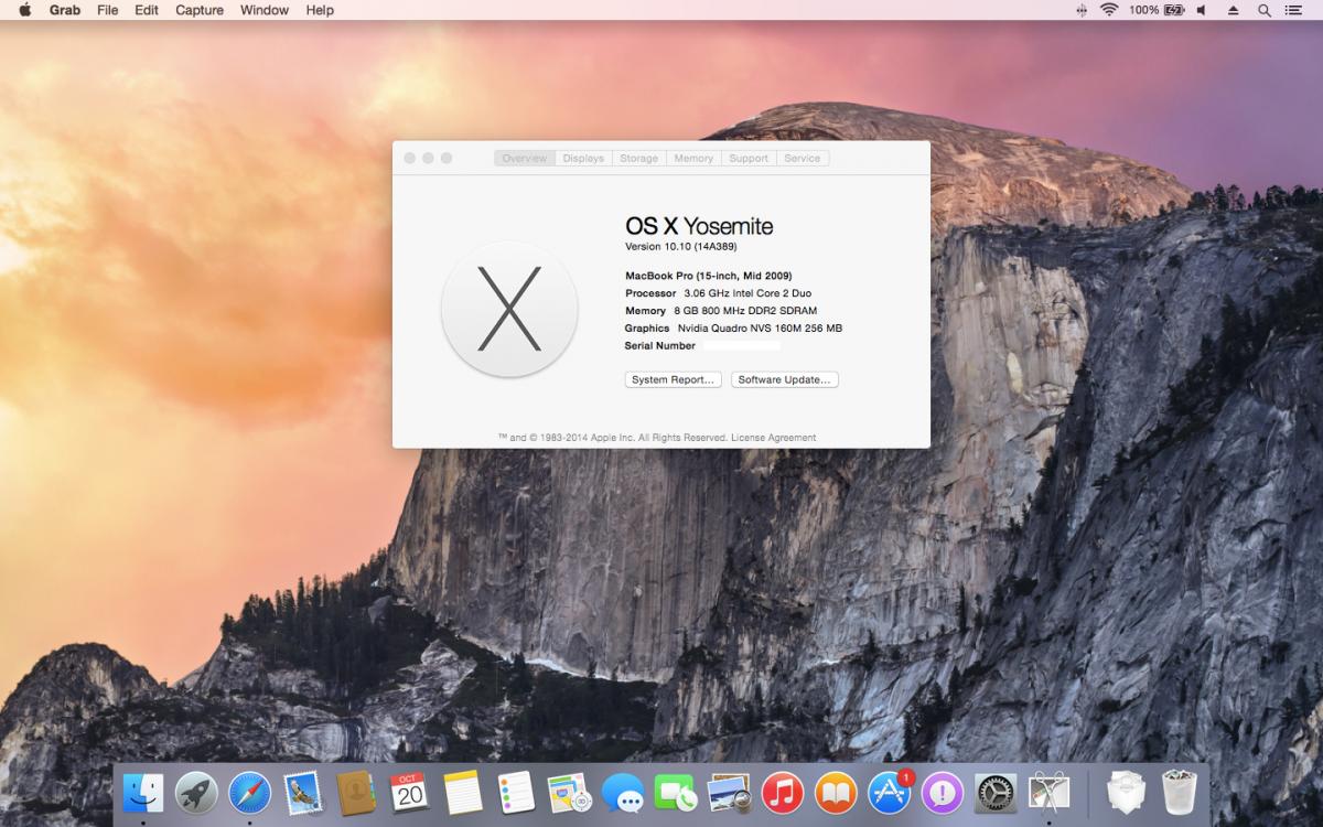

gpatpandp Posted October 20, 2014 Share Posted October 20, 2014 Just a follow-up to my post/instructions on the previous page(s) of this very same thread. Everything as I have explained/offered remains golden as far as the Dell Latitude E6400 and now OS X 10.10 Yosemite Final. Including a pic for all those so called expert "know it all - know nothing" advisors who ignorantly told me this would not even be possible when I originally had questions and sought help. Then when I figured it out myself, these same individuals continued to doubt me swearing I would NEVER make it to the final Yosemite version. Who is laughing now ? 1 Link to comment Share on other sites More sharing options...

gpatpandp Posted October 20, 2014 Share Posted October 20, 2014 Hi, I have 3 questions, but only 1. and 2. are for me important 1. What version of bootloader Clover you used? 2. How you patch VoodooHDA to properly working sound under yosemite? 3. Do you have CPU C2D T9900? Thank you. 1. Clover_v2k_r2953 2. Patched for the Audio: IDT 92HD71 Codec 3. Yes, 3.06 GHz Core 2 Duo T9900 CPU *Note: Neglected to mention another functional improvement since my last instructional post is the addition of the VoodooSDHC.kext patched by "slice" which enables the PCI Card Reader in the Dell Latitude E6400. VoodooHDA.kext.zip 2 Link to comment Share on other sites More sharing options...
howoarang Posted October 21, 2014 Share Posted October 21, 2014 1. Clover_v2k_r2953 2. Patched for the Audio: IDT 92HD71 Codec 3. Yes, 3.06 GHz Core 2 Duo T9900 CPU *Note: Neglected to mention another functional improvement since my last instructional post is the addition of the VoodooSDHC.kext patched by "slice" which enables the PCI Card Reader in the Dell Latitude E6400. REALY THANKS, VoodooHDA works in Yosemite. But I have other 2 problems released: 1. Laptop POWER BUTTON doesn't works (to shut down/sleep table) 2. Laptop can not POWER OFF after shut down. Display goes to black, bud LEDs of power still goes and also FANS still go. Link to comment Share on other sites More sharing options...
