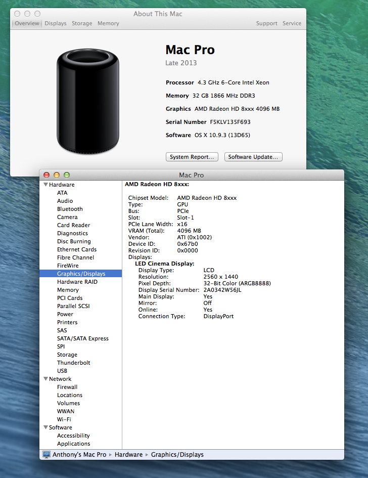

I have a gigabyte R9 290, Wardoctor would you be able to share the BIOS you used to make everything fully work? Was there any additional setup to do in Clover or was it just working straight away?
try the newest clover it no longer sees a 290x as a 7600m just inject ati but amd wont email me back about the bios i need and still waiting on sapphire i am about to just buy a firerpo w9100 and take the bios then return it but 10.10 is out today so let's hope for the best
The big question is if hardware acceleration works? QE/CI? It's one thing to show up in the system info, and another to have working acceleration :). Anyway, appreciate the effort, keep us posted.
these are 10.10 drivers they don't fully work on 10.9 but hopefully will in 10.10 we will find out tomorrow
I can confirm that it does detect it using those kexts. And it defaulted to the correct 2560x1440 resolution for my cinema display, but there is no QE/CI yet. This is a big step in the right direction though! If these drivers are in 10.10 beta, there's a chance they'll be in the 10.9.4 release :)

From what I've read only the 290x is recognized, you may have to inject device-ID's to get it to recognize the 290. But under Mavericks you will NOT have QE/CI yet with those kexts. It will show more properly and have the correct resolution, but no hardware acceleration.

I just had to register on here to let you guys know i¨ve been following this post since it was made in hopes of getting my r9 290x working, and i gotta give you some awesome credits WarDoctor, you really did some amazing work attempting to get it working in 10.9.x. i just hit 10.10 in on my hackintosh now, and i can confirm, i got hardware acceleration and frame buffer running like a baws.
I am currently running clover boot loader:
GraphichsEnabler=Yes
kext-dev-mode=1
and ran kextutility on my network driver and i¨m fully up and running. so far it seems stable except some minor details.
It seems the graphics driver for hawaii are sorta unstable, its unable to sync the picture on bouts until i plug out my DVI-cable on the GPU and put it in again.
And i¨m unable to run more the 1 monitor (I have 3 monitor¨s id like to have running).
Other then this i can inform i did a clean install and haven¨t tampered with anything other then fakeSMC.kext to get it to boot, iCloud, Appstore worked on first login without any tampering. so far it seems good. I just though id give you guys my thanks and report with confirmation that this actually works OOB in 10.10 DP1, just needs some tweaking on the driver part so that the syncing problem and multi monitor setup will work.
