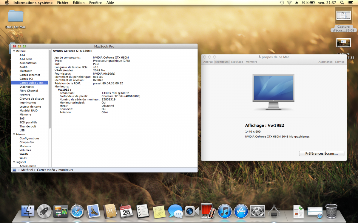

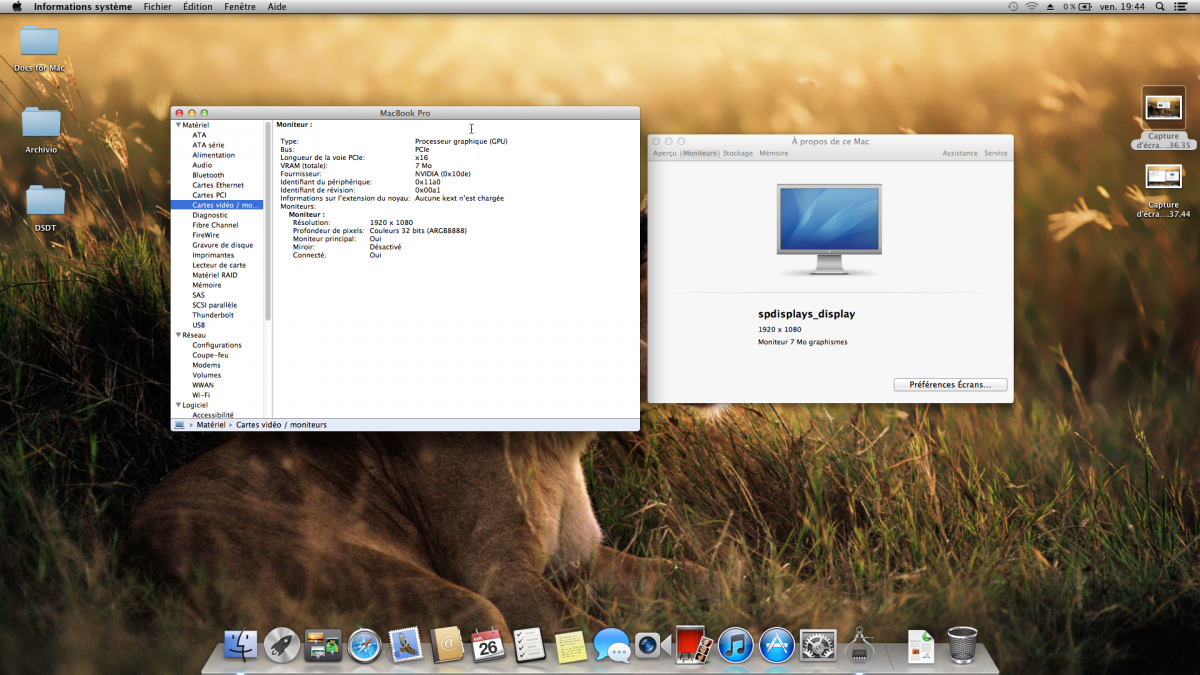

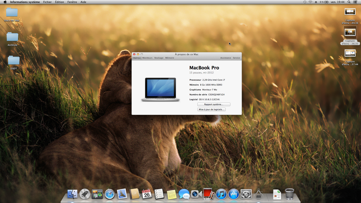

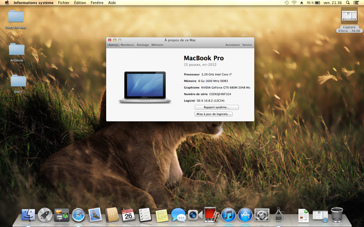

#19
Pahcixam
Pahcixam
    InsanelyMac Protégé
  • Members
  • Pip
  • 32 posts
Hi.
Here are 4 screenshots, 2 with nVidia kext loaded and an external monitor plugged in, and 2 more with /S/L/E/NVDA* moved to /KextOff for testing purpose and without external monitor because the integrated one is working.
As you can see my card is recognized and working with the external screen and there is no mention of intel graphics.
Sorry for french language on screenshots.
Thanks for helping.
