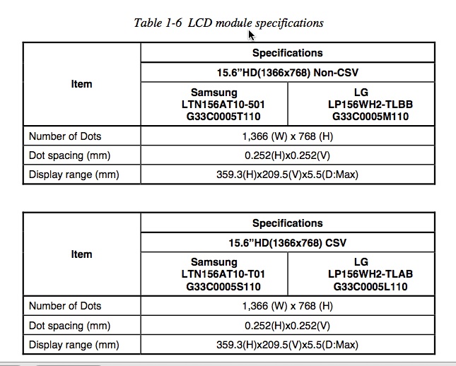

pentothal Posted March 21, 2013 Share Posted March 21, 2013 Hello all, I have one of these 4 LCD displays. If I find out which one I have and I find the EDID somewhere I have a chance to have a working FB. Cheers Pentothal Link to comment Share on other sites More sharing options...

pentothal Posted March 25, 2013 Share Posted March 25, 2013 From what I've seen, you used natit and both Intel HD Graphics kexts loaded right? However there is a screenshot where it says no display. That is not a good sign... Yes, I used Natit and both Intel HD Graphics loaded. Hmmmm bad news. I've found out something strange in the registry. My panel is identified as AppleDisplay (usually this is the name for external displays) and not as AppleBacklightDisplay as it should be. Any ideas? Regards Pentothal Link to comment Share on other sites More sharing options...
