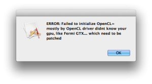

The problem is, i'm only getting the two cards to work together in safe mode. When i try to boot normally (with Clover, r. 9xx), the computer goes all the booting process, just to automatically reboot at the very point the desktop should appear. I'm hoping to make this setup work, because my 9800 GT doesn't have a working HDMI under OSX, which the HD4000 has.
I'll try later with Chameleon and will surely post here.
Best regards!

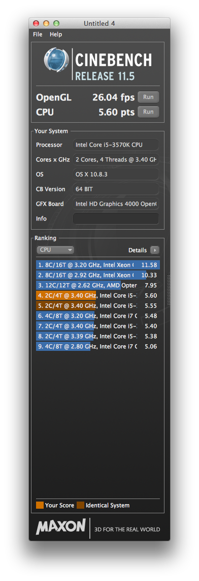

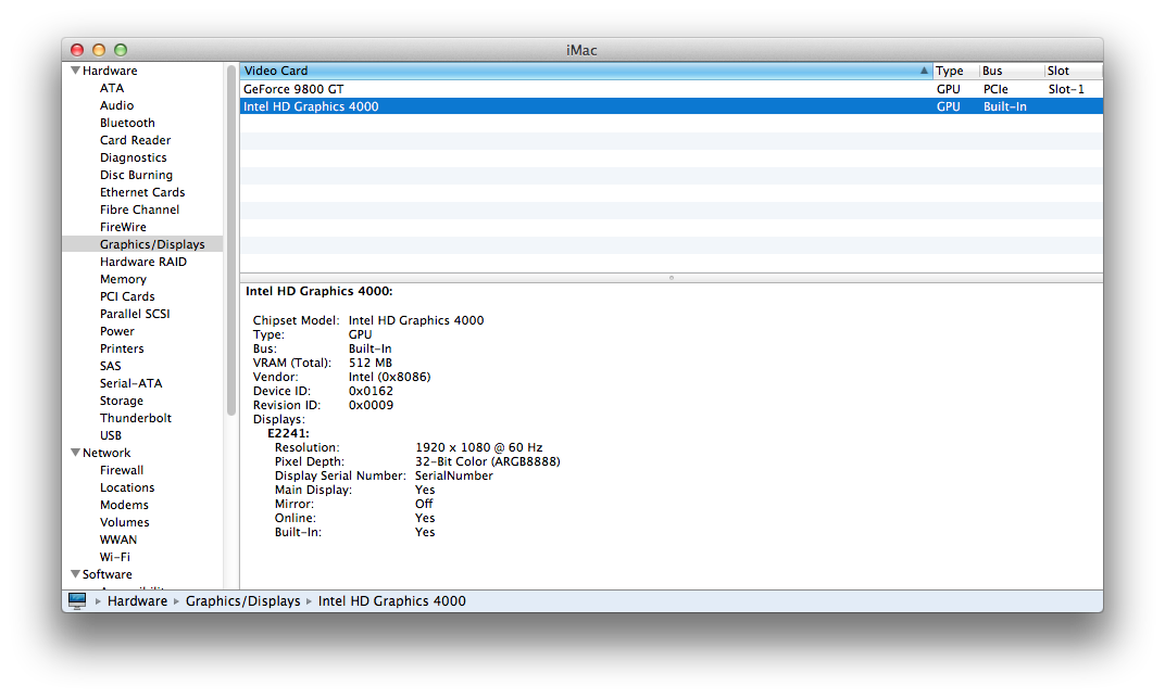

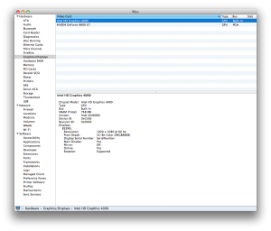

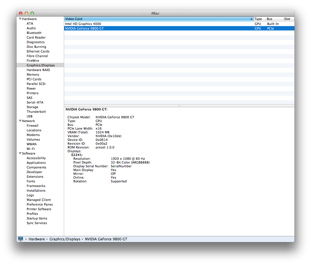

EDIT: a couple of pics to show the status of my setup now. Repair the opacity of the menu bar: in safe mode, there's no QE/CI.

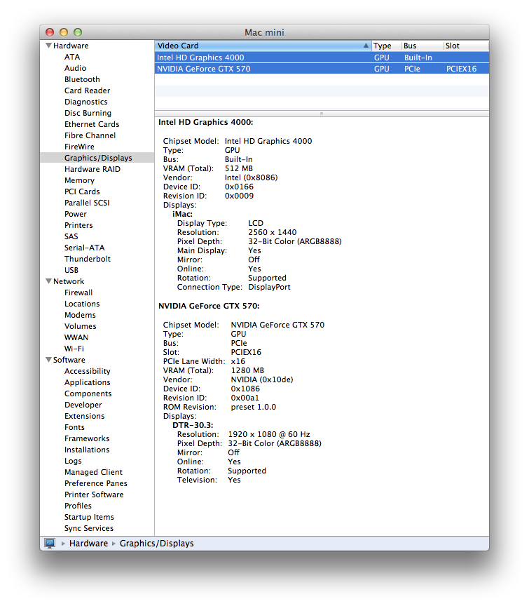

HD4000/GTX 570 HD working at the same time, Clover and Chameleon, GE=No, AirPlay Mirroring, 10.8.2. OSX does not switch workload automatically across graphics cards. However, you can launch the application on the graphics card you want the app to run on. The 570 is recognized without dsdt injection. To enable HD4000, add HD4000 dsdt injection to GFX0:
	 Device (GFX0)
	 Name (_ADR, 0x00020000)
		 Store (Package (0x04)
				 "device-id",
				 Buffer (0x04)
					 0x66, 0x01, 0x00, 0x00
				 "AAPL,ig-platform-id",
				 Buffer (0x04)
					 0x0A, 0x00, 0x66, 0x01
			 }, Local0)
		 Return (Local0)

UPDATE:
Patched my DSDT using the code you provided, Toleda: DSDT.aml.zip

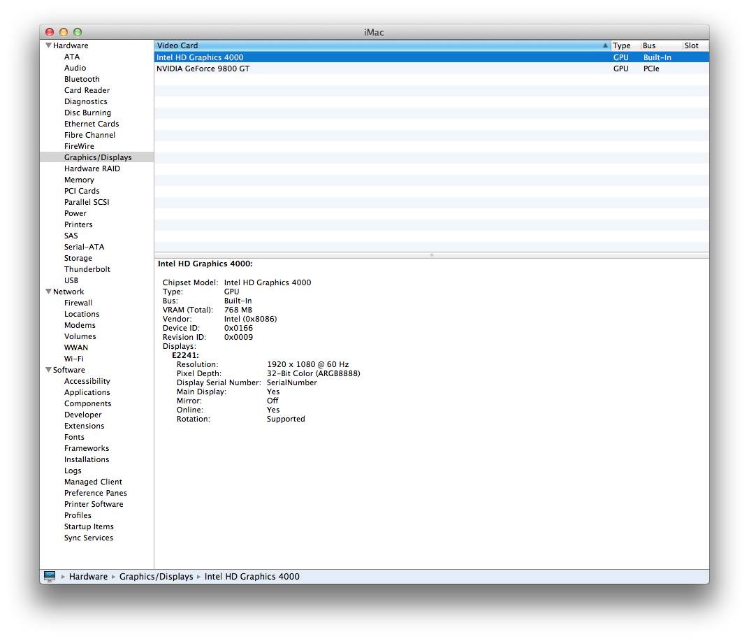

Apparently, it worked, since i managed to get to the desktop, and both cards are detected under Graphics/Displays: Screen Shot 2013-02-19 at 2.53.02 AM.png

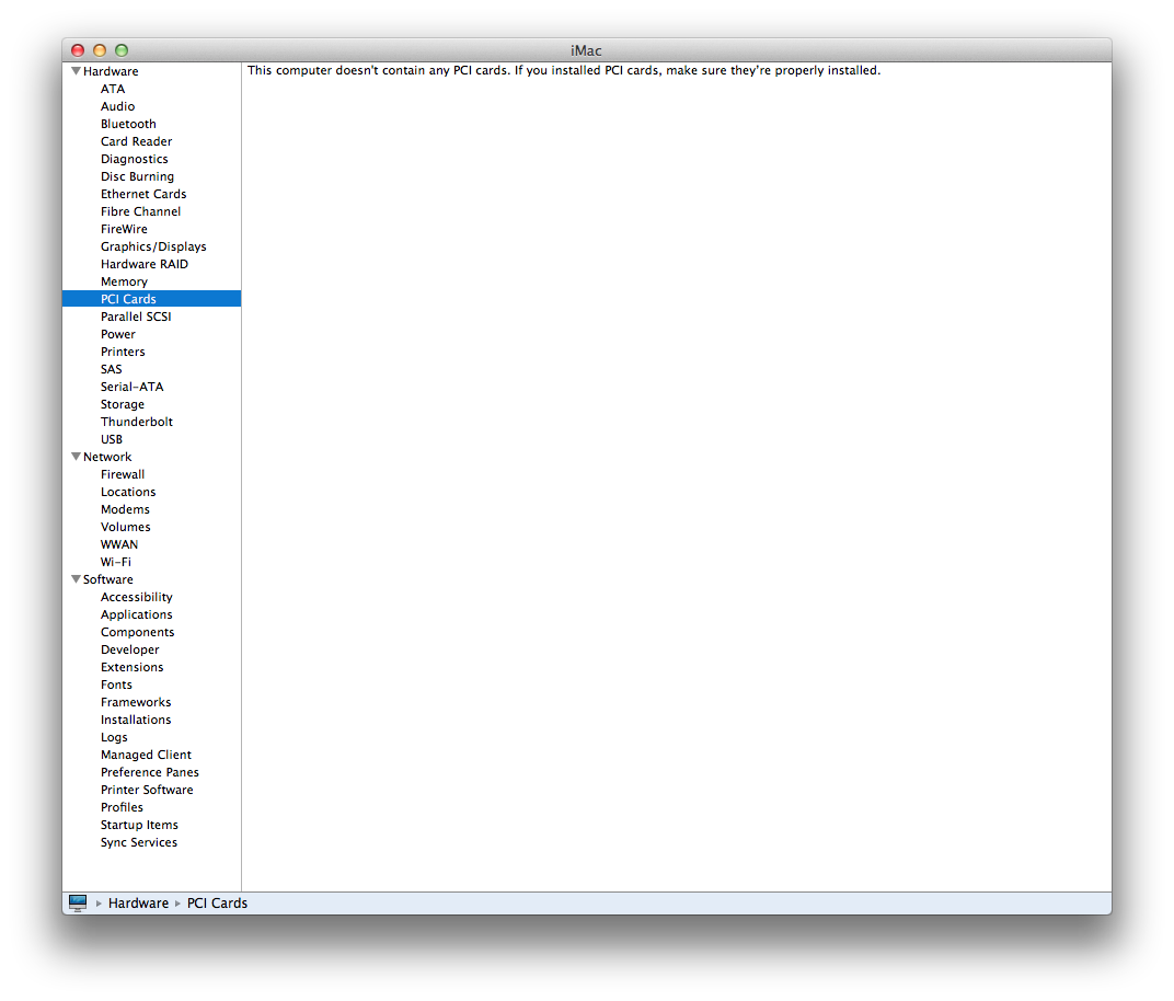

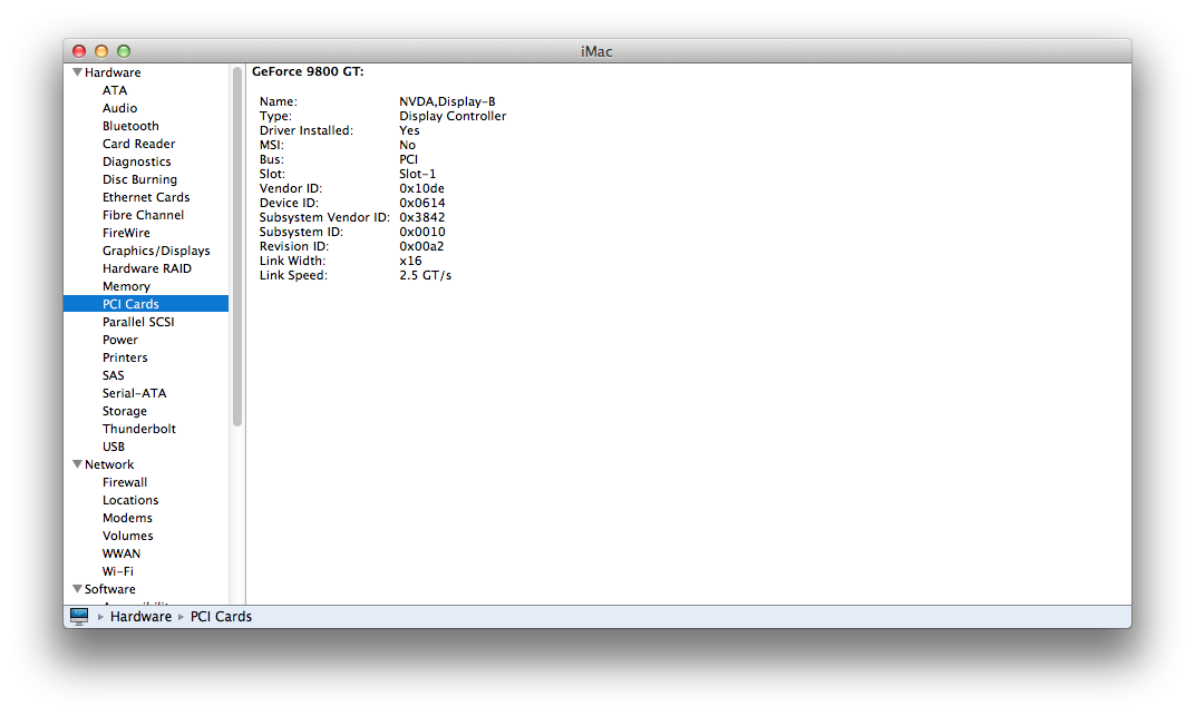

But under PCI Cards, the 9800 GT does not show up (it should, right?): Screen Shot 2013-02-19 at 2.53.23 AM.png
How do i know if it's actually being detected without using a secondary monitor, which i don't have? That was a rather inept question: i just needed to plug my only monitor to the DVI out of my 9800 GT. It was immediately recognized: Screen Shot 2013-02-19 at 3.08.34 AM.png

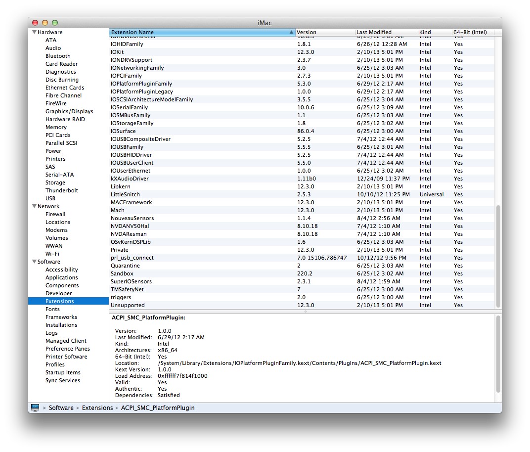

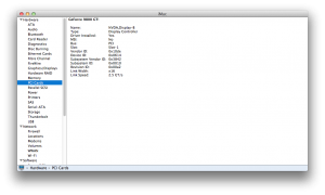

It seems to be really working, since NVDANV50Hal.kext is loaded: Screen Shot 2013-02-19 at 3.12.04 AM.png
But is this info really enough to say it for sure?

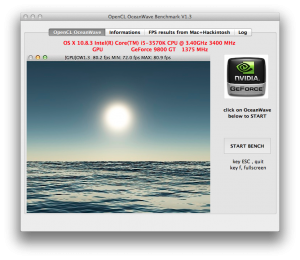

Well, this made me a bit worried: Screen Shot 2013-02-19 at 3.15.38 AM.png Screen Shot 2013-02-19 at 3.15.48 AM.png
But then: Screen Shot 2013-02-19 at 3.30.45 AM.png

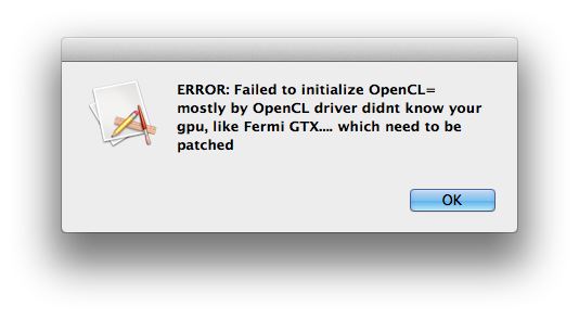

More questions: how i choose with which card a given app will run? How can i do a OpenCL/OpenGL bench test with each of the cards? Done.
Thank you very much indeed. To both of you guys! You are the best, seriously! :)
Did you ever try to get this setup of yours to work with Clover UEFI boot?

To show in PCI Cards, make this dsdt edit (assumes native z77-ud3h dsdt)
	 Device (PEG0)
		 Name (_ADR, 0x00010000)
		 Device (PEGP)
			 Name (_ADR, Zero)
			 Name (_SUN, One)
Launch the app in the display connected to the graphics system you want to use.
Thank you for this new patch, Toleda: worked like a charm (my board is a H77-DS3H)!

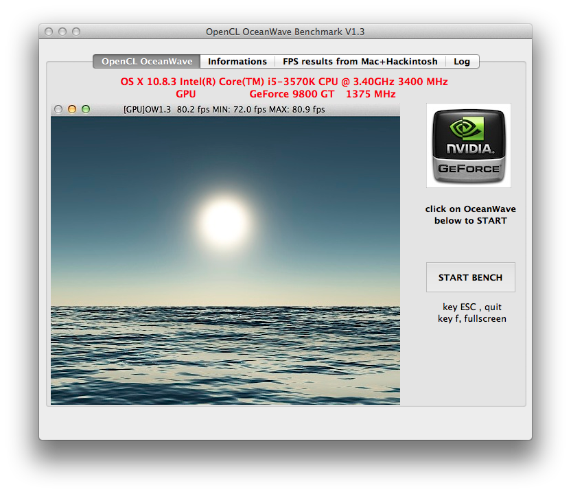

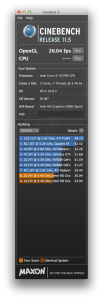

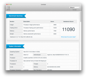

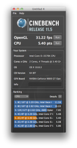

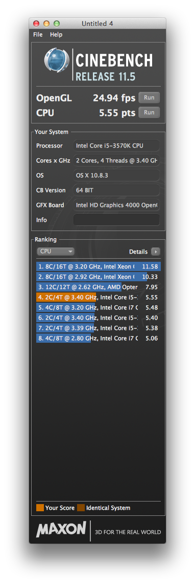

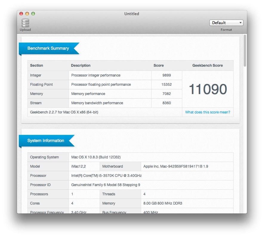

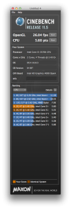

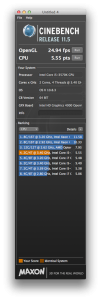

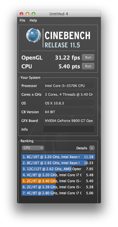

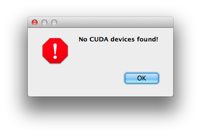

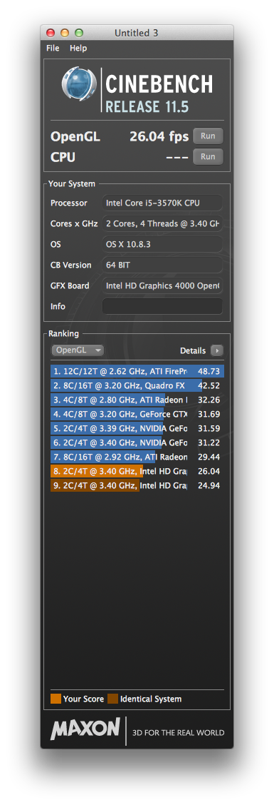

UPDATE: Clover UEFI boot brings further improvements both in graphics and CPU performance (confirming what Toleda said, despite i'm yet to run Geekbench EDIT: ran it, and the results are consistent with what i was already seeing, even a hundred of points lower, so i have two discrepant results - the third screenshot bellow), as you can see. The results highlighted in orange were obtained after booting from UEFI (brown for BIOS boot):
My results with the 9800GT are also there (the higher is already with Clover BIOS boot, the other was with Chameleon and using only the 9800GT in the setup).
Notice that, despite graphics performance still not being in the same league as what i get with the monitor connected to the 9800GT, the accentuated performance gain i have with the HD4000, specially with UEFI (i'm yet to test the 9800GT with UEFI, but the results should be consistent with that) more that compensate for it (if you believe more in Cinebench than in Geekbench, like i do), so i think i'll let the nVidia 9800GT to applications that rely heavily in OpenGL/CL computing, doing all other work with the HD4000.
Best regards!

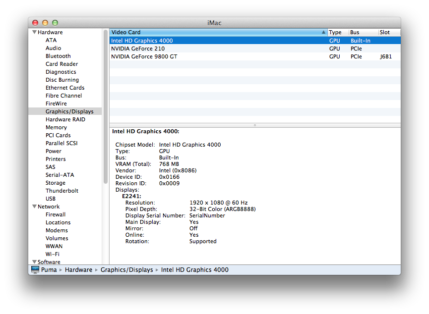

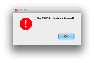

By the way, now i'm trying to set up a three card configuration, with the Intel HD4000 as the primary, the 9800GT in the 16x PCI-e slot, and the GeForce G210 in the secondary PCI-e slot (4x). It appears that the system recognize all the three cards:
But when i try connecting any monitor to any of the three ports of the G210 (which is a card which rather works OOB when it's running alone), i get a black screen (standby mode). Do you guys know about a possible solution for this? In my DSDT, i injected - following the steps recommended here in the topic by Toleda - only the HD4000, the PCI-e (otherwise the 9800GT would work but wouldn't appear in System Report) and HDMI audio fix.
All the best!
Driver-IST needs to be injected with the DSDT injection for that card. Boot with it alone and get a IOreg and that is were you get the info. No more black screen. This is a hardcore fix and is hard to find info on but it does work as I must use it in my Testing rig when I use Nvidia.
