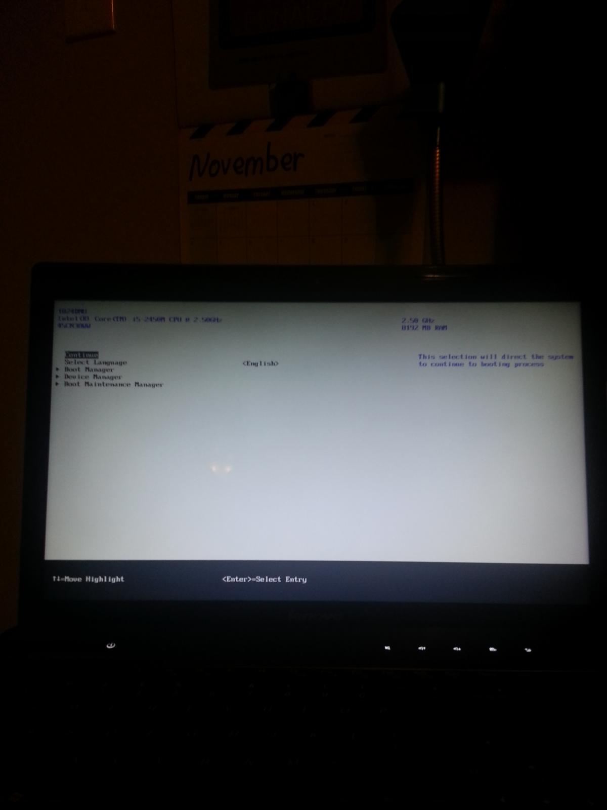

I have an idea, once my laptop finishes its battery calibration cycle, I will try the old EmuVarRuntime (the one that BSOD'd Windows) to see if shutdown works on that version. It's strange though, Clover will not shutdown. (just to clarify, the Clover bootloader itself will not shutdown, which I think is my problem for OS X)
EDIT: I think I found something. When I use my Clover USB (this has NO EmuVariableUefi installed), selecting shutdown sends me to a screen that says "boot0:" and then Clover (from USB) shows up again. If I select shut down a second time, I get a screen that looks like this:
Attached File  20121202_185416.jpg   59.2KB   64 downloads

@Fred30w
Looks like DUET, or in Clover's case rEFIt. Strange you can get there,

@Fred30w
Strange thing is, with EmuVarUEFI, using shut down hangs. Without EmuVarUEFI, the first time I use shutdown, I am sent back to Clover boot menu. The second time, that menu appears.

Well, I'll try to explain ...
Shutdown from Clover does not do shutdown, but actually just exits Clover application. This means that control returns back to UEFI firmware.
It works like this:
- you select to boot from USB stick
- firmware detects /efi/boot/bootx64.efi (Clover) on the stick and does UEFI boot - starts Clover in UEFI mode and you get Clover GUI
- you select shutdown in Clover, but that just returns back to firmware
- firmware then continues by trying next boot option. and that is USB key again, but in BIOS mode
- since you have BIOS bootable USB key (boot0, boot1h2, boot = CloverEFI), firmware starts BIOS booted Clover (standard Clover boot) and you see boot0 message
- but this BIOS booted Clover installs it's own version of UEFI on top of BIOS - we call it CloverEFI, UEFI based on tianocore Duet
- CloverEFI starts /efi/boot/cloverx64.efi and you get GUI again
- when you select shutdown from this, Cloverx64.efi exits, and control is returned back to CloverEFI firmware
- CloverEFI firmware presents you with boot manager that is on your screenshot
This does not help you much, but shows that you can boot standard BIOS Clover boot (CloverEFI) by just removing /efi/boot/bootx64.efi from USB stick and then booting from it. You may try that and see if shutdown works from there. To get UEFI boot back from USB stick, you just need to return /efi/boot/bootx64.efi.
Regarding shutdown from OSX: I'm not 100% sure, but I think that OSX does not use UEFI services for shutdown. I think that your shutdown issue is not related to Clover, but maybe caused by something in your DSDT. You are using the same DSDT as for Chameleon, right? But there is no guarantee that original DSDT for BIOS boot is the same as original DSDT for UEFI boot. They usually are, but ... Meaning: it's possible that you are injecting invalid DSDT when doing UEFI boot. Just my guess.
You can extract and compare BIOS ACPI tables and UEFI ACPI tables by:
1. do UEFI Clover boot (GUI start) from USB stick and press F4 - this will dump UEFI ACPI tables to /efi/acpi/origin. Move those tables to another place.
2. do BIOS Clover boot from USB stick (by removing /efi/boot/bootx64.efi) and press F4 to dump BIOS ACPI tables to /efi/acpi/origin.
3. compare UEFI and BIOS DSDT (and other ACPI tables) to see if there are any differences
4. if there are differences, then try to apply your DSDT fixes from your moded BIOS DSDT onto UEFI DSDT and try UEFI boot with that new one
