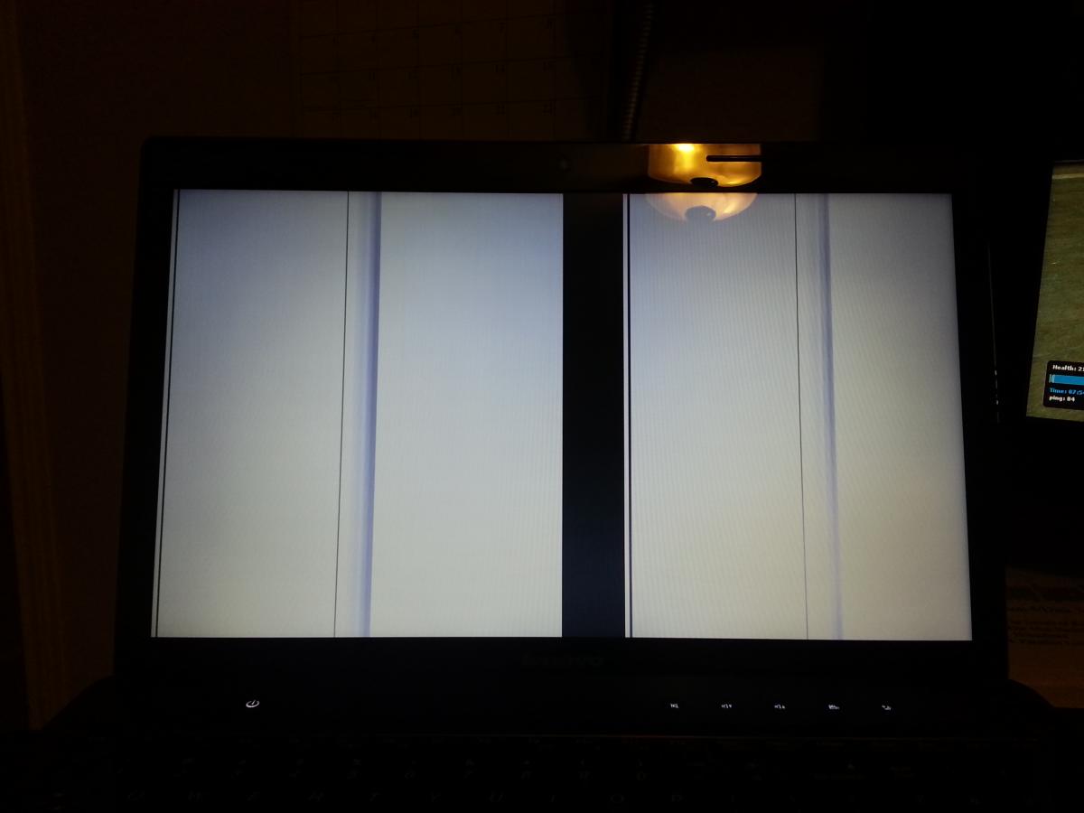

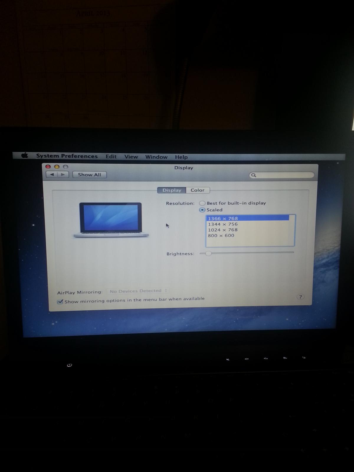

Fred30w Posted April 6, 2013 Author Share Posted April 6, 2013 (edited) Hi there! If you are still using Clover and EmuVariableUefi driver, please test new version. Details here: http://www.projectos...indpost&p=28411 Hello dmazar! I still do use Clover for OS X booting. Unfortunately, I get a weird screen after the Apple boot screen finishes when updating Clover and your new EmuVariableUefi driver. Here is a picture. I have reverted back to an older EmuVariableUefi driver and Clover r904 with shutdown hangs. Edited April 6, 2013 by Fred30w Link to comment https://www.insanelymac.com/forum/topic/284363-how-to-boot-os-x-mountain-lion-with-uefi-and-gpt-hdd/page/3/#findComment-1904246 Share on other sites More sharing options...
TimeWalker75a Posted April 6, 2013 Share Posted April 6, 2013 This is due to changes in DualLink injection for HD3000. I've reported this as of it first appeared but it seems its still there, so I'm now forced to disable graphics injector and set custom device-property strings. Link to comment https://www.insanelymac.com/forum/topic/284363-how-to-boot-os-x-mountain-lion-with-uefi-and-gpt-hdd/page/3/#findComment-1904274 Share on other sites More sharing options...
dmazar Posted April 6, 2013 Share Posted April 6, 2013 I really do now knot what changed since I did not have HD graphics before. I know that for ProBook I had to use GraphicsInjector=Yes and DualLink=0 in Graphics section to get screen working. And currently I am using DSDT graphics injection, since Clover does not inject hda-gfx=onboard-1 or something similar. 1 Link to comment https://www.insanelymac.com/forum/topic/284363-how-to-boot-os-x-mountain-lion-with-uefi-and-gpt-hdd/page/3/#findComment-1904324 Share on other sites More sharing options...
TimeWalker75a Posted April 6, 2013 Share Posted April 6, 2013 It used to inject AAPL00,DualLink=0x00000000 before the issue appeared, now it seems to inject AAPL01,DualLink with 0 by default or based on the value of the key set. devprop_add_value(device, "AAPL01,DualLink", (UINT8 *)&DualLink, 1); ... DualLink = gSettings.DualLink; In both of these cases the screen is split either in two or in 4 parts on some laptops. Now, because the device id is the same for most laptops there is no universal solution, so switch (gma_dev->device_id) doesn't really do justice here. Most laptops are fine with AAPL01 and if you'd have defined a special case in the switch for id of 0x0116 some people would end up complaining. Link to comment https://www.insanelymac.com/forum/topic/284363-how-to-boot-os-x-mountain-lion-with-uefi-and-gpt-hdd/page/3/#findComment-1904350 Share on other sites More sharing options...
Fred30w Posted April 25, 2013 Author Share Posted April 25, 2013 I really do now knot what changed since I did not have HD graphics before. I know that for ProBook I had to use GraphicsInjector=Yes and DualLink=0 in Graphics section to get screen working. And currently I am using DSDT graphics injection, since Clover does not inject hda-gfx=onboard-1 or something similar. Thx dmazar! Using DualLink = 0 got the screen working great! So far I like the new Clover and EmuVar, my laptop has a more reliable shutdown than ever (but not perfect). I do have a question though, has CsmVideoDxe-64 been fixed for Intel HD 3000? So far when I install that file, I get a blinking cursor at the top left. boot.log.zip Link to comment https://www.insanelymac.com/forum/topic/284363-how-to-boot-os-x-mountain-lion-with-uefi-and-gpt-hdd/page/3/#findComment-1910299 Share on other sites More sharing options...
