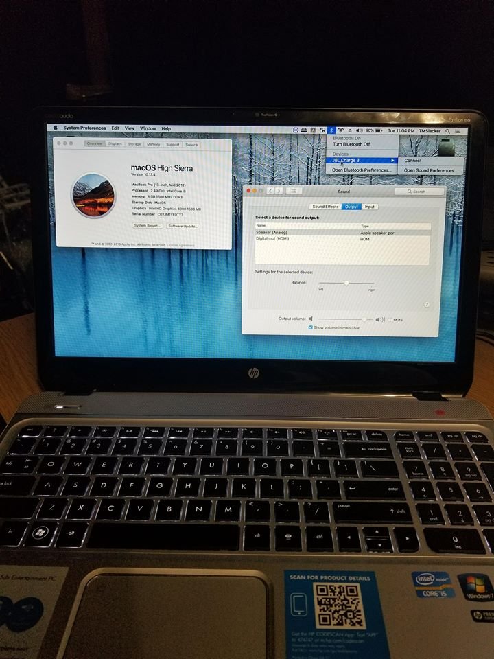

Oh you know what it probably is, our cards are slightly different I bet. Load up Ubuntu, open Terminal, type in LSPCI and copy the printout and paste it here, do the same with the readout of LSUSB.
I'm guessing the hardware IDs are slightly different, there are a few "versions" of this card, in general there are multiple versions of cards, but the kexts I used and uploaded were actually edited for my card's IDs. You might try the original set of kexts for WiFi, I believe it's on OSX86.net, Google a little bit it should be easy to find, but do that and try that out before going through all the Ubuntu stuff... Also, what about Bluetooth? Does that work in the Hackintosh? Keep in mind even though WiFi and Bluetooth are on the same AR5B195 card, WiFi operates on the PCI bus while Bluetooth uses the USB bus, at least on our laptop and probably all the similar HP laptops of 2012/2013 (so Bluetooth doesn't work after a sleep resume with the Hackintosh setup but WiFi does). I know I/we (eep357 has been helping a lot) had to edit the Bluetooth kexts, I think because of the USB bus thing, because the norm is for WiFi and Bluetooth to both run off of PCI, or at least that's how I understand it.
I assume you're probably pulling the vendor and hardware ids with that command. I have a Dell model, Dell 1702 I think.
Ven 168C DEV 002B Subsys 02051028
there was a revision but I didn't copy that down. Give me a second and I'll post what Ubuntu states.
M6-1045DX, bought a Dell 1702 because it's a AR5B195. Didn't realize that would be a big issue.
I downloaded a kext from osx86 for the AR5B195, added my 168c and 2b and restarted. Wifi works now! Thanks a lot for the help and suggestions. Time to start working on the other bugs.
My battery monitor isn't working. I tried a couple kext's from google/osx86 and now I'm getting a KP stating I'm missing 2 files. I formatted my myHack flash drive for data transfers and don't have a mac nearby to create a new one. Is there any other repair methods? I have a .iso of ML, official disc of Snow Leopard, i_boot for 10.6 and i_boot for 10.8.
I had to remake the myHack USB a few times... I have a few laptop hard drives and a few flash drives, so at one time I had a secondary hard drive with Windows and Mac OS X in a VM on it and two myHack USB drives. Without a Mac to use, you need a VM of OS X, and that can be done with Ubuntu or Windows.
