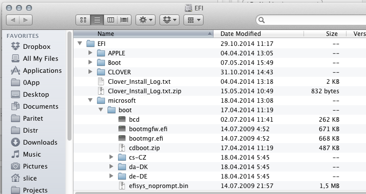

9) Now you have to make visible the hidden EFI partition with this Terminal command :
mkdir /Volumes/efi
sudo mount -t msdos /dev/diskXs1 /Volumes/efi ( diskXs1 is your identifier , so write instead of your )
10) Now in your desktop t here will be a disk called EFI , and in this copy your efi folder from your pen drive ... previously performed with clover
Note this procedure with terminal have to do with the other efi disk hidden .

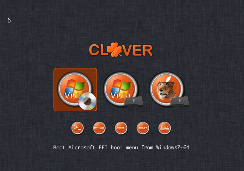

Ok , now restart pc and boot again with pen drive

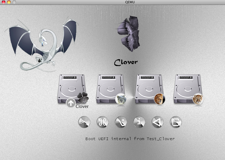

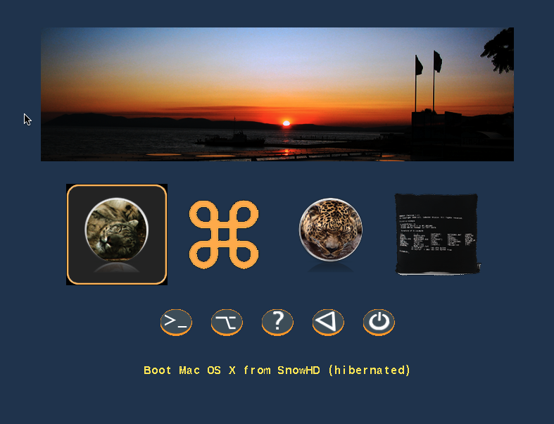

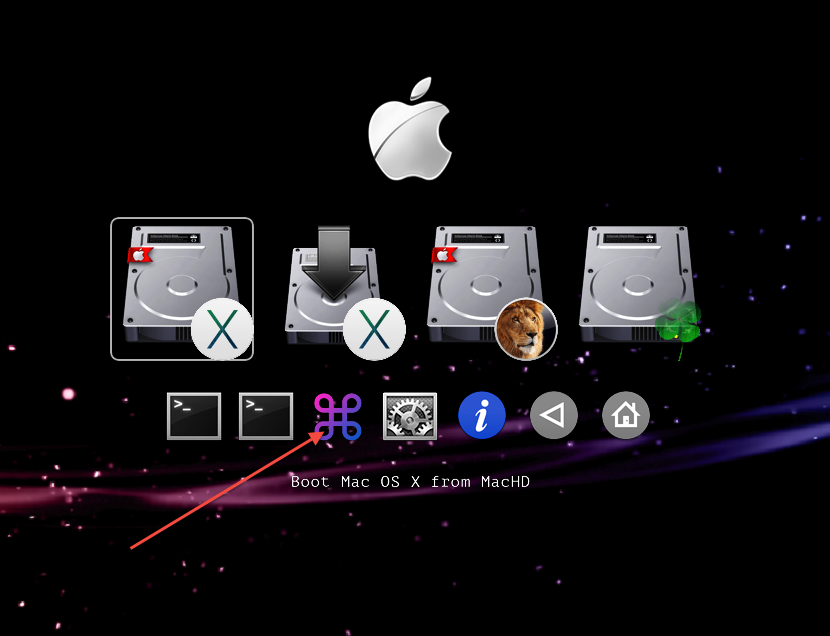

In gui clover there is a option :
Select with keyboard
And Add this

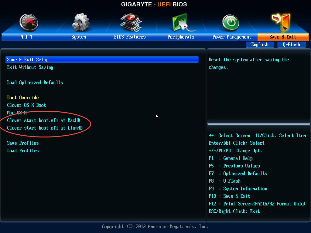

Now restart pc and enter in your bios , and select First boot Clover osx

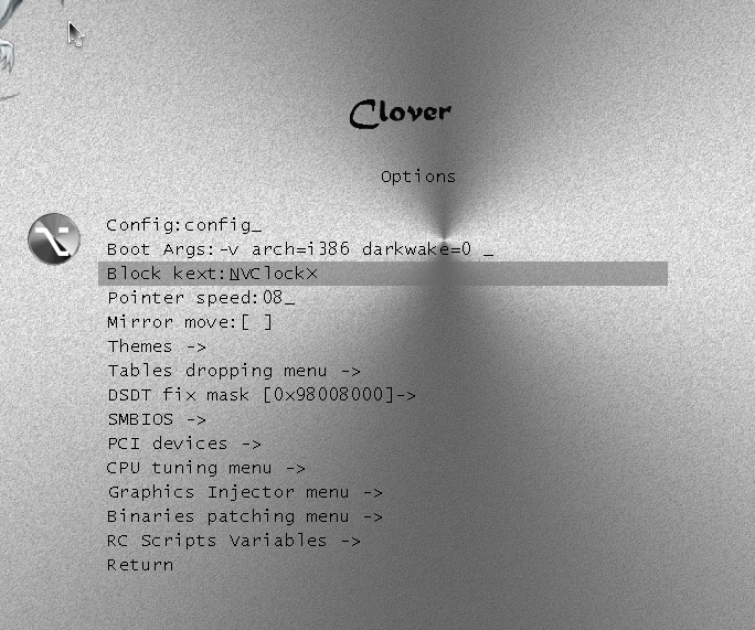

boot-args - -v (verbose mode) -x (safe mode) npci=0x2000 (PCI Configuration Fix) darkwake=0 (for setting the "Deep sleep" mode in Lion/ML) slide=0 (Only needed for ML): Sets boot-flags to be used for booting OS X. Not all flags may be needed: e.g. safe mode

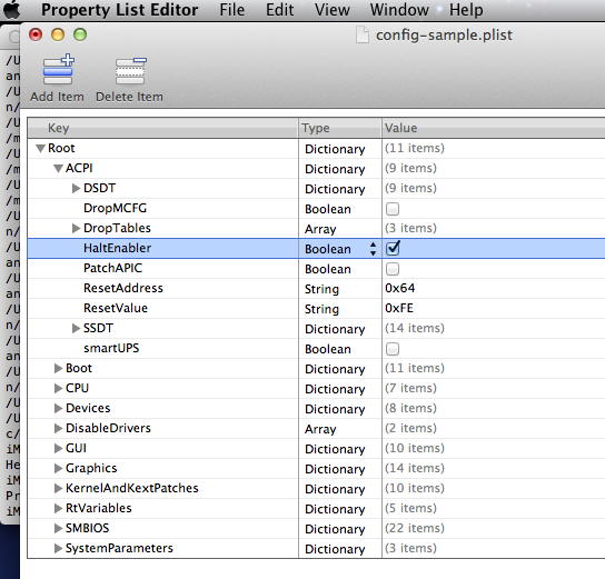

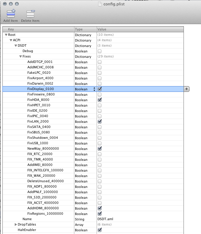

ACPI
See information from here, here and here to set the correct ACPI-settings.
DsdtName - Filename to be used for a generated DSDT-file or set to BIOS.aml if Clover needs to generate one for you. (See FixDsdtMask)
DropOemSSDT - (Yes/No, default: No): DropOemSSDT should only be used if you are injecting a patched SSDT or if you enabled GenerateCStates/GeneratePStates.
I recommend to generate a last SSDT-7/SSDT-8.aml file with freq/power-values that matches the system's CPU. Place it in the /ACPI/Patched folder to solve the hanging CPU-freq issue. A way to generate this file, is by using Revogirl's ssdtPRGen.sh. To terminate the last SSDT-number, dump to origin tables in Clover with the F4-key.
DropDMAR - (Yes/No, default: No): Needs to be enabled to fix the AppleACPIPlatform.kext boot problem in 10.8.2.
DropBGRT - See post from =)(=

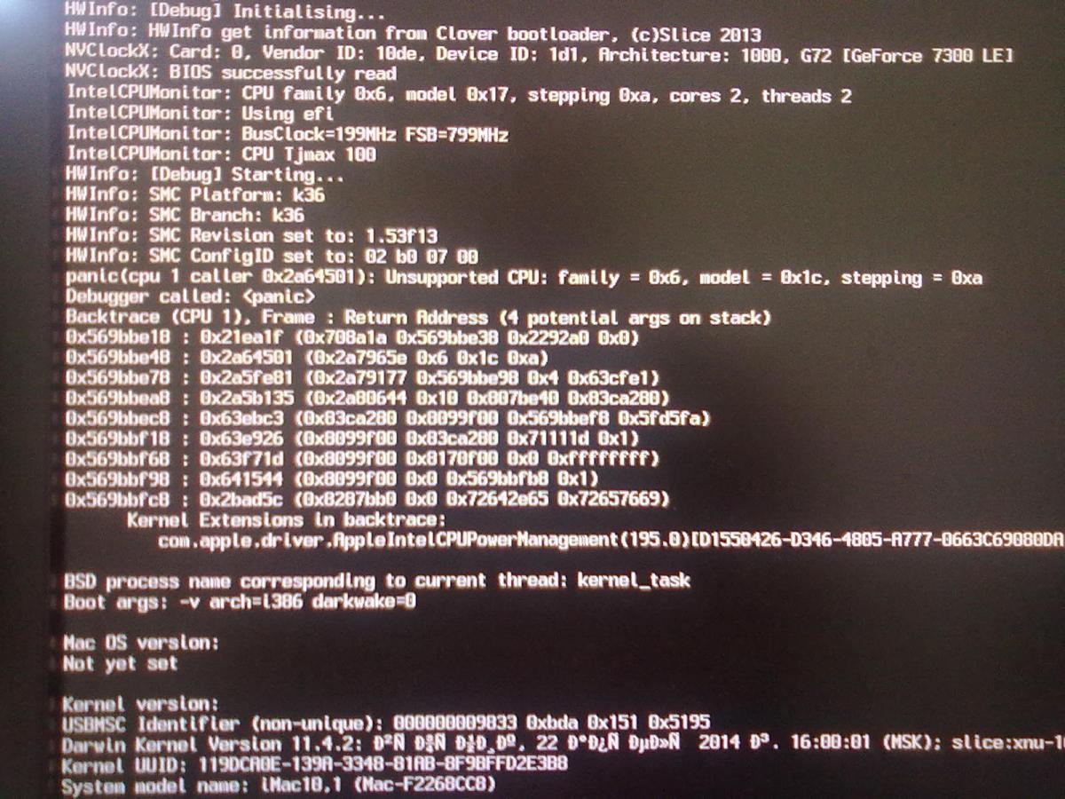

GenerateCStates - (Yes/No, default: No): Set to Yes, if booting gives you weird ACPI_SMC_PlatformPlugin errors.
GeneratePStates - (Yes/No, default: No): Same note as GenerateCStates.
PLimitDict - (Number, default: 0): Limit the maximum CPU P-state, by number.
UnderVoltStep - (Number, default: 0): Limit the maximum CPU Voltage, by number.
DoubleFirstState - (Yes/No, default: No): ??
ResetAddress - (should be: 0x64): Restart address
ResetValue - (should be: 0xFE): Restart address
EnableC6 - (Yes/No, default: No): Enable/disable CPU C6 reporting. (CPU-power saving)
EnableC4 - (Yes/No, default: No): Enable/disable CPU C4 reporting. (CPU-power saving)
EnableC2 - (Yes/No, default: No): Enable/disable CPU C2 reporting. (CPU-power saving)
C3Latency - (should be: 0x03e9): If CPU supports Turbo, you may set to 0x00FA.
EnableISS - (Yes/No, default: No): This should be Enabled to fix ACPI_SMC_PlatformPlugin console errors.
smartUPS - (Yes/No, default: No): For MacPro - cosmetic.
PatchAPIC - (Yes/No, default: No): ??
FixDsdtMask - (Mask): See this topic. If you want to disable DSDT fixing: 0x0000 FixDsdtMask should be avoided for actual DSDT patches. (info by apianti)
RememberBIOS - (Yes/No, default: No): See this post

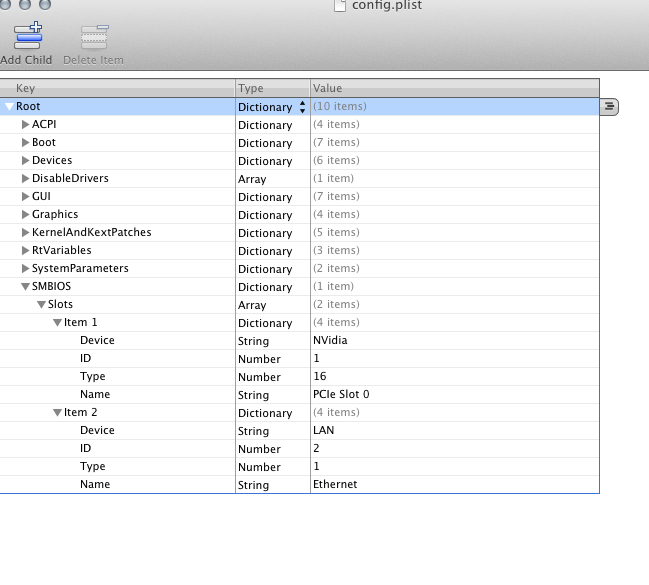

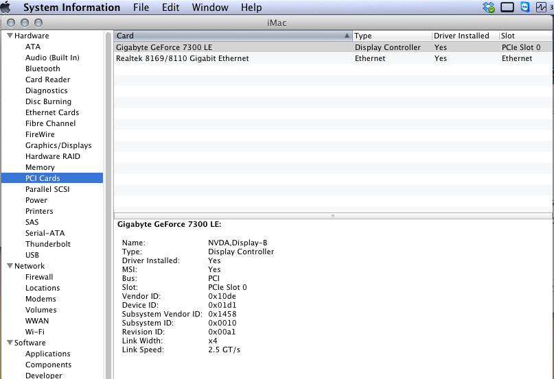

Set a custom iModel. Clover will set the model that matches your system. But you can provide custom data here. (Chameleon Wizard, champlist can be used to get SMBios information)

Debug - (Yes/No, default: No): Needed to debug Clover at boot.
KernelCpu - (Yes/No, default: No): Enable to patch the kernel for unsupported CPU's. (Atom, Ivy, Pentium 4)
AsusAICPUPM - (Yes/No, default: No): AppleIntelCPUPowerManagement.kext patch. No needed if using a patched BIOS.
AppleRTC - (Yes/No, default: No): Patch that fixes AppleRTC.kext boot problem. Needed for 10.6 and above.

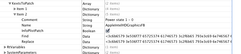

KextsToPatch - (custom): See this post and this post.

Config.plist contains hundreds parameters described in own sections and contains in /doc section of installed Clover.
New section GUI is intended to replace refit.conf

config-sample.plist.zip
  • Like 4

Custom DSDT patches
Revision 1915
You can apply a set of arbitrary patches to DSDT.
Find and Replace data may have different length. Replace string may be zero.
	<key>ACPI</key>
	<dict>
		<key>PatchesDSDT</key>
		<array>
			<dict>
				<key>Find</key>
				<data>W4IeQkFUMQhfSElEDEHQDAoIX1VJRAEUCF9TVEEApAA=</data>
				<key>Replace</key>
				<data></data>
			</dict>
			<dict>
				<key>Find</key>
				<data>UFhTWAhfQURSAAhfUFJXEgYC</data>
				<key>Replace</key>
				<data>UFhTWAhfQURSAAhfU1VOCgQIX1BSVxIGAg==</data>
			</dict>
		</array>
	</dict>

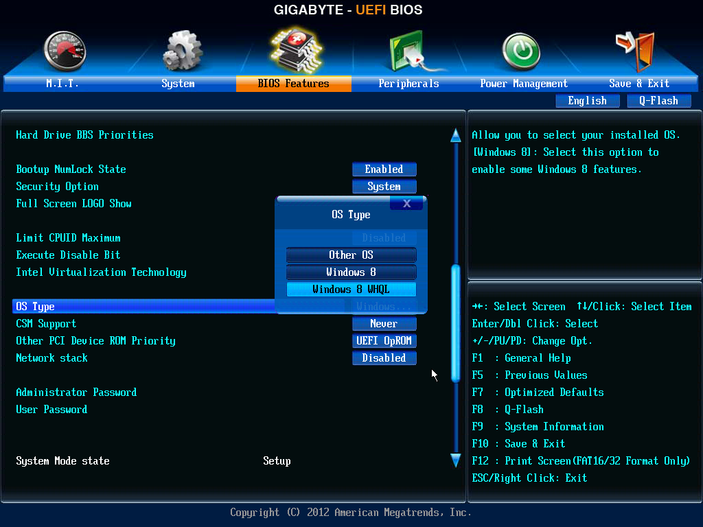

How to do sleep/wake working with UEFI BOOT.
It was problem #1 with UEFI BOOT.
Users usually claim that sleep-wake is not working with Clover while working with Chameleon. This is wrong claim.
There is a problem with UEFI BOOT which is possible only with Clover but all is good with LEGACY BOOT with Clover, Chameleon and other bootloaders.
Now I may said exactly that for working sleep/wake in the case of UEFI boot you need a videocard with UEFI BIOS. I reflashed my Radeon HD6670 with custom-made UEFI BIOS,
set the follow in mother bios
Full LOGO = Disabled
OS = Windows 8
CSM support = never
And now I have only UEFI boot (no legacy is possible).
I have native resolution in Clover GUI 1920x1080 without additional UEFI drivers.
I have full working sleep and wake.
New ACPI table VFCT.
No custom DSDT, just Clover provided fixes for BIOS.aml
FixDSDTMask=0x30DF
RESOLVED.
With Clover rev 1942+ sleep/wake works fine without any conditions. In UEFI mode you need OsxAptioFixDrv new revision.

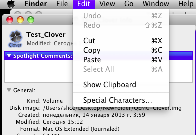

Using Custom OS Icons
Since rev 2232 you may assign own icons to all your volumes even with the same OS.
Write  into config.plist
	<key>GUI</key>
	<dict>
		<key>CustomIcons</key>
		<true/>
Then place an image by copy-paste on volume info
And see the image in CloverGUI

Hibernation
Since revision 2514 we have working hibernation sleep/wake.
Conditions:
Clover rev2513+, recommended 2516+
Legacy booting. So we have working hibernation with CloverEFI but not with UEFI.
System 10.9.1+
We have a few successful reports with UEFI boot and with system 10.7.5. So may be, for your testing.
You have to set
sudo pmset -a hibernatemode 29
Also success with mode 21. Other numbers are waiting for further investigations.
Put computer to sleep. After a one minute it will switch off at all.
Switch on. Looks like ordinary boot and enter Clover GUI
See the volume is hibernated.
Default boot by timeout or press enter.
You see progress bar at the bottom and voila! You are in system! It requires about 10 seconds that is much faster the usual login.
If you have a problem then you can press SPACE and choose "Cancel hibernate wake".
Or you can write into config.plist
	<key>Boot</key>
	<dict>
		<key>NeverHibernate</key>
		<true/>
	</dict>

I propose new solution for that. Revision 2570+, preferred 2577+.
You created your best custom DSDT.aml and place it into /EFI/CLOVER/ACPI/patched as usual.
	<key>ACPI</key>
	<dict>
		<key>DSDT</key>
		<dict>
			<key>Name</key>
			<string>DSDT.aml</string>
			<key>Fixes</key>
			<dict>
				<key>NewWay_80000000</key>
				<true/>
				<key>FixRegions_10000000</key>
				<true/>
			</dict>
And you will see in the boot.log something like
70:891  0:000  OperationRegion (GNVS...) corrected to addr=0xDE4C7E18
Enjoy!

Property List Editor
It is helpful for config.plist editing.
This is utility from old Xcode, looks and works better then new version.
Unpack the archive, copy these frameworks into /Library/Frameworks/
The application may be placed in your convenient folder.
PListEditor.zip
UPDATE.
It's a pity this program is not working in Sierra. RIP!

Blocking Bad Kext
I encounter a bad situation when I installed a kext (it is GeforceSensor) that caused KP. I install it into SLE without checking if it works.
Then I can't boot even with -x, -v, -s. It always loaded and panics.
So I created a revision of Clover that is able to block one kext in /S/L/E.
Test with NVClockX.kext. It is not vital for system so I can experiment with it.
Ordinary boot
zone leak detection enabled
standard timeslicing quantum is 10000 us
mig_table_max_displ = 73
NVClockX: NVClock Darwin port by alphamerik (C) 2010
NVClockX: usr-sse2 (C) 2010
AppleACPICPU: ProcessorId=0 LocalApicId=0 Enabled
AppleACPICPU: ProcessorId=1 LocalApicId=1 Enabled
With BlockKext
HWInfo: [Debug] Initialising...
HWInfo: HWInfo get information from Clover bootloader, (c)Slice 2013
IntelCPUMonitor: Based on code by mercurysquad, superhai (C)2008. Turbostates measurement added by Navi
User defined TjMax=0
So yes, the kext is not loaded by boot.efi. Don't forget to boot without cache!
But then surprise!!!
slice$ sudo kextstat | grep -v apple
Password:
Index Refs Address    Size       Wired      Name (Version) <Linked Against>
   18    4 0x566db000 0xa000     0x9000     org.netkas.FakeSMC (3.3.1) <13 7 5 4 3>
   19    0 0x56236000 0x4000     0x3000     org.slice.HWInfo (1) <18 7 4 3>
   20    0 0x566e5000 0x6000     0x5000     org.slice.IntelCPUMonitor (1.1) <18 7 5 4 3>
   23    0 0x56763000 0x7000     0x6000     org.mozodojo.ITEIT87x (1.0.3) <18 7 5 4 3>
   36    0 0x56746000 0x5000     0x4000     com.yourcompany.driver.AppleACPIPS2Nub (1.0.0d1) <13 7 5 4 3 1>
   38    0 0x564b4000 0x3000     0x2000     net.osrom.kext.Disabler (1.0.1) <4 3>
   79    0 0x5d46b000 0x14000    0x13000    org.usrsse2.NVClockX (1.0.1d1) <18 14 7 5 4 3>
   85    0 0x564b7000 0x23000    0x22000    org.voodoo.driver.VoodooHDA (2.8.4) <84 14 7 5 4 3>
Sergeys-iMac:Clover slice$
It is loaded! Why? I think it is loaded by kernel that is not affected by FSInject.efi
But it is loaded much later and give me an ability to boot with -s before the KP will occur.
Yes, this is workaround in the case above.

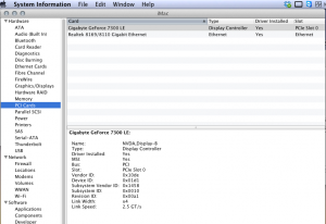

AAPL,slot-name
This is a property that usually injected by DSDT or property strings but this is a wrong way to go.
Actually this property appeared by AppleSMBIOS.kext (see sources if you want).
So in revision 2673 I made more vanilla way to assign this property.
1. DSDT must contain Name (_SUN, 0x05). Or other number. The number must be one byte and avoid 0 and 1 because of stupid optimization. Sample:
                Device (GIGE)
                    Name (_ADR, 0x00050000)  // _ADR: Address
                    Name (_SUN, 0x02)  // _SUN: Slot User Number
You may write nothing but set DSDT Fix Mask bits for those devices
2. SMBIOS must contains tables type 9 for each named device. To do this write into config.plist like here
Here
- Slots->Device is a one of devices {ATI, NVidia, LAN, WIFI, Firewire}. That's all for now. I can accept more propositions.
- Slots->ID must be the same number as you set into DSDT in _SUN.
- Slots->Name will be a string that you want to assign to AAPL,slot-name
- Slot->Type is intended to be a type of slot. There is a number 0,1,2,4,8,16 means PCI, PCIe 1x, PCIe 2x etc.
3. Clover must be revision 2673+
See the result

Fake CPUID
What to do if your OSX is not supported your CPU?
See table what CPUs supported by different OS versions
CPU name	CPUID	10.4.11	10.5.8	10.6.3	10.6.8	10.7.2	10.7.5	10.8.5	10.9.2
Yonah	      0x0006E6	1	1	1	1	1	1	0	0
Conroe	      0x0006F2	1	1	1	1	1	1	1	1
Penryn	      0x010676	0	1	1	1	1	1	1	1
Nehalem	      0x0106A2	0	1	1	1	1	1	1	1
Atom	      0x0106C2	0	0	0	0	0	0	0	0
XeonMP	      0x0106D0	0	0	0	1	0	0	0	0
Linnfield     0x0106E0	0	0	1	1	1	1	1	1
Havendale     0x0106F0	0	0	1	1	1	1	1	1
Clarkdale     0x020650	0	0	0	1	1	1	1	1
AtomSandy     0x020660	0	0	0	0	0	0	0	0
Lincroft      0x020670	0	0	0	0	0	0	0	0
SandyBridge   0x0206A0	0	0	0	1	1	1	1	1
Westmere      0x0206C0	0	0	0	1	1	1	1	1
Jaketown      0x0206D0	0	0	0	1	1	1	1	1
NehalemEx     0x0206E0	0	0	1	1	1	1	1	1
WestmereEx    0x0206F0	0	0	0	1	1	1	1	1
Atom2000      0x030660	0	0	0	0	0	0	0	0
IvyBridge     0x0306A0	0	0	0	0	0	1	1	1
Haswell	      0x0306C0	0	0	0	0	0	0	1	1
IvyBridgeE5   0x0306E0	0	0	0	0	0	0	0	1
HaswellMB     0x0306F0	0	0	0	0	0	0	1	1
HaswellULT    0x040650	0	0	0	0	0	0	1	1
CrystalWell   0x040660	0	0	0	0	0	0	1	1
If you want to install OSX on Atom CPU then you may see it is not supported.
As well IvyBridge is not supported by 10.7.2 while it will be supported by 10.7.5 after SoftwareUpdate.
For these cases Clover-rev2748+ proposes you to set FakeCPUID in config.plist or even in GUI -> Binaries patching menu
	<key>KernelAndKextPatches</key>
	<dict>
		<key>FakeCPUID</key>
		<string>0x010676</string>
In this example we tell that the CPU is Penryn supported by all OS versions 10.5+
To illustrate I set for my CPU FakeID=0x0106C2 that is unsupported Atom and as expected I got KP while IntelCPUMonitor sees real CPU - Penryn :)
And vice versa. If you set good model for bad CPU you may successfully start system.
Download a version CLOVERX64.efi-rev2749.zip
  • Like 14

 Multiple boot options.
Rev 2948+
Briefly, Clover writes Boot#### options for each entry in MainMenu and set BootCurrent to last booted entry if all correct.
Requirements: UEFI boot with real NVRAM present.
Usage:
Enter CloverGUI, navigate to "Clover Boot Options" in the tools row of main menu and press "Add Clover boot options for all entries".
If you once do this no need to repeat. It will be saved in NVRAM forever.
When you change the main menu by adding new volume, new partition, new OS then you should
first remove old options: "Remove all Clover boot options"
second add all options again.
Print them into boot.log to see what you have.
When you started an OS by some entry in the Menu then this entry will be saved as "BootCurrent" and next boot will happen with Clover knowing DefaultVolume and DefaultLoader as in last boot.
Advantages
1. It will remember last boot to Windows or even to legacy boot (not checked but I hope it is).
2. Bios menu will contain these entries.
I tested with QEMU+Ovmf and have the follow debug.log after tuning:
Boot options:
48:487  0:051  BootOrder: 7: Boot0005, Boot0006, Boot0000, Boot0001, Boot0002, Boot0003, Boot0004
49:388  0:901   0) Boot0005: Clover start boot.efi at Macintosh, Attr: 0x1
49:442  0:053      HD(1,GPT,065C30D9-992D-4C4C-8965-A266108C7D0F,0x800,0x60000)\EFI\CLOVER\CLOVERX64.EFI
49:495  0:053      Size: 222 (Attr:4 + FPl:2 + Desc:70 + FP:102 + Opt:44 = 222 -> OK)
49:550  0:054   1) Boot0006: Clover start (null) at EFI, Attr: 0x1
49:604  0:054      HD(1,GPT,065C30D9-992D-4C4C-8965-A266108C7D0F,0x800,0x60000)\EFI\CLOVER\CLOVERX64.EFI
49:697  0:093      Size: 176 (Attr:4 + FPl:2 + Desc:54 + FP:102 + Opt:14 = 176 -> OK)
49:751  0:053   2) Boot0000: EFI Floppy, Attr: 0x1
49:805  0:053      PciRoot(0x0)\Pci(0x1,0x0)\Floppy(0x0)
49:860  0:054      Size: 62 (Attr:4 + FPl:2 + Desc:22 + FP:34 + Opt:0 = 62 -> OK)
49:914  0:054   3) Boot0001: EFI Floppy 1, Attr: 0x1
49:967  0:053      PciRoot(0x0)\Pci(0x1,0x0)\Floppy(0x1)
50:021  0:053      Size: 66 (Attr:4 + FPl:2 + Desc:26 + FP:34 + Opt:0 = 66 -> OK)
50:114  0:093   4) Boot0002: EFI Hard Drive, Attr: 0x1
50:168  0:053      PciRoot(0x0)\Pci(0x1,0x1)\Ata(0x0)
50:225  0:056      Size: 66 (Attr:4 + FPl:2 + Desc:30 + FP:30 + Opt:0 = 66 -> OK)
50:279  0:054   5) Boot0003: EFI Network, Attr: 0x1
50:334  0:054      PciRoot(0x0)\Pci(0x3,0x0)\MAC(525400123456,0x1)
50:387  0:053      Size: 89 (Attr:4 + FPl:2 + Desc:24 + FP:59 + Opt:0 = 89 -> OK)
50:441  0:054   6) Boot0004: EFI Internal Shell, Attr: 0x1
50:536  0:094      MemoryMapped(0xB,0x900000,0x10FFFFF)\FvFile(C57AD6B7-0515-40A8-9D21-551652854E37)
50:590  0:054      Size: 92 (Attr:4 + FPl:2 + Desc:38 + FP:48 + Opt:0 = 92 -> OK)
50:643  0:053  -------------
0:109  0:000  Clover revision: 2947  running on Standard PC (i440FX + PIIX, 1996)
0:109  0:000  ... with board
0:109  0:000  Clover load options size = 44 bytes
0:109  0:000  Clover started with option to boot boot.efi from Macintosh

How to install Windows in EFI mode on legacy BIOS based PC
using legacy Clover
It is a way to go away from legacy systems even if you have old BIOS based computer.
First, you should realize that there are requirement for partition table:
1. OSX requires GPT. It can be installed into MBR with special patch.
2. Legacy Windows requires MBR and can't be installed into GPT.
3. UEFI Windows requires GPT and can't be installed into MBR. Moreover, check with fdisk, it must be as follow:
fdisk: 1> p
Disk: /dev/rdisk0	geometry: 19457/255/63 [312579695 sectors]
Offset: 0	Signature: 0xAA55
         Starting       Ending
 #: id  cyl  hd sec -  cyl  hd sec [     start -       size]
 1: EE    0   0   2 - 1023 254  63 [         1 -         34] <Unknown ID>
 2: 00    0   0   0 -    0   0   0 [         0 -          0] unused
 3: 00    0   0   0 -    0   0   0 [         0 -          0] unused
 4: 00    0   0   0 -    0   0   0 [         0 -          0] unused
fdisk: 1>
I mean there must be no Hybrid MBR! Attention! Only one partition and it is with EE sign. Check and zero all other entries if found.
Second.
Minimum Windows version is Windows 7-64bit. So your computer must have 64-bit CPU.
Installation order.
1. Install Mac OSX first. In the installer format your drive to GPT and reserve a space for Windows at least 60Gb.
2. Install Clover into EFI partition created during the formatting. It must be boot6 (Clover SATA)
3. Insert DVD with Windows-7-64bit. It must be ISO9660+Joilet format. Not UDF because Clover is not ready for this.  GrubUDF.efi works!
4. Start the windows EFI-install from this DVD by Clover

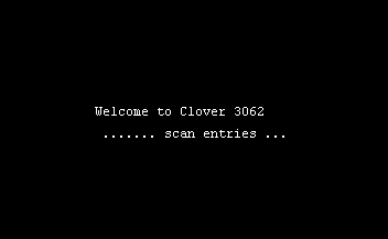

How to speedup Clover boot
There is usual claim from novices that Clover is too slow (or hang). Let us consider this question carefully.
If you try Clover first time then it is logically that you install it onto USB stick and set debug-log to be created. This is the reason of slowness #1.
	<key>Boot</key>
	<dict>
		<key>Log</key>
		<false/>
This is wrong key name, I will change the key to "Debug" (since rev3064) that will reflect its appointment. Boot.log will be created even with "False", it just be in memory and accessible in system if booted.
When "true" the "debug.log" will be Open-Write-Close on every line guarantying you will found the file even after hard-reset.
The file will be saved in /clover-partition/EFI/CLOVER/misc/ folder is the partition is FAT32 to help you understand what is the reason of hang is any. The process ve-e-ery slo-o-ow. With my USB stick I have to wait about 10 minutes to enter GUI.
Set "false" here!
I also will kindly recommend to install Clover on HDD that times faster then USB. Why not? You want to keep Chameleon here? Yes, it is possible. Clover and Chameleon can live on the same partition with the same boot sectors. Boot sectors from Clover distribution are able to boot Chameleon as they are comes from them. But not vice versa. Chameleon's boot1h is not able to boot Clover because of its restriction.

Reason #6. Slow HFS+ driver.
Official release of Clover contains VBoxHFS.efi driver. It is very good, it understand links sft and hard, it understand aliases, but slow.
Apple's driver HFSplus.efi is much faster but we have no license to distribute it. Take it somewhere (here #3 ) and place it into /EFI/CLOVER/drivers64*/ folder. And it will works instead embedded driver. (since rev 3043).
Since Clover revision 3063 you may see boot process on the screen to understand why it is soo slow.

InfoPlist Patching
There is interesting Clover ability to perform an Info.plist patching on the fly.
Since rev.3154 I should set more strict rules to have a success.
Write into config.plist the follow as example
	<dict>
		<key>KextsToPatch</key>
		<array>
			<dict>
				<key>Comment</key>
				<string>Power state 1 - 0</string>
				<key>Name</key>
				<string>AppleIntelHDGraphicsFB</string>
				<key>InfoPlistPatch</key>
				<true/>
				<key>Find</key>
				<data>PGtleT5Qb3dlclN0YXRlczwva2V5PjxpbnRlZ2VyPjE8L2ludGVnZXI+</data>
				<key>Replace</key>
				<data>PGtleT5Qb3dlclN0YXRlczwva2V5PjxpbnRlZ2VyPjA8L2ludGVnZXI+</data>
			</dict>
		</array>
	</dict>
It corresponds to replace in kext AppleIntelHDGraphicsFB.kext, in its Info.plist the lines
				<key>PowerStates</key>
				<integer>1</integer>
by lines
				<integer>0</integer>
but original pattern contains symbols "", "/", LF, TAB, SPACES that impossible to correctly write into config.plist.
So
1. You have to erase all invisible characters from pattern search.
2. Convert to .
The result looks like
This is only way to do search and replace will be success.

Look, for example, line
4:432 0:000 PCI (00|02:05.00) : 10EC 8167 class=020000
This is LAN device
VendorID= 10EC - this is Realtek
DeviceID= 8167 - This is Realtek 8167/8169/8110 Gigabyte Ethernet Controller
It is located on the PCI bus (green digits)
Bus = 02
Device = 05
Function = 00
This location will be unique for every device in your computer. You may have two equal graphics cards with the same IDs and same model. But their locations will be different.
We have to write into config.plist in section "Devices", array "Arbitrary" of items one per device you want to inject properties.

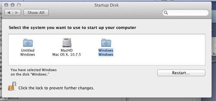

Reboot to Windows UEFI from Mac
If you successfully installed two system using my instructions at post #46 then this is for you.
Click on restart and really restarted into Windows!
But some prerequisites.
1. Make Windows partition to be writable. I wrote a line into file /etc/fstab
LABEL=Windows none ntfs rw,auto,nobrowse
2. Place mach_kernel and empty folder /System/Library/CoreServices/ to the drive.
I am not sure if something else needed. The instruction will be corrected after a more experience.

4:104  0:000   Adding Key: efi-boot-device: String: Size = 489, Val = '<array><dict><key>MemoryType</key><integer size="64">0xb</integer><key>StartingAddress</key><integer size="64">0xffe00000</integer><key>IOEFIDevicePathType</key><string>HardwareMemoryMapped</string><key>EndingAddress</key><integer size="64">0xffefffff</integer></dict><dict><key>IOEFIDevicePathType</key><string>MediaFirmwareVolumeFilePath</string><key>Guid</key><string>2B0585EB-D8B8-49A9-8B8C-E21B01AEF2B7</string></dict><dict><key>IOEFIBootOption</key><string>HD</string></dict></array>'
4:104  0:000   Adding Key: efi-boot-device-data: Size = 48, Data: 01 03 18 00 0B 00 00 00 00 00 E0 FF 00 00 00 00 FF FF EF FF 00 00 00 00 04 06 14 00 EB 85 05 2B B8 D8 A9 49 8B 8C E2 1B 01 AE F2 B7 7F FF 04 00
4:309  0:004  GetEfiBootDeviceFromNvram:got efi-boot-device-data size=48
4:309  0:000
4:309  0:000   efi-boot-device-data: MemoryMapped(0xB,0xFFE00000,0xFFEFFFFF)\FvFile(2B0585EB-D8B8-49A9-8B8C-E21B01AEF2B7)
4:309  0:000   BootCampHD: PcieRoot(0x0)\Pci(0x1F,0x2)\Ata(0x0)
4:309  0:000   Volume: 'PcieRoot(0x0)\Pci(0x1F,0x2)\Ata(0x0)'
4:309  0:000   LoaderPath: '<null string>'
4:309  0:000   volume: disk = PcieRoot(0x0)\Pci(0x1F,0x2)\Ata(0x0)
4:309  0:000   searching for that disk
4:309  0:000    found disk as volume 1. 'Whole Disc Boot'
4:309  0:000   searching for first entry with win loader or win partition on that disk
4:309  0:000    found loader entry 0. 'Boot Microsoft EFI boot from EFI', Volume 'EFI', '\EFI\microsoft\Boot\bootmgfw.efi'
4:309  0:000  Boot redirected to Entry 0. 'Boot Microsoft EFI boot from EFI'
We may notice next conditions:
  Usage of nvram.plist. So Clover scripts must be enabled. This is legacy Clover and I don't know if the same is possible with hardware NVRAM.
We see Clover successfully recognized boot entry left by Mac OS 10.7.5 to boot from bootmgfw.efi!
