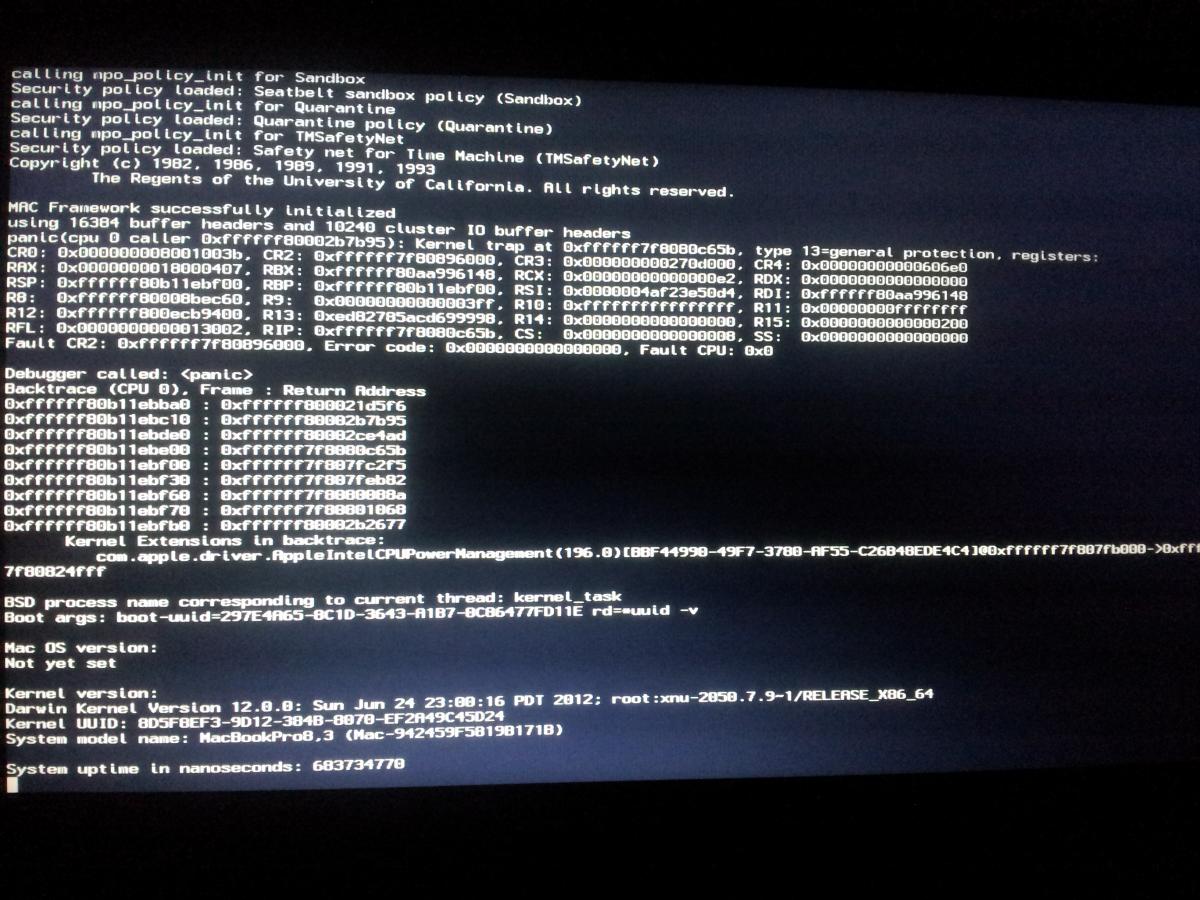

sniper9911 Posted August 13, 2012 Author Share Posted August 13, 2012 sorry for my bad expression what I meant was that I did change the boot sequence from the bios itself not from the boot menu because I don't have one any way I managed to boot up my usb flash drive the problem was that no one told me that it has to be mbr partitioned okay but I had a panic but I don't know what it is I took a picture of it and I will attach Link to comment https://www.insanelymac.com/forum/topic/281768-need-help-booting-mountain-lion-installation-on-my-laptoplaptop/#findComment-1843577 Share on other sites More sharing options...

sniper9911 Posted August 13, 2012 Author Share Posted August 13, 2012 thank you for understanding do you have ann idea about that panic code in pictures its getting late already here at my country so I will countinue in. at 12gmt Link to comment https://www.insanelymac.com/forum/topic/281768-need-help-booting-mountain-lion-installation-on-my-laptoplaptop/#findComment-1843581 Share on other sites More sharing options...
sniper9911 Posted August 13, 2012 Author Share Posted August 13, 2012 any one knows how to get out of that panic code !! Link to comment https://www.insanelymac.com/forum/topic/281768-need-help-booting-mountain-lion-installation-on-my-laptoplaptop/#findComment-1843647 Share on other sites More sharing options...
sniper9911 Posted August 13, 2012 Author Share Posted August 13, 2012 any body help me if you can please !!! Link to comment https://www.insanelymac.com/forum/topic/281768-need-help-booting-mountain-lion-installation-on-my-laptoplaptop/#findComment-1843680 Share on other sites More sharing options...
iFIRE Posted August 13, 2012 Share Posted August 13, 2012 try this boot flag: -f -v -x GraphicsEnabler=No busratio=25 npci=0x2000 and if no boot post your Extra. 1 Link to comment https://www.insanelymac.com/forum/topic/281768-need-help-booting-mountain-lion-installation-on-my-laptoplaptop/#findComment-1843689 Share on other sites More sharing options...

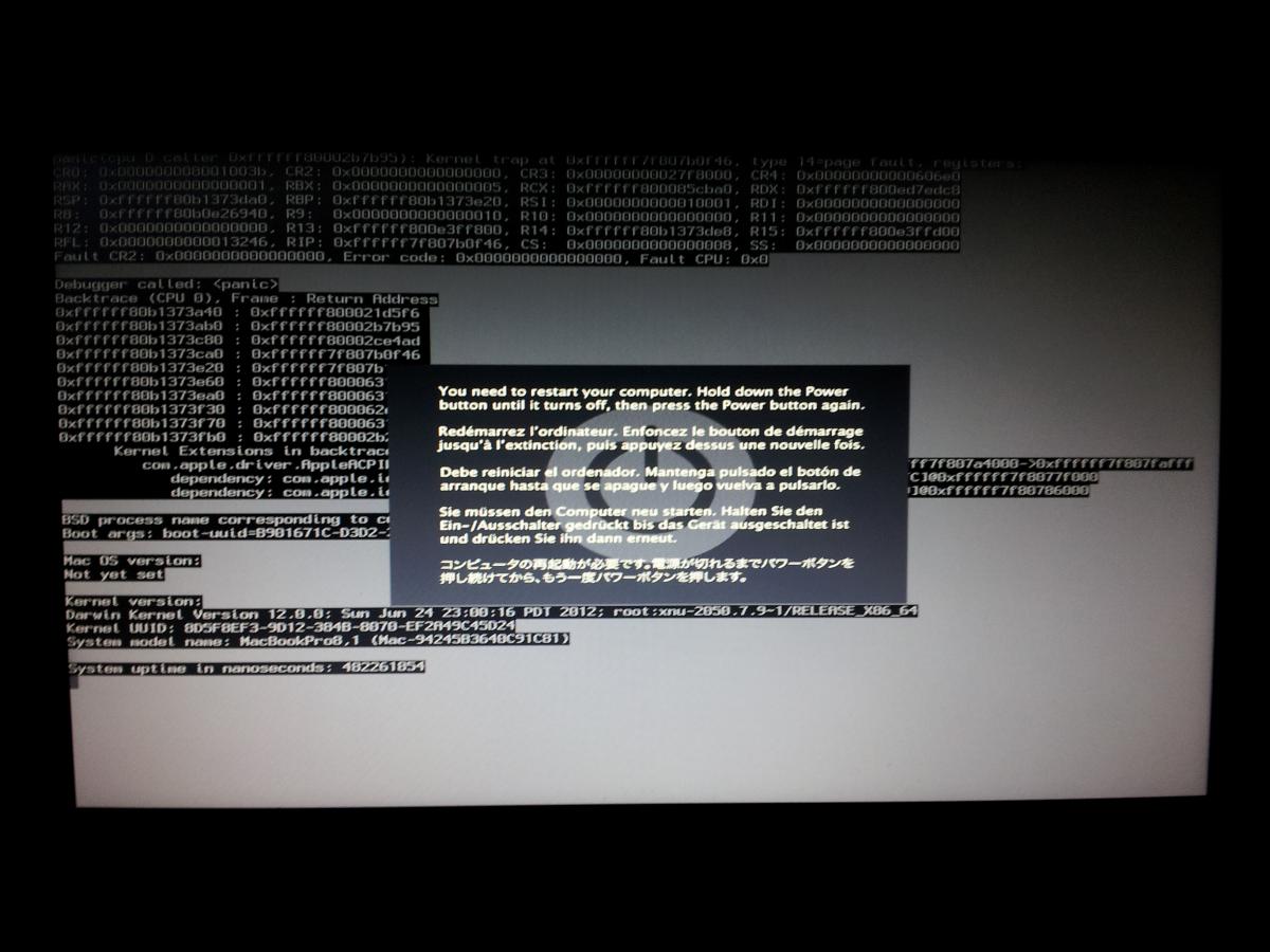

sniper9911 Posted August 15, 2012 Author Share Posted August 15, 2012 nevermind everyone about the mouse keyboard problem cause I used apple ps2 kexts and I booted into the installation successfully but before the apple logo I had two lines says that there was some problems during boot and there is a pause for 5 seconds then apple logo and the system boots when I changed to verbose mode at first it says dsdt.aml not found and too much lines afterwards of kexts . is this okay ?? anyway I installed the mac os x mountain lion on my 32gb usb flash disk guid formatted and the installation completed successfully i rebooted my system and then I got another panic twice !!! what should I do help me please !! I will attach the picture of the panic Link to comment https://www.insanelymac.com/forum/topic/281768-need-help-booting-mountain-lion-installation-on-my-laptoplaptop/#findComment-1844137 Share on other sites More sharing options...
iFIRE Posted August 15, 2012 Share Posted August 15, 2012 OK , put this kexts in your Extra/Extensions of USBInstaller and boot with -f -v PS2.zip Link to comment https://www.insanelymac.com/forum/topic/281768-need-help-booting-mountain-lion-installation-on-my-laptoplaptop/#findComment-1844176 Share on other sites More sharing options...
sniper9911 Posted August 15, 2012 Author Share Posted August 15, 2012 thanks ifire for attaching the file but I already posted about the mouse keyboard problem however do you have an idea about that second panic I got do I need to change something or to rick something in the chameleon wizard perhaps please respond quickly if you can . Link to comment https://www.insanelymac.com/forum/topic/281768-need-help-booting-mountain-lion-installation-on-my-laptoplaptop/#findComment-1844180 Share on other sites More sharing options...

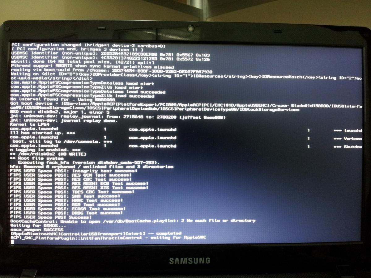

sniper9911 Posted August 15, 2012 Author Share Posted August 15, 2012 ifire : thank you for your support i did put your files in my extra extention folder (only just them) i was able to boot with no panics but now i am stuck at the loading screen the circle under the apple keeps spinning and spinning for 15 minutes and nothig happens this is where am i right now in verbose mode it says waiting for apple smc or something like that help please !! Link to comment https://www.insanelymac.com/forum/topic/281768-need-help-booting-mountain-lion-installation-on-my-laptoplaptop/#findComment-1844220 Share on other sites More sharing options...
iFIRE Posted August 15, 2012 Share Posted August 15, 2012 try this boot flag again: -f -v -x GraphicsEnabler=No busratio=25 npci=0x2000 post your folder EXTRA!!!!!!! Link to comment https://www.insanelymac.com/forum/topic/281768-need-help-booting-mountain-lion-installation-on-my-laptoplaptop/#findComment-1844222 Share on other sites More sharing options...
sniper9911 Posted August 15, 2012 Author Share Posted August 15, 2012 thank you so much ifire for your rapid resposes the thing is i tried your flagboot but nothing happened so i searched i little more this time and found that i do need to put fakesmc.kext in e/e as well as s/l/e i reinstalled my mac os x lion on 32gb guid partitioned usb disk and it took around 30 minutes to complete anyway it said install completed and i shut down my computer and started a cold boot from usb (as always) an vioalla` i have reached the welcome screen with the following working on my laptop : keyboard , mouse , cpu core i5 and ram all recognized 6gb ddr3-1333 , intel hd 3000 , ethernet worked after i inserted the rtl81xx.kext , camera worked but a little blurry (its alot better on windows so it may need patching or kext) , usb mouse also working not working : sd slot card not working (supports xc) , Sound obviosly (realtek alc269) , Nvidia gt520m , camera resolution , cannot boot without installation usb , wifi (wireless-n 130) , multi touch track pad function (basic functions are ok) sleep , thanks for ifire for battery kext but it doesnt see the status of it (stuck at 0%) , also i dont know how to reduce screen brightness nor the function keys on my keboard except for the sound functions note : i also tried yesterday to replace installation files to intall to MBR partition but it said installation failed (only 3 minutes left but fails and cannot boot correctly ) does any one how to So Finally i reached the mac world and i hope it comes to a good stay Thanks to ifire for the kexts I need just one more thing : How can i install ML on an mbr partition ??? and this is my extra folder content : Extra.zip Link to comment https://www.insanelymac.com/forum/topic/281768-need-help-booting-mountain-lion-installation-on-my-laptoplaptop/#findComment-1844257 Share on other sites More sharing options...

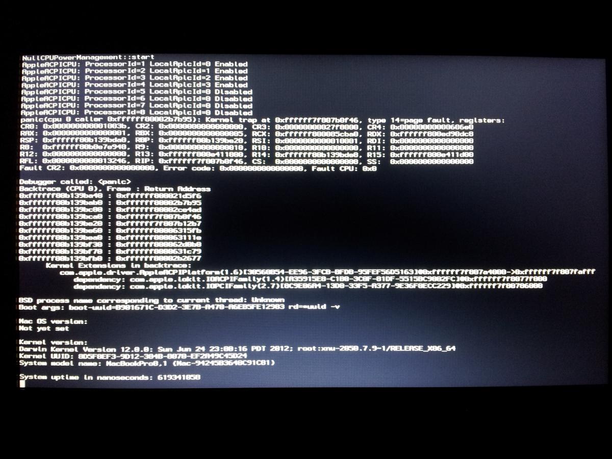

sniper9911 Posted August 16, 2012 Author Share Posted August 16, 2012 I did another attempt to install osx on mbr and it worked oh my god the only thing I did was deleting battery kext and off I got it up and running on my external mbr usb hdd 80gb I also tried the synaptics tracpad kext and it failed to see my mouse and I was forced to redo my hole installation from zero I redid the usb installation and reformatted like every attempt but this time when I reached the welcome screen my trackpad didn't work and I needed to connect my usb mouse to continue installing but keyboard works I don't know how to get it working again please help me if you can so to close this thread or move it to continue on fixing the not working list I am so sorry ifire for not using your method only but I was eager to try mac os x on my laptop !! and anyway thanks for everyone for helping also I promise you a well written guide on how to install ML on my laptop model when I finish fixing Link to comment https://www.insanelymac.com/forum/topic/281768-need-help-booting-mountain-lion-installation-on-my-laptoplaptop/#findComment-1844458 Share on other sites More sharing options...
sniper9911 Posted August 16, 2012 Author Share Posted August 16, 2012 i really dont know why my ps/2 mouse trackpad didnt work anymore i only tried to install this file and i got a panic so i did reinstall my system again Can i re-enable my ps2 mouse again or not ?? here is the trouble ps2 that i installed help me please !! 1448-TRACKPAD.SYNAPTIC-GESTURE.zip Link to comment https://www.insanelymac.com/forum/topic/281768-need-help-booting-mountain-lion-installation-on-my-laptoplaptop/#findComment-1844577 Share on other sites More sharing options...
