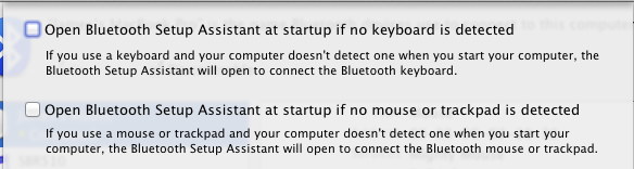

During the installation, you will need bluetooth or usb mouse/keyboard. After the installation, open Bluetooth Preference Pane > Advanced and uncheck :

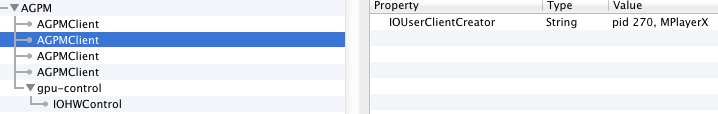

@Friends, I remember one of you mentioned about a media player that doesn't play very well with Lion. Also i mentioned previously that GPU performance in Lion is not really good and sometimes sluggish. Today, I tried MPlayerX from Apple Store and noticed that it doesn't play media files very well, which wasn't the case in Snow Leopard. VLC on the other hand works really well but apparently only uses software acceleration.
So, I played with DSDT and AppleGraphicsPowerManagement.kext and I solved the above mentioned problems. GPU still doesn't throttle completely but whatever OS X Lion, iTunes, Quicktime and MPlayerX etc. are using during animations or playing media files, OS X is now able to utilise it properly as I can see "AGPM Client" in IOREG Explorer depending on the application I am running. Mail, Login Window, iTunes, MPlayerX are all appear in the list.
Attached File  Screen_Shot_2011_07_28_at_22.09.37.png   16.47K   97 downloads
I wonder if other HP users have the above problem? Are you able to see AGPM Client in IOREG Explorer?
For now, it is a bit dirty hack. I'll try to simplify and share it soon.

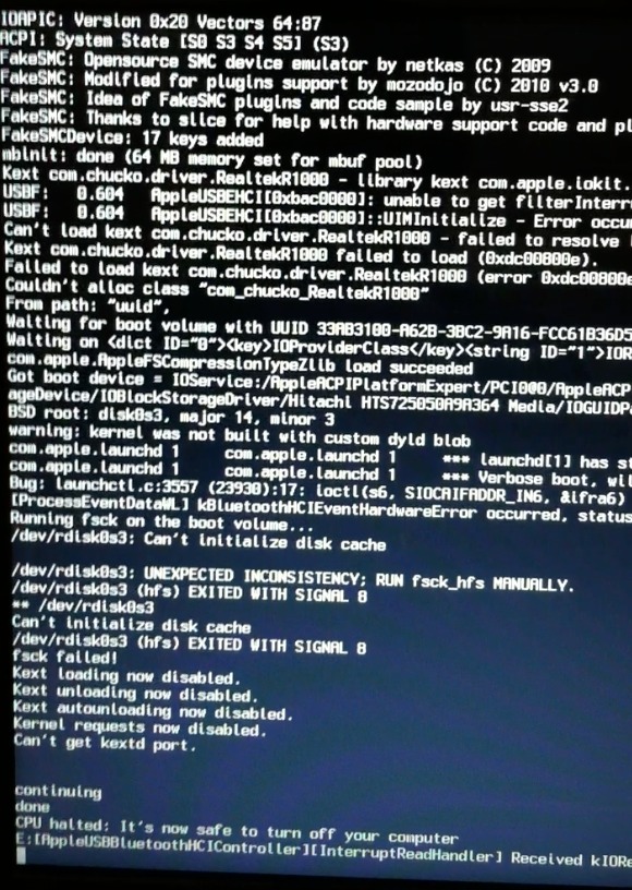

Hi all
I am trying to install any mac os verion on my HP DV6 i5 460M, Tried 10.6.3 vanilla, hazard, iatkos s3, but no hope. I am getting installer to run but afte reboot laptop shuts down? see the attachment. anyone can please help me????
