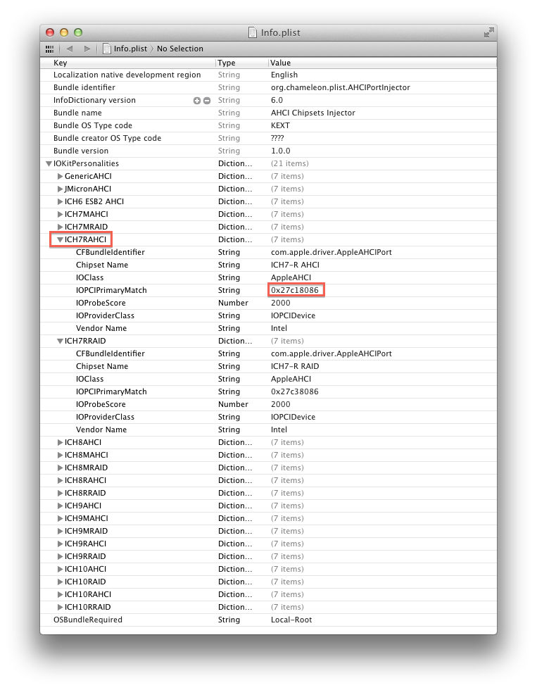

Gringo Vermelho Posted March 28, 2012 Share Posted March 28, 2012 Note that (according to his notes) he has ICH7R, which has a different device ID than ICH7. This is a very important detail that should not be missed. All he needs is to enable AHCI mode in the BIOS and use AHCIPortInjector.kext, which will inject the correct device IDs for ICH7R so that the OS X drivers will load for it. Bleak: If you want your DVD drive to be master, then set the jumper on the back of the DVD drive to master and place the drive at the end of the cable. This is pretty basic stuff, please do some more reading before throwing yourself to the wolves. 1 Link to comment Share on other sites More sharing options...

Gringo Vermelho Posted March 28, 2012 Share Posted March 28, 2012 No..that's the whole point of this kext; there's no need to modify it, it can be used right away. See for yourself: It'll even work with ICH7R in RAID mode. Link to comment Share on other sites More sharing options...

Gringo Vermelho Posted March 29, 2012 Share Posted March 29, 2012 Then you set it to RAID mode. you'll notice if you look at the screenshot above that ICH7R in RAID mode is supported. If your ICH7 is not an "R" model, then you can use ATAPortInjector.kext or AppleIntelPIIATA.kext. Note that you cannot immediately install retail Lion to your hard drive if it's MBR partitioned. You'll need to modify the installer packages first so that it will allow you to install on an MBR drive. I can't help you with that (I've never done it) but it shouldn't be a problem finding the information you need. You won't have this problem if you format and partition your drive with Apple Disk Utility before installing. Link to comment Share on other sites More sharing options...
