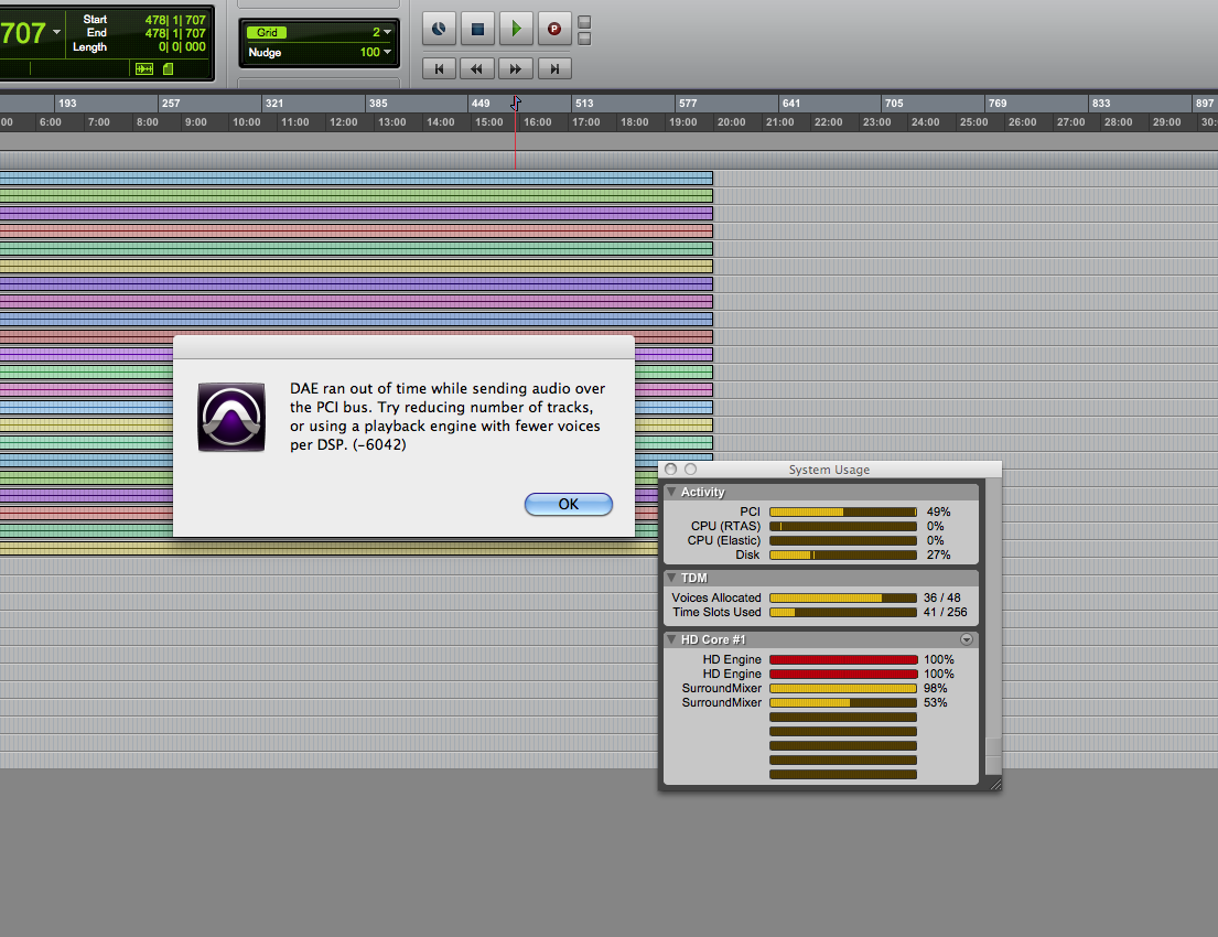

MikOnMac Posted January 29, 2012 Author Share Posted January 29, 2012 Hello again. I have a big problem with this mobo and an HD2 system, core + process. PT 9 starts but after some minutes of play on a normal session it gives a DAE error -6042: Same results using only core or inverting cards order. Bios is F5. Mac OS X version is 10.6.8. PT is 9.0.4 Same result with PT 8. Where is the error? Some months ago I tested successfully an HD2 with same mobo. Can it be related to HD firmware version? Link to comment Share on other sites More sharing options...
XLR Posted February 14, 2012 Share Posted February 14, 2012 Hello again. I have a big problem with this mobo and an HD2 system, core + process. PT 9 starts but after some minutes of play on a normal session it gives a DAE error -6042: Same results using only core or inverting cards order. Bios is F5. Mac OS X version is 10.6.8. PT is 9.0.4 Same result with PT 8. Where is the error? Some months ago I tested successfully an HD2 with same mobo. Can it be related to HD firmware version? Did you found a solution? Link to comment Share on other sites More sharing options...
MikOnMac Posted February 14, 2012 Author Share Posted February 14, 2012 No. Probably the problem is power supply. Actually I don't have an HD2 system to do more tests. Link to comment Share on other sites More sharing options...
