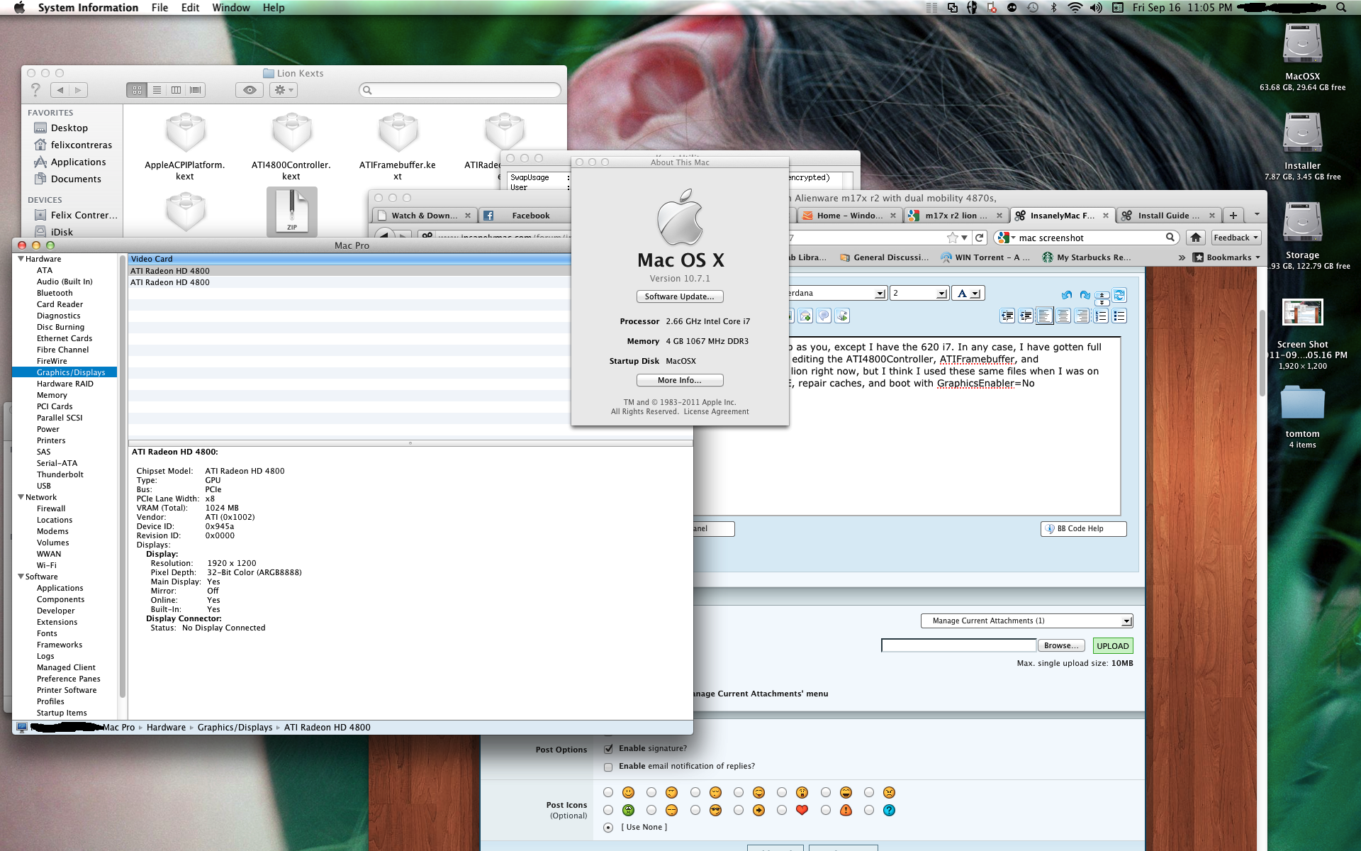

gumboman4 Posted September 17, 2011 Share Posted September 17, 2011 Hey there, I have the same setup as you, except I have the 620 i7. In any case, I have gotten full graphics support on my cards by editing the ATI4800Controller, ATIFramebuffer, and ATIRadeonX2000 kexts. I am on lion right now, but I think I used these same files when I was on SL. Just copy these to your S/L/E, repair caches, and boot with GraphicsEnabler=No Let me know if it works for you. Just realized you haven't posted in this for over 4 months. GraphicsKexts.zip Link to comment Share on other sites More sharing options...
bassistas Posted September 17, 2011 Share Posted September 17, 2011 Hey there, I have the same setup as you, except I have the 620 i7. In any case, I have gotten full graphics support on my cards by editing the ATI4800Controller, ATIFramebuffer, and ATIRadeonX2000 kexts. I am on lion right now, but I think I used these same files when I was on SL. Just copy these to your S/L/E, repair caches, and boot with GraphicsEnabler=No Let me know if it works for you. Just realized you haven't posted in this for over 4 months. I have also the alienware m17x r2 but with 5870 crossfire. In lion 10.7 worked without editing anything. Installed and was already in full resolution with qe/ci enabled. I see in your screenshot that you have your wireless lan working. how did you managed to install the wifi card? mine not recognised. Link to comment Share on other sites More sharing options...

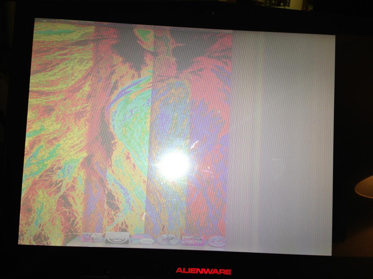

sapman Posted October 22, 2014 Share Posted October 22, 2014 Anybody have any clue how to fix this issue? Its driving me nuts!! Whenever I wake from sleep on my laptop monitor I get this. An attached display will wake up fine but not my laptop monitor. Is there some way to re-detect the laptop display or something? Link to comment Share on other sites More sharing options...
