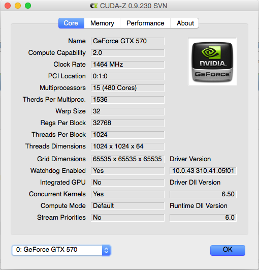

Attached File  Core.png   95.41KB   29 downloads Attached File  Memory.png   77.48KB   36 downloads Attached File  Performance.png   78.96KB   36 downloads

  • Retired
  • 2,902 posts
  • Gender:Male
  • Location:Stuttgart / Germany
Performance Tab : Device to Device Speed shows VRAM Speed.
In your case, GT 520 , you can see that that value is not good, because of limited (Bits) vram bandwidth of GT 520 (GT 420, GT 620) and others using 64/128 Bit instead of 256/384 Bit.

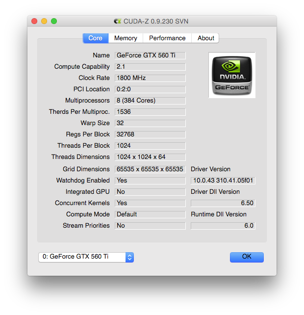

Attached File  cuda-z_0.9.230-svn.png   92.96KB   6 downloads
