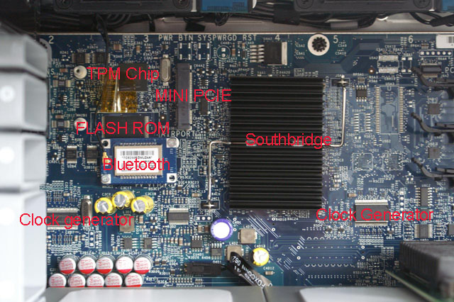

Steven Lin Posted August 21, 2006 Share Posted August 21, 2006 mac pro motherboard go to the last pic at top left....TPM chip on a mac Pro Link to comment Share on other sites More sharing options...
re-book Posted August 21, 2006 Author Share Posted August 21, 2006 mac pro motherboardgo to the last pic at top left....TPM chip on a mac Pro I can not read the chip lable, so ............. re-book Link to comment Share on other sites More sharing options...
bofors Posted August 21, 2006 Share Posted August 21, 2006 In German:"Ein Trusted Plattform Module (TPM) wie in den anderen x86-Macs konnten wir im Mac Pro nicht ausmachen. Über einen vorhandenen Low-Pin-Count-Anschluss (LPC) ließe sich ein solches jedoch nachrüsten." I will try a translation: "In the Mac Pro we could not find a Trusted Plattform Module (TPM) like in all the other x86-Macs, but on the logic board is a Low-Pin-Count-Slot, where it should be possible to add one." Thanks. I sound like they might have just missed it. I can not read the chip lable, so ............. I cannot read these either, but if Steven Lin was able to determine that one is TPM chip, I am going to accept that result for now because I would be extremely surprized if the Mac Pro did not have a TPM chip. Link to comment Share on other sites More sharing options...
Steven Lin Posted August 21, 2006 Share Posted August 21, 2006 Thanks. I sound like they might have just missed it.I cannot read these either, but if Steven Lin was able to determine that one is TPM chip, I am going to accept that result for now because I would be extremely surprized if the Mac Pro did not have a TPM chip. http://www.ifixit.com/Guide/85.10.16.html Same TPM Chip as MacBook Pro,MacBook and Mac mini Link to comment Share on other sites More sharing options...

bofors Posted August 21, 2006 Share Posted August 21, 2006 mac pro motherboardgo to the last pic at top left....TPM chip on a mac Pro Steven, in the interest of settling this question, can you explain how you are able to identify the TPM chip and state exactly which chip it is in the pic you referenced (attached)? Link to comment Share on other sites More sharing options...

Steven Lin Posted August 22, 2006 Share Posted August 22, 2006 maybe the mac pro that dt magzine reviewed got a Airport MINI PCIE Card; so the TPM chip is covered by Air Port Extreme. there is surely a TPM Chip on a mac pro. http://www.xtremesystems.org/forums/showthread.php?t=91459 http://fugger.netfirms.com/mobo1.jpg mac mini same TPM Chip on the top right. http://www.ifixit.com/Guide/ http://www.ifixit.com/Guide/85/images_large/45.jpg macbook pro center bottom Link to comment Share on other sites More sharing options...

re-book Posted August 22, 2006 Author Share Posted August 22, 2006 maybe the mac pro that dt magzine reviewed got a Airport MINI PCIE Card;so the TPM chip is covered by Air Port Extreme. there is surely a TPM Chip on a mac pro. http://www.xtremesystems.org/forums/showthread.php?t=91459 http://fugger.netfirms.com/mobo1.jpg mac mini same TPM Chip on the top right. http://www.ifixit.com/Guide/ http://www.ifixit.com/Guide/85/images_large/45.jpg macbook pro center bottom The square chip you mean is no tpm. For you orientation: http://www.flickr.com/photos/paoloattivissimo/tags/tpm/ Perhaps some one knows what that is ? re-book Link to comment Share on other sites More sharing options...
bofors Posted August 22, 2006 Share Posted August 22, 2006 The square chip you mean is no tpm. I don't know what the square chip is, but Re-book is correct. I had expected the TPM to look like this: Link to comment Share on other sites More sharing options...
gwprod12 Posted August 22, 2006 Share Posted August 22, 2006 I don't know what the square chip is, but Re-book is correct. I had expected the TPM to look like this: The infineon logo is sort of a giveaway. Link to comment Share on other sites More sharing options...
Steven Lin Posted August 22, 2006 Share Posted August 22, 2006 Sorry, I really make a mistake. I appoligize. that's a MCU Chip. http://documentation.renesas.com/eng/produ...01b0013_h8s.pdf Check the security part Link to comment Share on other sites More sharing options...

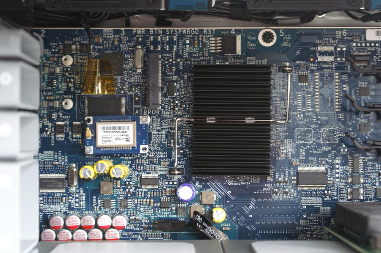

troisd Posted August 30, 2006 Share Posted August 30, 2006 Pardon my ignorance if I'm wrong, but Steven Lin's "Bluetooth" tag on the image is actually an AirPort card. 1) It says so on the motherboard, and 2) it has an antenna plug connected to it. Perhaps because of its blue color he thought it was bluetooth?!? Link to comment Share on other sites More sharing options...
