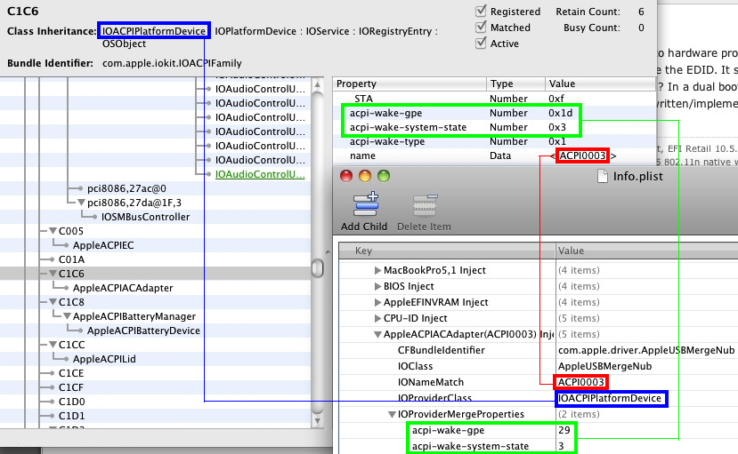

It is pity that modifying vendor id and device id doesn't make kext driver loaded.
But,I don't need natit anymore.
By injecting information,I got my graphic card enabled and make my wireless look like an AirPort Extreme Card.
Good job,Andy! :angel:

Could you please post your plist. I'm curious how you got your graphic card working as I get a kernel panic each time I try it this way.
Thx!
harbri
Ohh.....yes,go ahead.
This info.plist is for GMA 950(27AE) graphic and lots more infomation for my HP mini 2140.
Attached File  Info.plist.zip   9.58KB   81 downloads
Thx!
That's an impressive piece of work, I can learn a lot from it.
OMG! Very impressive. Please, can you upload your .ioreg (from IORegistryExplorer) Please Please Please jejeje. Thanks.
