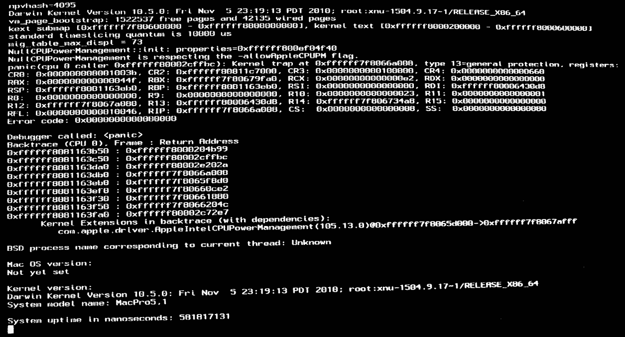

I don't know how to identify clues in the panic, so I've attached a pic.

The panic on the AppleIntelCPUPowerManagement kext is a `type 13=general protection' fault.
If it had involved HPET there would be a DSDT fix, but the AppleHPET kext loads on your machine.
