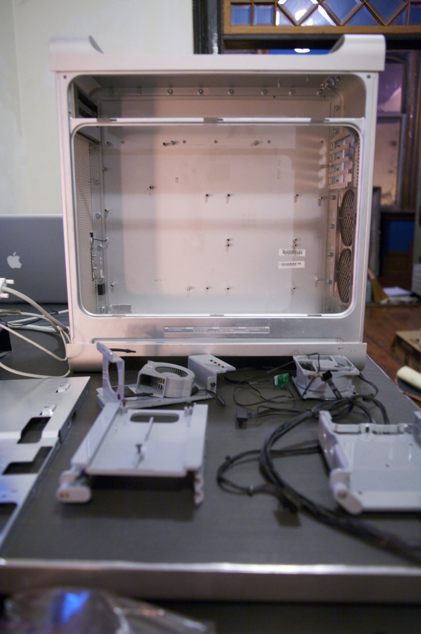

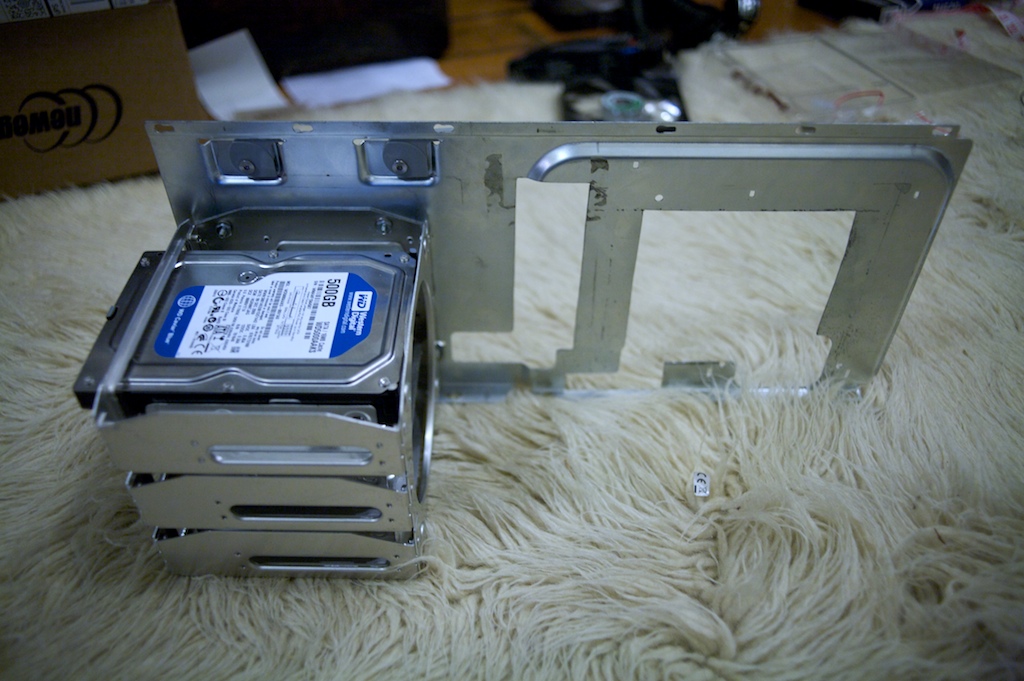

smeared Posted January 17, 2010 Author Share Posted January 17, 2010 OK. Day 1 of getting into it! I started it off with a trip to Microcenter for more necessities. A barracuda 1TB 7200rpm drive for windows. On sale for $89. The cheapest case they had for random metal and parts. $20 on sale. This 5 drive internal rack. http://microcenter.com/single_product_resu...duct_id=0290245 (not sure about this yet, it was $37, and I found this 4 drive one for $17, http://microcenter.com/single_product_resu...duct_id=0294692 ). Also miscellaneous cables, a $3 keyboard (mine is bluetooth), tools, 2.5 to 3.5 drive adapter, and boy, I was close to picking up the Corsair H50 for $79. But I held off, glad I did after I saw it later in the day at frys electronics for $49!!!. I still held off. I still think I'm going to go with a simple water setup with a double fan rad. _____________________________________________________ So far, the build is going well. Lots to figure out still. I was elated to see that after a few modifications to the top shelf, my PSU is going to fit PERFECTLY, where the G5 hard drives used to be (top rear, above the motherboard). I don't want to take it apart, and void the warranty, so the cord will be routed to the bottom, or some other solution. HD rack suspended from the top shelf. Motherboard has been positioned and tomorrow I'll be attaching some custom standoffs, and hopefully booting the system for the first time. If my dremel held a charge longer I'd be much closer to that now. But it's seen a lot of action today. Link to comment Share on other sites More sharing options...

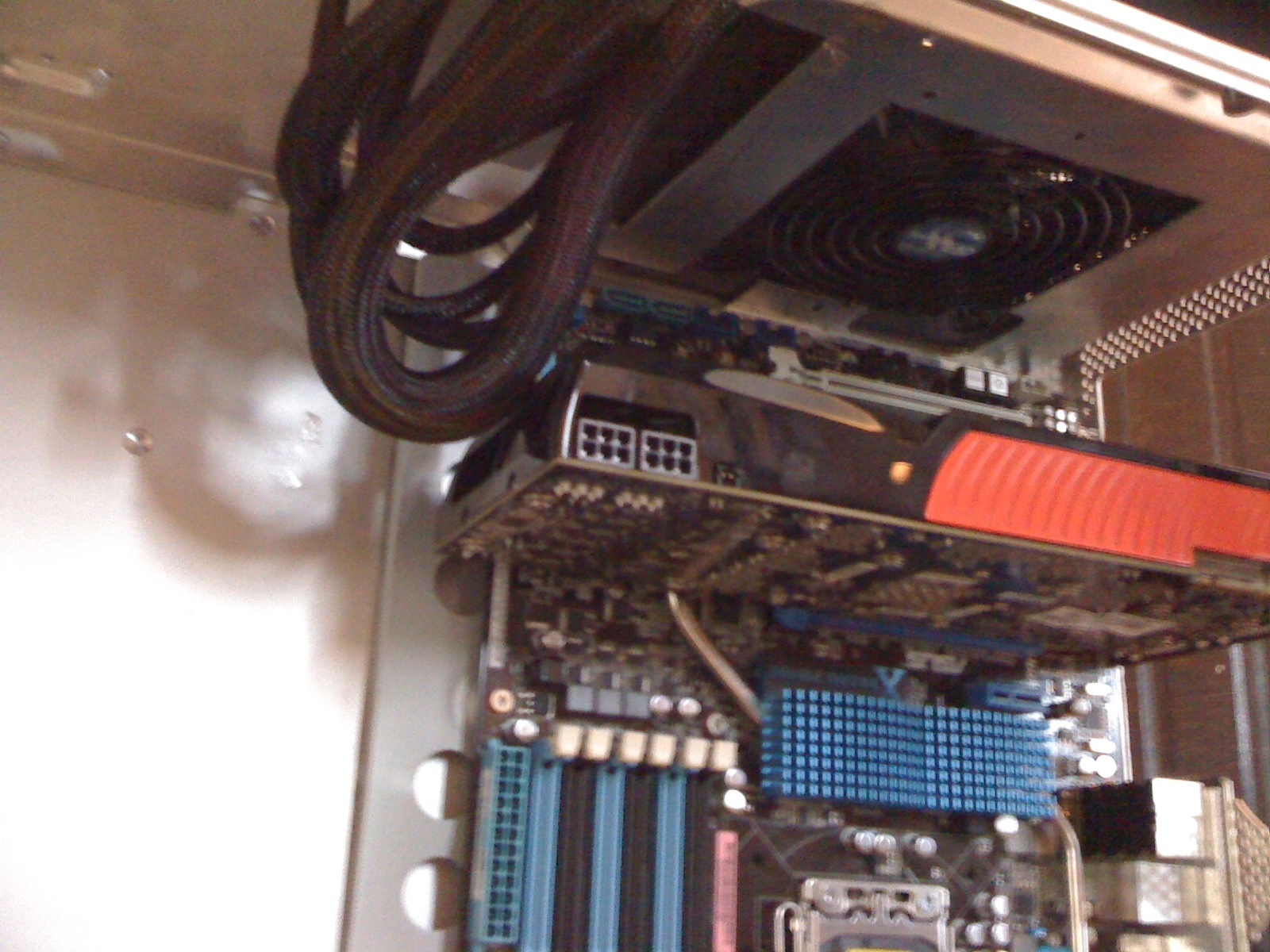

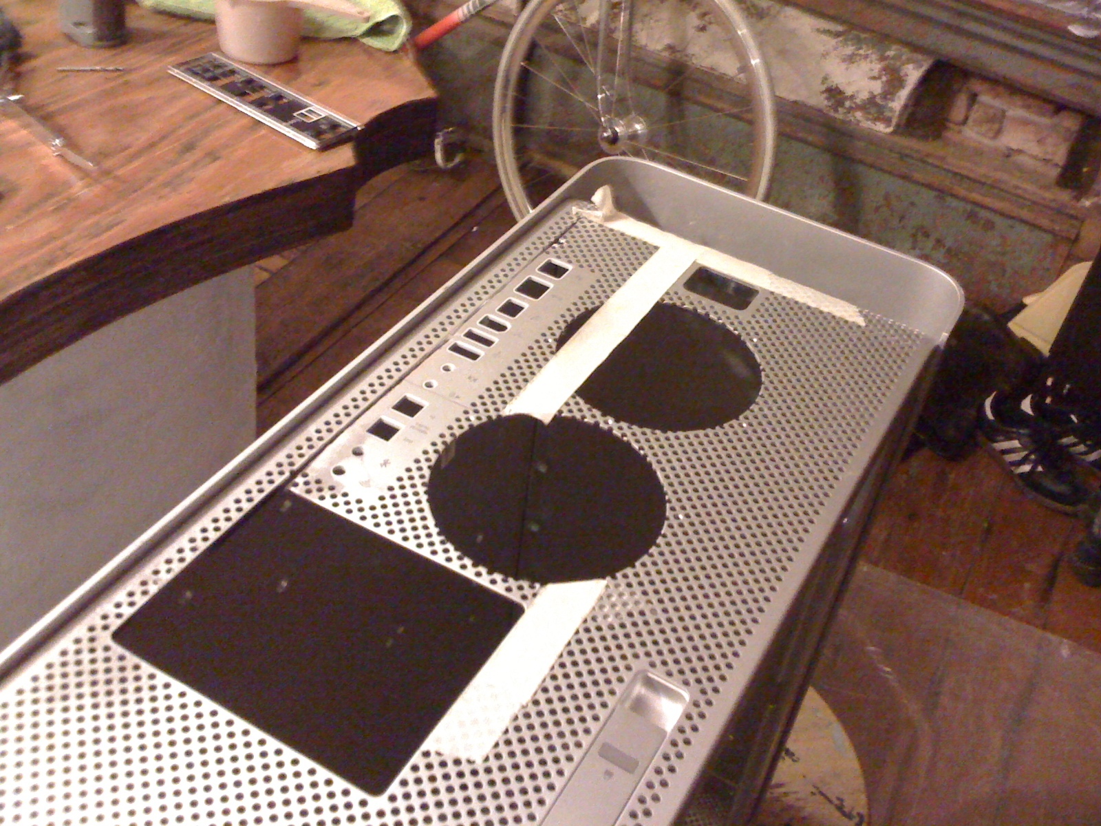

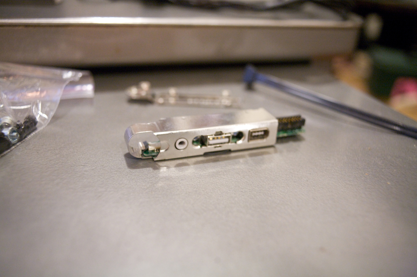

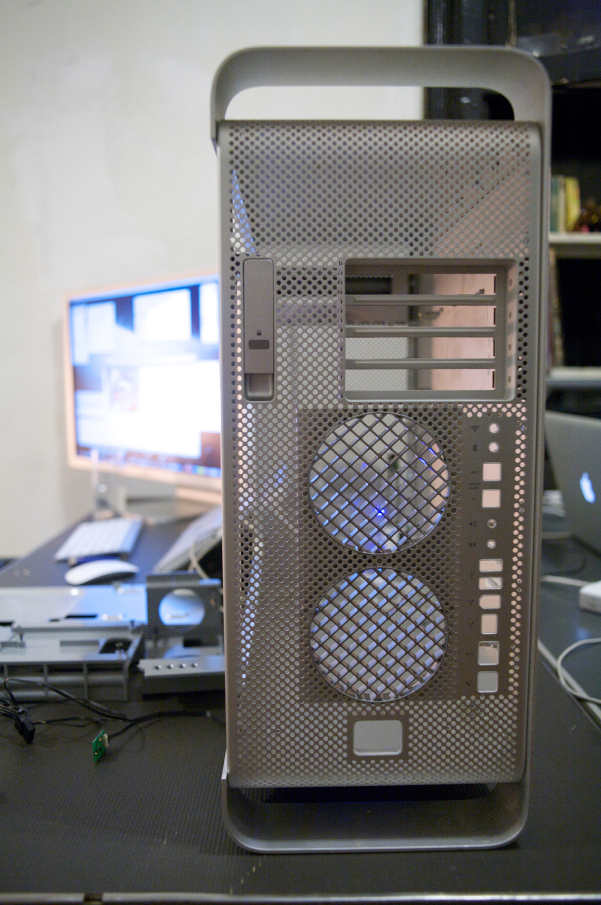

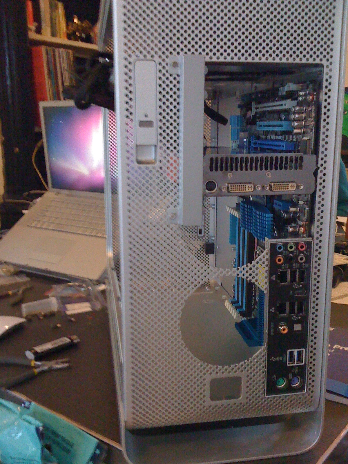

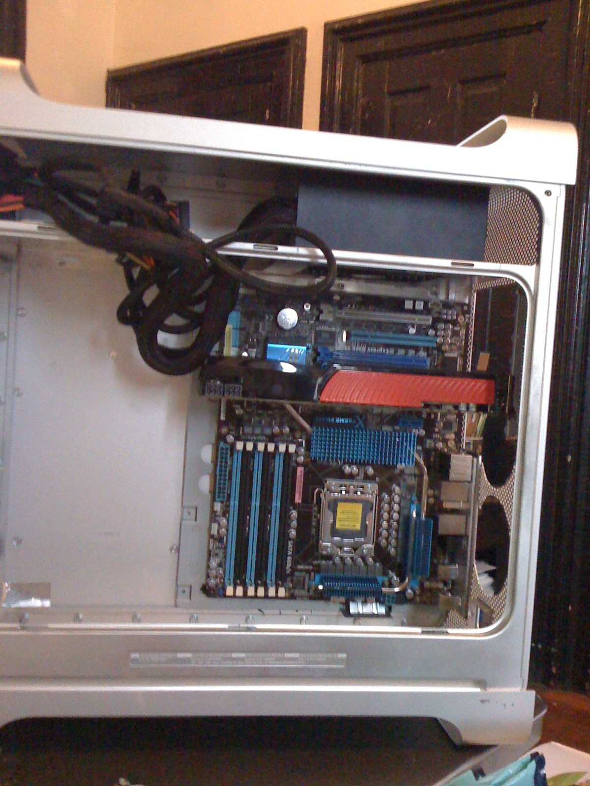

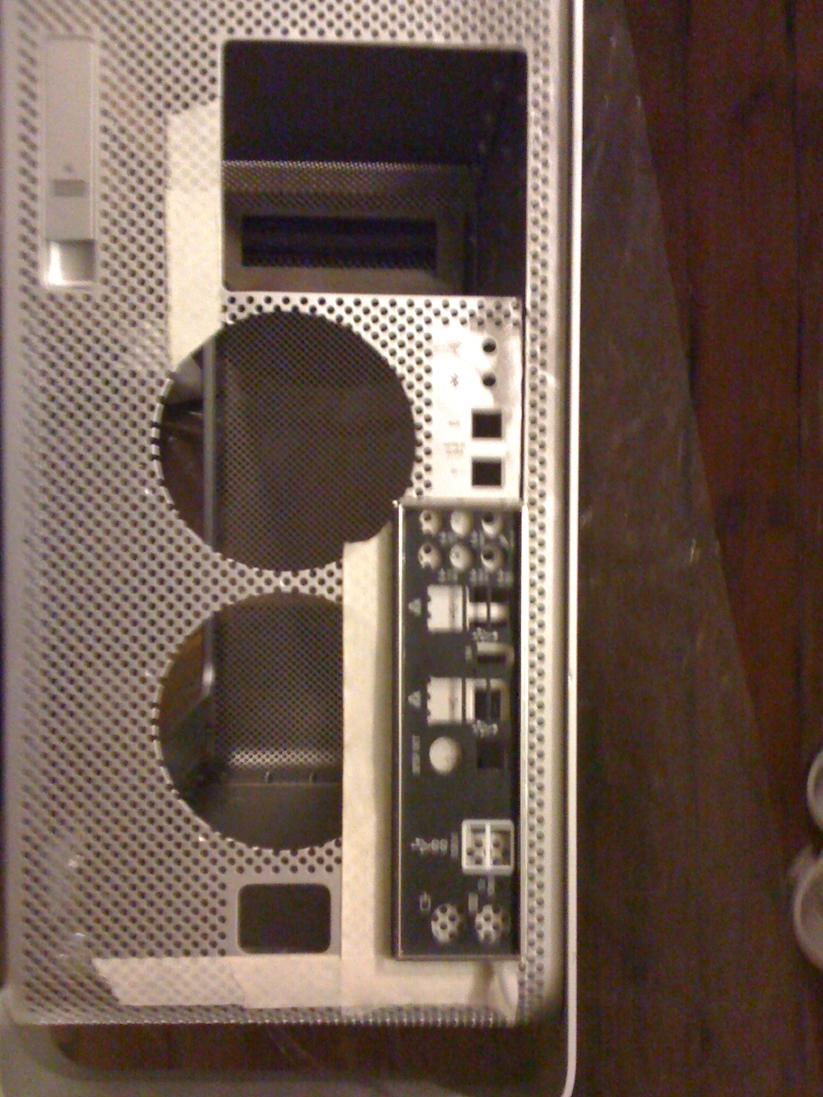

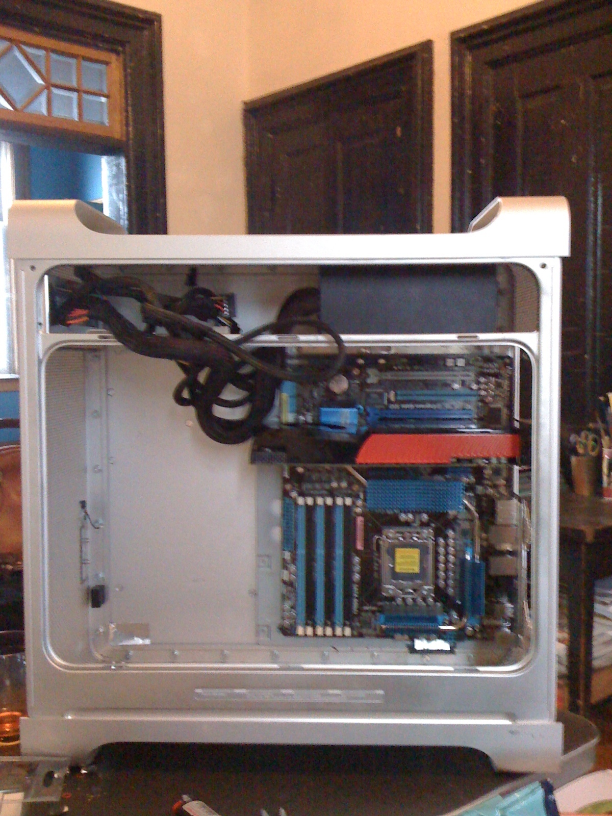

smeared Posted January 19, 2010 Author Share Posted January 19, 2010 Hey y'all. Things are progressing pretty fast for me actually. But this post does come with some questions. So, I drilled out the motherboard tray from the $20 case I bought, and modified it slightly. Mainly the height, using the existing edges. I fashioned three small tabs for some of those tiny #4 − 40 screws. Then after a good deal of measuring, mounted the tray with those screws, and a healthy dose of JB Weld. When using JB Weld, it's always best to remember surface area matters most. I figure I carefully covered about 25 − 30 square centimeters. Quite a bit. But I wanted to be sure. I also covered the screws in it. I stacked about 10 large books on top of it overnight. I pulled on it very hard, and it's never coming off. Which is why I was really happy that everything still lined up after curing! I decided early on that I wanted the i/o ports to be even with the rear of the g5, which meant that something would have to protrude to anchor pci cards. I thought this was a simple enough solution. Easier then using extensions for ports I wanted to use. And easier then creating a new back panel and mounting it inset. Who knows, some may hate it, I don't mind it. I used another piece off the cheapo case. I think it'll look better once i alter the fan housing and reinsert it. Now I just need to create something to go between the ports and the card slots. As you can see in one of the photos, I cut a hole in the shelf for the seasonic psu fan, as well as another for the cords. I'm working on a nice clean hole in the back for the power now, but again the dremel is dead Questions: Anyone know of a silver paint for the cheapo part that matches closely the silver of the g5? Does anyone have or know where I could get the cd drive mount that fits into the slots on the shelf, without paying a ton? I don't know how it goes as of right now. Didn't think I was going to keep the shelf in the beginning, but obviously I am, so... any info would be awesome. I have a lot to do before this system will be usable, but I am considering hooking it all up just to check that everything works. Should I put it together stock right now and test it? or should I wait until I have chosen and purchased a cooling system, as well as installing everything "permanently"? Til next update. Link to comment Share on other sites More sharing options...

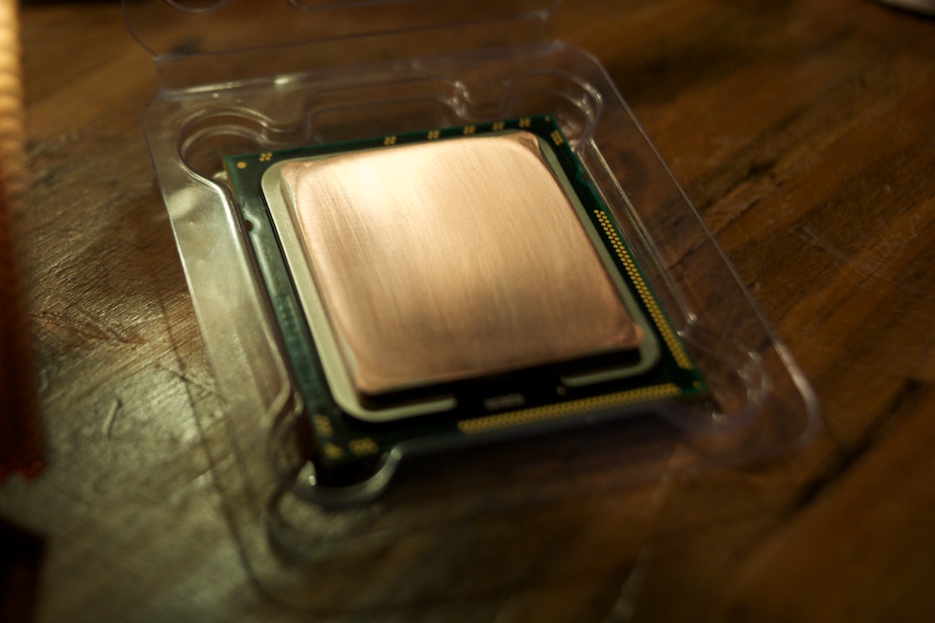

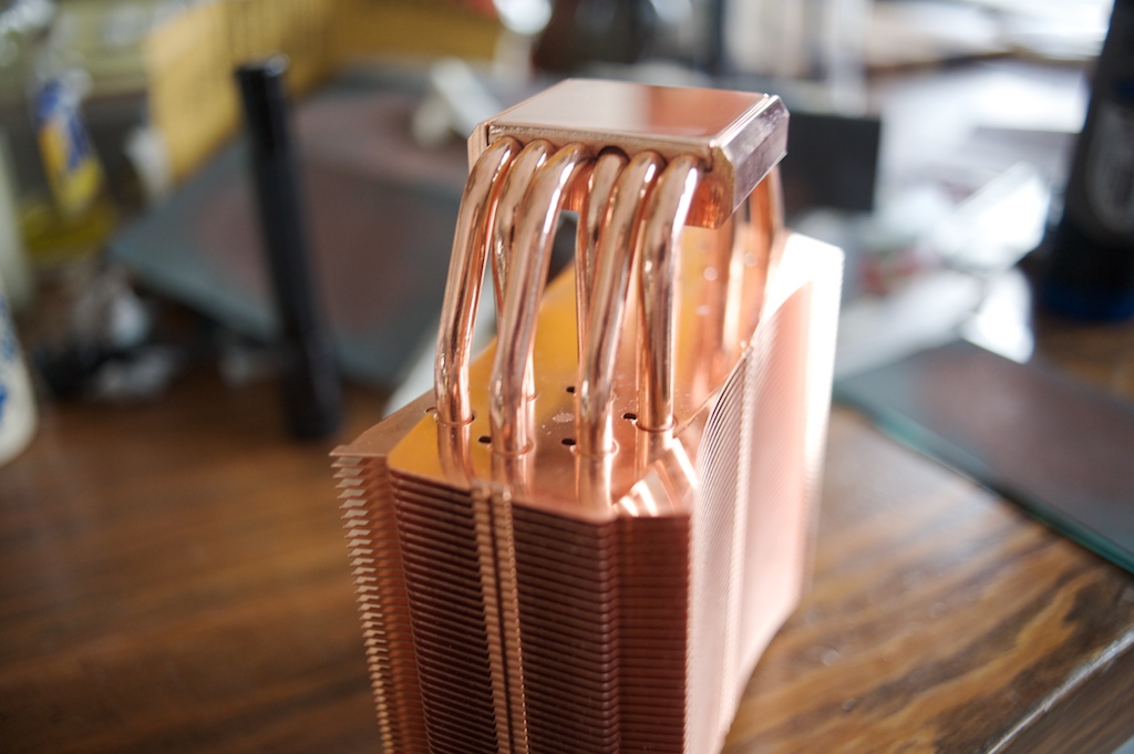

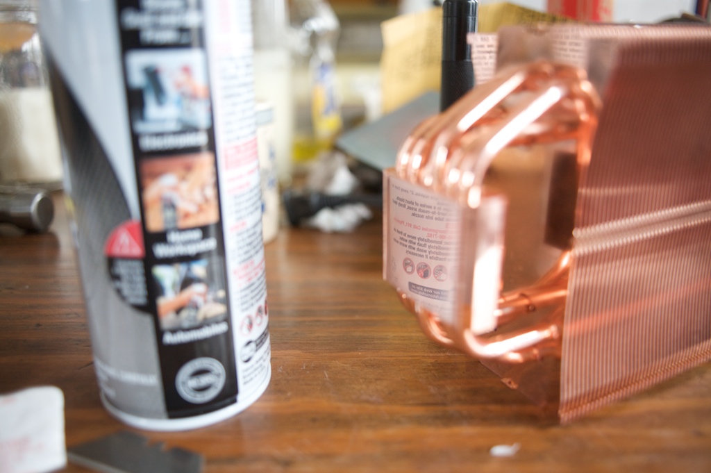

smeared Posted January 26, 2010 Author Share Posted January 26, 2010 Alright, I'm back working on it for the moment, until there are changes from the client. I just finished lapping the thermalright TRUE copper. It came pretty badly convex actually. but only about 6mm from the edge, then the edge actually fell off a little bit. I got it very flat, which I'm proud of because this heat sink weighs a ton, and this was not an easy job.. there was no way I was going to be able to move the heatsink to sand it down, I had to use a small piece of glass and move that very carefully instead. You can see in the photo that right near on the edge it's not perfectly flat, but I'd have had to take another 1mm, if not more, off the whole thing just to get the edge flat, when it's not even going to be contacting the heat spreader. So I just left it. I don't really care about mirror finished, so I stopped at 2000, but it's still got a nice shine to it. Next up is lapping the cpu, and installing my hdd rack. Link to comment Share on other sites More sharing options...

smeared Posted January 29, 2010 Author Share Posted January 29, 2010 So, After about 4 hours of sanding, I'm finally done lapping the CPU. I used about 3 sheets of 220 grit, 3 sheets of 400 grit, and I still couldn't get about a millimeter of the edge flat with the rest. I find that you need to start with a lot of low grit paper to combat intels bulging heat spreader. I gave up after I ran out of sandpaper, but I don't think it's going to effect performance at all. After the low grits I used 600, 800, 1000, 1500, and 2000 to smooth it out. The picture doesn't do it justice. Here is how I ended up modding the top shelf. Holes for the power supply. And I attached the thermaltake hd rack to it. This is the only orientation that would allow me to use the clear plastic door of the g5 case. Also, it's very snug, esp. with the giant video card. With the fan on the right of the hd rack, I have millimeters between it and the video card. but I expect the hd fan to assist with airflow from both the video card, and the power supply.I wanted to almost separate that air flow from the airflow of the cpu. I jb welded nuts on the inside bottom of the hd rack, so that I could tighten the screws, since there was no way I'd fit a wrench in there once the hard drives are in place. Also there is a layer of anti-vibration material between the rack and the shelf. Link to comment Share on other sites More sharing options...
