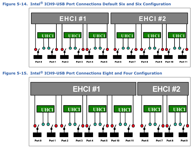

As I said there are 6+1 UHCI devices on ICH10, your dsdt is missing the +1. If I leave that out I get exactly the same symptoms. Take a look at my dsdt, it is the device called US31. And I can confirm that the device type bits are not necessary.
You may want to re-read the Intel datasheet again, and then please pay attention to the following section: "Port-Routing Logic" (see attachments) because the default EHCI setup is "Six and Six" where the extra port, configured at BIOS post, is only used in the "Eight and Four" setup. You must have missed this text: "D26:F2 can be configured as D29:F3 during BIOS Post."
In short: You can remove that port from your DSDT when in the "Six and Six" configuration, which is again the default setup. Do you perhaps have some kind of BIOS setting for this?

You may want to re-read the Intel datasheet again, and then please pay attention to the following section: "Port-Routing Logic" (see attachments) because the default EHCI setup is "Six and Six" where the extra port, configured at BIOS port, is only used in the "Eight and Four" setup. You must have missed this text: "D26:F2 can be configured as D29:F3 during BIOS Post."
You are right, I have no idea where that US31 came from, must have done a copy/paste from someone's dsdt since I don't have that device in my original acpidumps. It was using the address of UHC4 so everything looked like it was working.
