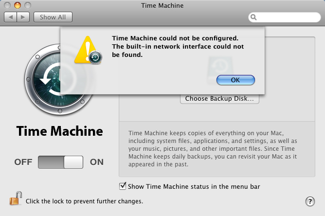

nomis66 Posted August 8, 2009 Author Share Posted August 8, 2009 Just one more thing, now that my Retail disk is working fine I decided to wipe the IDeneb disk and use it for Time Machine, but when I select it in Time Machine setup I get this message. Link to comment Share on other sites More sharing options...
kizwan Posted August 10, 2009 Share Posted August 10, 2009 I suspected that you will see that error. This because your network card is not supported by default. We inject it PCI id (device & vendor id) using legacy kext to make it working. Do you know an application called "EFI Studio"? kizwan Link to comment Share on other sites More sharing options...

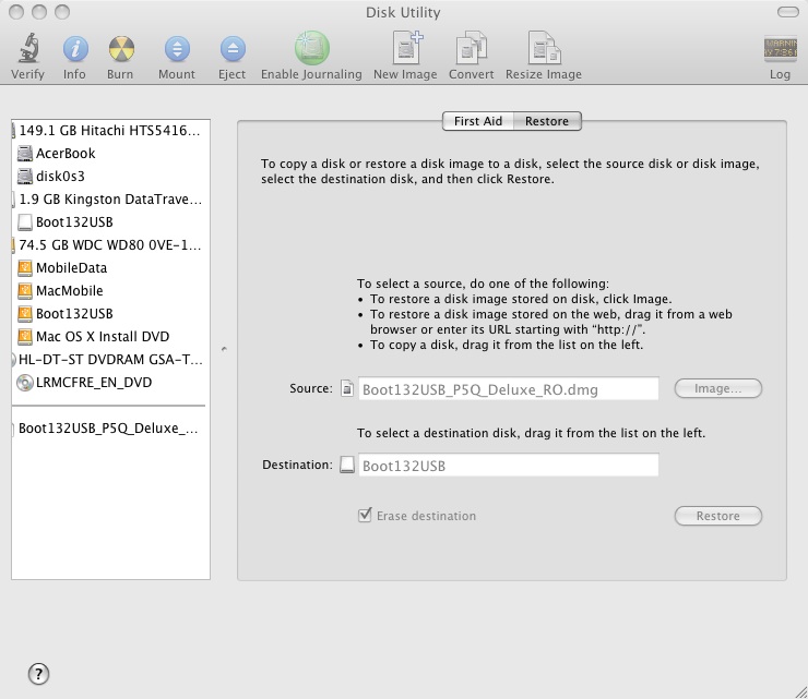

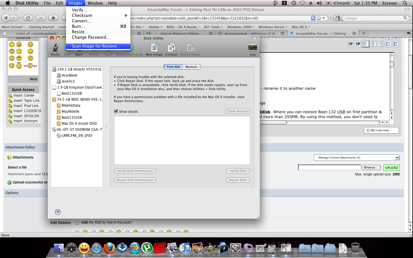

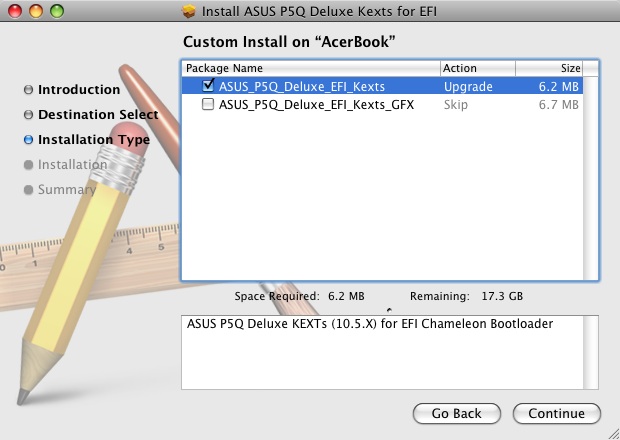

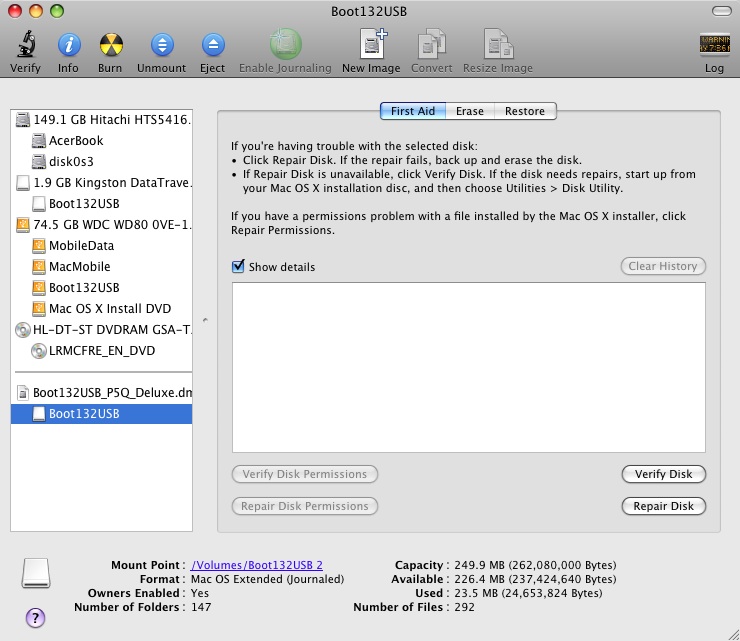

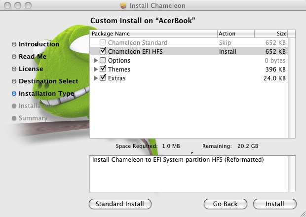

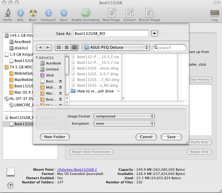

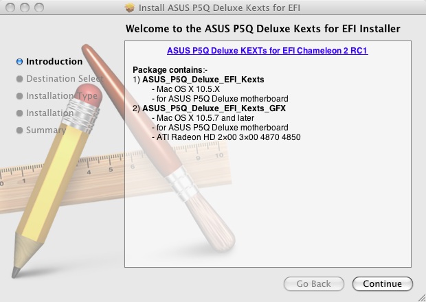

kizwan Posted August 12, 2009 Share Posted August 12, 2009 @nomis66, *HDD = harddisk drive (in case somebody don't know what it means.... ) In this post I have prepared:- 1) Boot-132 USB - give you ability to boot faster using flash drive. 2) EFI bootloader - for HDD with GUID partition table only. ++++++++++++++++++++++++++++++++++++++++++++++++++++++++++++++++++++++++++++++++ Boot-132 USB 1) Boot-132 USB ASUS P5Q Deluxe 2) Boot-132 USB ASUS P5Q Deluxe + ATI Radeon HD 2×00 3×00 4870 4850 - I have mistakenly uploaded Boot-132 USB image with read/write mode. Below is how to change it to the default format so that we can restore it to a flash drive. - How to restore read/write Boot-132 USB image to a flash drive:- 1) Mount the Boot-132 USB image (downloaded from the above link) 2) Open Disk Utility & select the mounted volume 3) Click "New Image" to dump it again with "compressed" format (default format) - rename it to another name 4) Unmount & eject the Boot-132 USB image 5) Now we need to do "Scan Image for Restore..." to the new Boot-132 USB image 6) After the new Boot-132 USB image has been scanned, we can restore it to a flash drive 7) ( WARNING: do this carefully ) Now we need to make the flash drive bootable. To make thing much easier, unplug or eject any other drives except the HDD that contain Mac OS X & the flash drive. We need to do this in Terminal (where rdisk1 is your flash drive):- sudo -s fdisk -f /Volumes/Boot132USB/usr/standalone/i386/boot0 -u -y /dev/rdisk1 dd if=/Volumes/Boot132USB/usr/standalone/i386/boot1h of=/dev/rdisk1s1 2>/dev/null This is OPTIONAL. You can create a slipstream Mac OS X installer using external harddisk. Where you can restore Boot-132 USB on first partition & Mac OS X install DVD on second partition. The first partition for Boot-132 USB don't need more than 250MB. By using this method, you don't need to switch CD when installing Mac OS X, actually no CD involved at all. Please refer to my internal & external harddisk layout where internal is GUID & external is MBR. ++++++++++++++++++++++++++++++++++++++++++++++++++++++++++++++++++++++++++++++++ EFI bootloader - installation for GUID only Please grab Chameleon 2 RC1 installer over here:- http://www.mediafire.com/?l19yfydqoco Follow this simple step-by-step on how to install Chameleon 2 RC1 to EFI partition:- 1) Double-click to launch the Chameleon 2 RC1 installer & you will immediately see this welcome window. Click Continue. 2) (I have skip a couple of unimportant screenshot) When you arrive at this windows, click Customize button. 3) Make sure your selection is similar with this selection. Of course we need to select "Chameleon EFI HFS" because we're using EFI partition to boot Mac OS X. After that click Install. 4) Grab this installer to install all necessary KEXTs file for ASUS P5Q Deluxe to the EFI partition. http://www.mediafire.com/?jjzxgyydymb There are two packages in the installer where the first one is for ASUS P5Q Deluxe while the second one also for ASUS P5Q Deluxe but with additional support for ATI Radeon HD 2×00 3×00 4870 4850. You can only choose one package during installation. The guide is complete now! ++++++++++++++++++++++++++++++++++++++++++++++++++++++++++++++++++++++++++++++++ kizwan Link to comment Share on other sites More sharing options...

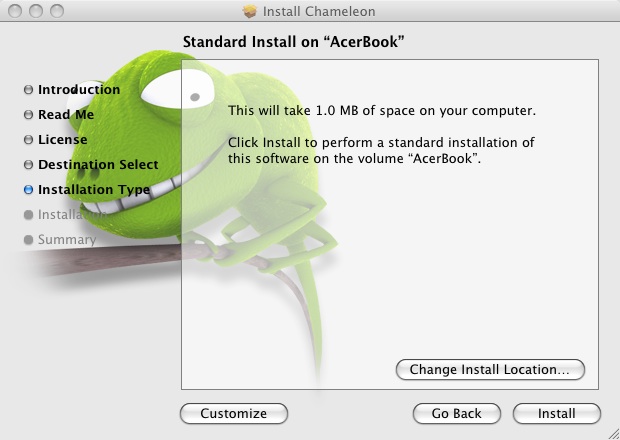

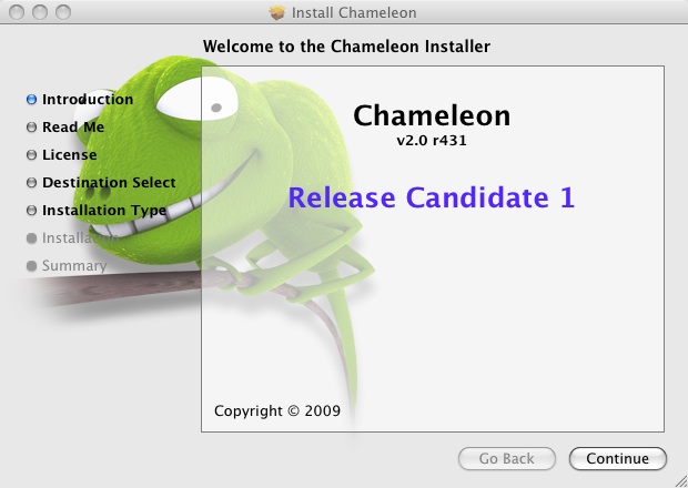

nomis66 Posted August 14, 2009 Author Share Posted August 14, 2009 Actually I just realized that I had to change my Boot Priority to boot from the partition. I'm now able to boot Chameleon - I get the Chameleon start up screen which gives me a choice of HDs to open (Remember I have Leopard on two HD - One for testing purposes) No matter which HD I choose to start from I get the Chameleon/Apple logo but unfortunately the little wheel just keeps on spinning. I've tried it with and without the 132 Rom inserted. Link to comment Share on other sites More sharing options...
kizwan Posted August 14, 2009 Share Posted August 14, 2009 Actually I just realized that I had to change my Boot Priority to boot from the partition. I'm now able to boot Chameleon - I get the Chameleon start up screen which gives me a choice of HDs to open (Remember I have Leopard on two HD - One for testing purposes) No matter which HD I choose to start from I get the Chameleon/Apple logo but unfortunately the little wheel just keeps on spinning. I've tried it with and without the 132 Rom inserted. The Chameleon instruction is not finished yet. So you will not able to boot with EFI partition yet. We still not yet copied all the kexts from Boot-132 to EFI partition. I will come out the instruction later. Please use Boot-132 CD/USB for the time being. ................................................I expanded EFI Studio to the Desktop. When I choose the AZAL drop down it says "AZAL not available on this machine" When I choose Ethernet I'm given the options: Save Hex, Save XML, Hex String to Clipboard and Write to com.apple.Boot.plst. I chose the last option but it doesn't seem to have got TM working. No need to choose AZAL. I just want to show you where it is. We only need to choose Ethernet. You are correct when you choose "Write to com.apple.Boot.plist". I assume you already reboot your computer after doing that, right? I also created a separate partition on my HD (called Chameleon EFI HDS) and installed Chameleon onto that partition (following your instructions) but, although I can see the partition at startup (after pressing 81) it won't let me boot from the partition................................. Do you create the partition manually? Strange because EFI partition automatically created when the HDD formatted using GUID partition table. It is hidden partition. It is not visible in Disk Utility. However, we will be able to mount it via Terminal. As I said earlier, I will come out the instruction later. Please continue to boot using Boot-132 CD/USB. By the way, have you tried Boot-132 USB I prepared for you? It should work like Boot-132 CD. If you have extra external harddisk, you can restore both Boot-132 USB & Mac OS X Install DVD to it. Just format the external HDD with MBR partition & create two partition where the first one just 200MB. Please refer to post #63 to understand what I'm saying. Link to comment Share on other sites More sharing options...
