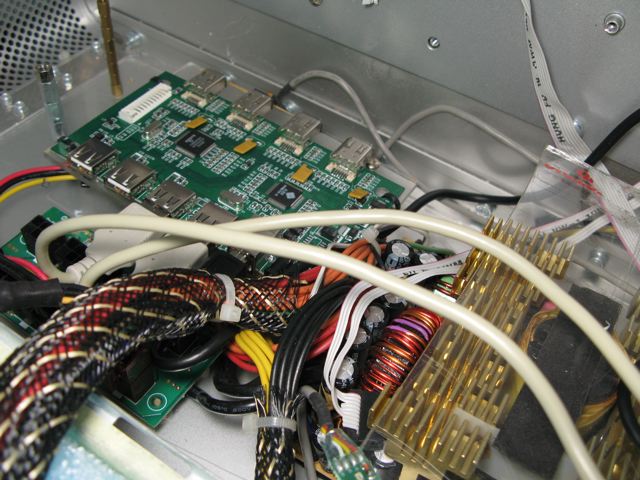

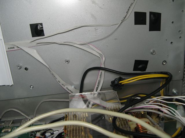

- Add a hybrid USB2/Firewire hub internally, in the power supply area, so that I can only use one USB and one FW internal plugs and all the ports of the case will be perfectly working without cluttering wires and cables.
- Add a hard drive bracket in the front part. Not sure whether to add a 3.5" or a 2.5" for SSD drives, I'll see about that!

AUGUST UPDATE:
I'm (finally) going holidays tomorrow, and will bring my Fluff with me.
I intend to add a RAID rack and a hybrid hub to remove once and for all the cable clutter behind the motherboard. I will also redo the internal wiring using better and thicker shielded cables to avoind electric noise and all.
In september I also decided to order a custom aluminium grill to place on the raid rack and processor, i just need to figure it out how to use the blasted 3d program for the blueprints :D

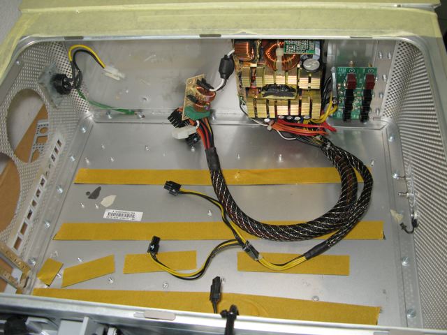

Well, there are 2 versions of the G5 case, the PCI64 and the PCI-E one. I have the latter, and that one uses a small 4-pin cable, that was very easily adapted to fit into one fo the power sockets of my power supply.
The PCI64 version has a special connector, you can make a customised and perfectly fitting cable by cutting up a normal ATX power connector using the 6 (was it 6 or 8?) matching holes. I did so with my first G5 case and worked perfectly.
Hope that helps!

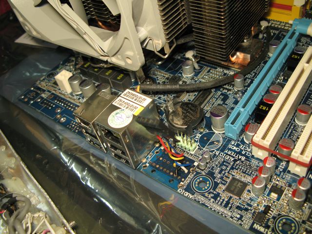

At the moment I am removing the useless connectors on my motherboard. By doing so I am ensuring more space and less clutter inside the case.
Attached File  DSC00095.JPG   209.11KB   152 downloads

Hey Torque,
How are you removing the sockets? I have done it before with a soldering iron, but I always worry that that will overheat the board. Perhaps I need a higher wattage soldering iron so I don't have to leave it on the board for so long.

Here come the pics :
connecting the two PCI64 plugs onto the ATX mobo plug with plastic piece above skipping the middel connectors and leaving the last connectors free :
Posted Image
Posted Image
Now, just cut the wires and solder with cables connected with two molex
It's not easy at all. I use a professional soldering gun with a very tiny incandescent needle that melts the lead around the pin, and with another tool I suck it out before it hardens again. (and I swear to gawd no pun intended at all in this last and very ambiguous statement! :D )

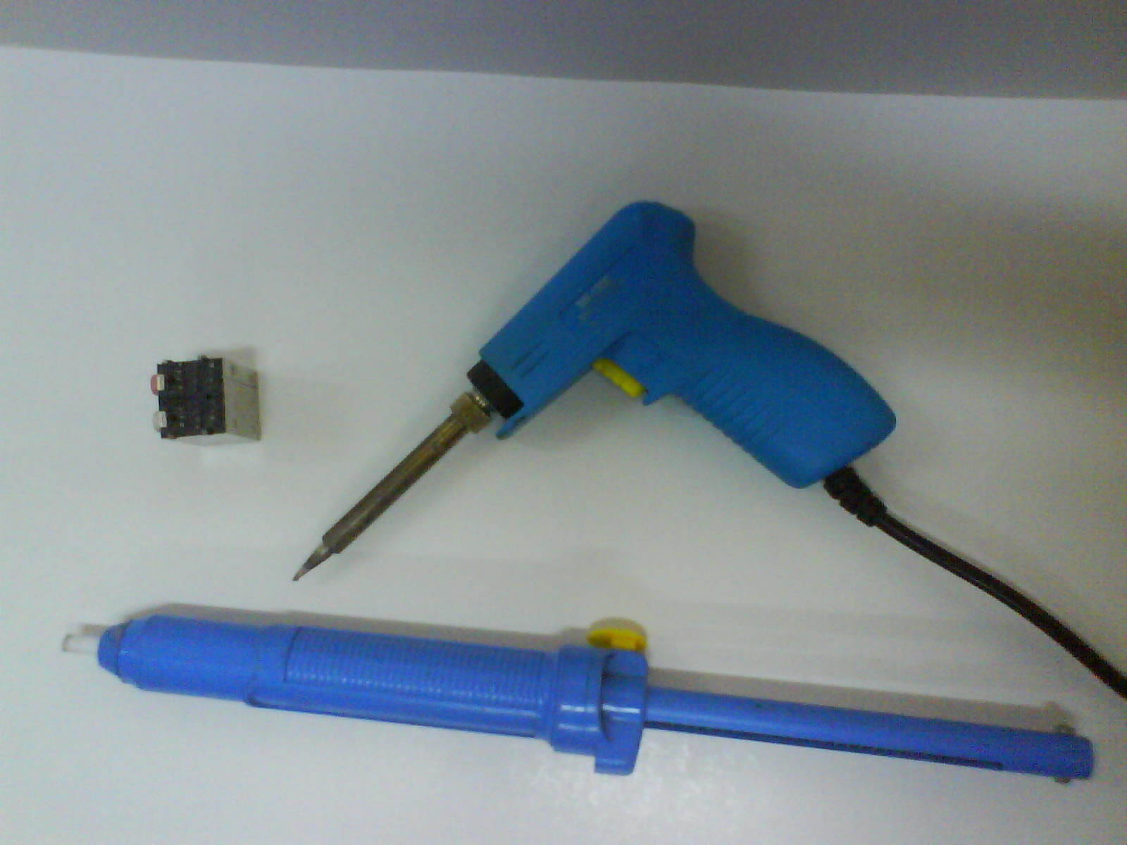

Ha Ha, yes, that could be misconstrued! I don't suppose you could find a similar pic to your soldering iron? I am in the market for a new one and have been wondering what to get. Thanks for your trouble.
There you go buddy. The beast heats way more and way better than its relatively mild and anonymous appearance suggests... The other tool is the sucker that removes instantly the molten lead.

Thanks Torque,
That certainly looks more serious than the iron I've been using. Now I have a better idea of what get, I like the solder removal tool to, will definitely give that a go. Thanks for your time!

The other tool is absolutely indispensable if you want to remove I/O on your motherboard... If the molten lead moves a nanometre to the left or to the right it might hit a condenser or something and make it completely unusable...
