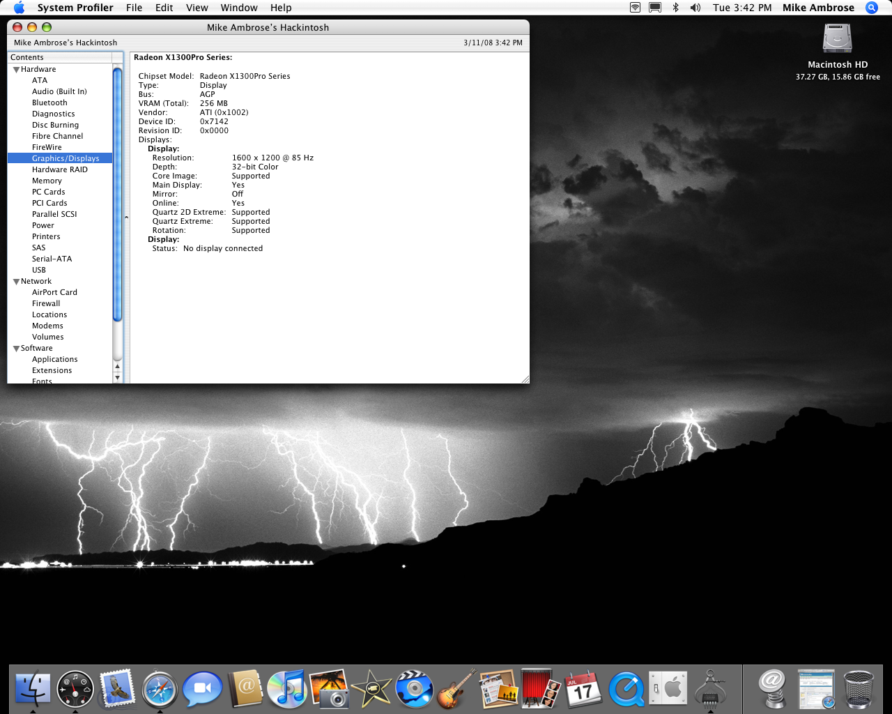

Slinger2g Posted March 11, 2008 Share Posted March 11, 2008 The title say's it all. Yes, I have an X1300 using AGP instead of the so common Bus:PCI in system profiler. check out the screeny. :::NOTE::: You will have to edit IONameMatch with your chipset Dev/Pro ID's ~Sling P.S. This DOES NOT support PCI-E P.S.S. This should work with any AGP graphic's card. AppleI386PCI.kext.zip Link to comment https://www.insanelymac.com/forum/topic/92961-ati-radeon-x1300-using-agp-bussuccess/ Share on other sites More sharing options...

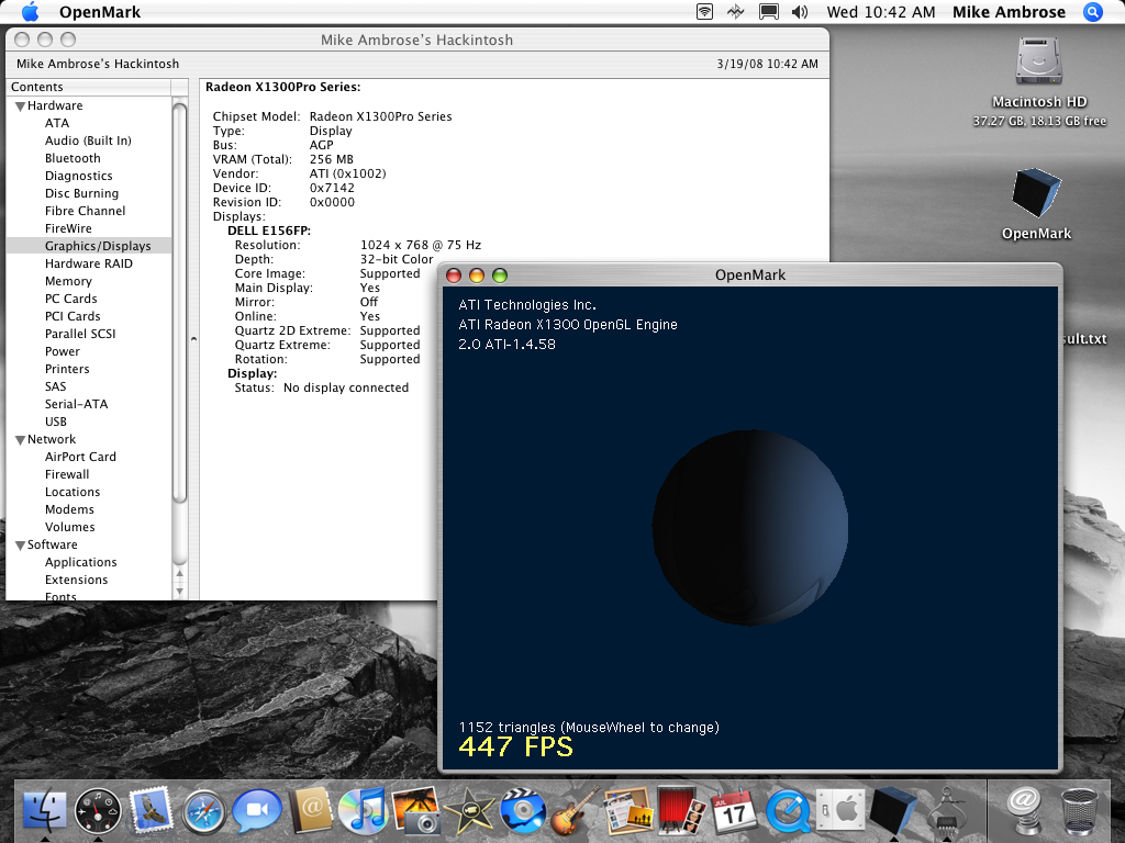

Slinger2g Posted March 19, 2008 Author Share Posted March 19, 2008 Here are the Openmark benchmarks..... And a screenshot for proof. ~Sling P.S. This platform is an SSE2 build. :EDIT: Please merge the two post's into one and delete the earliest post. Thank's OpenMark_result.txt Link to comment https://www.insanelymac.com/forum/topic/92961-ati-radeon-x1300-using-agp-bussuccess/#findComment-673535 Share on other sites More sharing options...
riws Posted March 21, 2008 Share Posted March 21, 2008 w AGPGart vs w/o AGPGart ? Run the Benchmark in OpenMark Link to comment https://www.insanelymac.com/forum/topic/92961-ati-radeon-x1300-using-agp-bussuccess/#findComment-676875 Share on other sites More sharing options...
Slice Posted March 21, 2008 Share Posted March 21, 2008 Here are the Openmark benchmarks..... And a screenshot for proof. ~Sling P.S. This platform is an SSE2 build. :EDIT: Please merge the two post's into one and delete the earliest post. Thank's Congratulations! It is really that I want to see. In your text result FPS=900 but on screenshot =400. I had the same effect until I change IOPCIFamily to my version (2.4.4). Now FPS don't drop down during screenshot. And many question: What versions of ATI drivers are you use? Additional drivers or replaces? What is your aperture address and size set by AppleI386PCI? Can you upload your ioreg (ioreg -l -x -w 2048)? Can you test, please, my AGPGart with the same aperture? Link to comment https://www.insanelymac.com/forum/topic/92961-ati-radeon-x1300-using-agp-bussuccess/#findComment-677009 Share on other sites More sharing options...

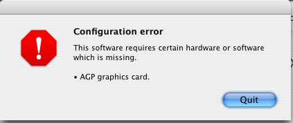

Slice Posted April 11, 2008 Share Posted April 11, 2008 You need to do an ioreg in terminal and find what the pci io name match is for your PCI to PCI bridge.If you can't find it just post your ioreg dump in this thread and I will tell you what it is.~SlingSlice, if you want to change value's of the kext I posted, feel free. I am not aiming toward's direct programming value's as my only intent was to have the kext do what it is supposed to do. Read and Direct Bus information.~Sling Your method in already known as AGPLight. AGP in system profiler and possibility to launch Final Cut Pro but no boost performance Link to comment https://www.insanelymac.com/forum/topic/92961-ati-radeon-x1300-using-agp-bussuccess/#findComment-705573 Share on other sites More sharing options...
