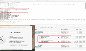

gils83 Posted January 2, 2015 Share Posted January 2, 2015 @verdant I had already tried previously with these versions of chameleon, but it was the same, the CPU problem, it worked perfectly with Clover, the more complicated with clover is to find the right settings. it would be much easier with a core2duo. the addition of the AMD kernel a bit more complicated history. I remain serene and I will soon come to the point. Link to comment https://www.insanelymac.com/forum/topic/86454-via-vt8237r-plusvt8237a-southbridge-chipset-any-drivers/page/2/#findComment-2099810 Share on other sites More sharing options...
gils83 Posted January 2, 2015 Share Posted January 2, 2015 non de zeus !!! la carte mère est compatible Yosemite !! l'utilisation d'un core2duo sera plus simple !! le vieux Pentium m'a donné du fil à retordre !! plus (+) que la carte mère !!! le mode installation est possible comme sur les autres modèles plus récentes , les chipset VIA ont encore une longue vie devant eux !!.......... je vais m'occuper du réseau maintenant le chameleon utilisé est la version 2391 , j'ai laissé tomber Clover , trop de problèmes avec les satas . le dossier E/E est valable pour ML 10.8 / M 10.9 et Yosemite 10.10 not Zeus !!! the motherboard is compatible Yosemite !! the use of a core2duo be easier !! the old Pentium gave me a hard wire !! plus (+) that the motherboard !!! mode installation is possible as the more recent models, the VIA chipset still have a long life ahead of them !! .......... I'll take care of the network now the chameleon used is 2391 version, I dropped Clover, too many problems with Satas. the file I / E is for 10.8 ML / M 10.9 and 10.10 Yosemite . 1 Link to comment https://www.insanelymac.com/forum/topic/86454-via-vt8237r-plusvt8237a-southbridge-chipset-any-drivers/page/2/#findComment-2099848 Share on other sites More sharing options...

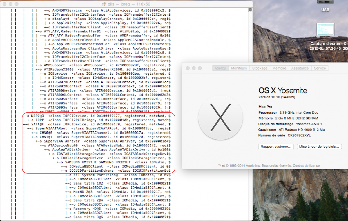

verdant Posted January 2, 2015 Share Posted January 2, 2015 @ gils83 Older BIOS-based MOBOs like Chameleon....... It shows from your IOReg output that the SuperVIAATA.kext is used. What about AppleVIAATA_x64.kext.........? Link to comment https://www.insanelymac.com/forum/topic/86454-via-vt8237r-plusvt8237a-southbridge-chipset-any-drivers/page/2/#findComment-2099873 Share on other sites More sharing options...
gils83 Posted January 2, 2015 Share Posted January 2, 2015 yes indeed, the bios is very old and does not support Clover. I have another old motherboard Asus S 939 / 3200+ with the same VIA chipset, I will try Yosemite. Link to comment https://www.insanelymac.com/forum/topic/86454-via-vt8237r-plusvt8237a-southbridge-chipset-any-drivers/page/2/#findComment-2099876 Share on other sites More sharing options...
verdant Posted January 2, 2015 Share Posted January 2, 2015 @ gils83 AFAIK the SuperVIAATA.kext I PM'd you is from here but also try the AnV version.... How many working MOBOs do you have.......? Link to comment https://www.insanelymac.com/forum/topic/86454-via-vt8237r-plusvt8237a-southbridge-chipset-any-drivers/page/2/#findComment-2099880 Share on other sites More sharing options...
gils83 Posted January 2, 2015 Share Posted January 2, 2015 @ gils83 Older BIOS-based MOBOs like Chameleon....... It shows from your IOReg output that the SuperVIAATA.kext is used. What about AppleVIAATA_x64.kext.........? @verdant I struggle to see if AppleVIAATA_x64.kext.est well mounted, I would have moved into the S / L / E to see its action in E / E I can not see I boot with kext-dev-mode = 1, in all cases when loading the kext is present. @ gils83 AFAIK the SuperVIAATA.kext I PM'd you is from here but also try the AnV version.... How many working MOBOs do you have.......? Yes , is SuperVIATA.kext PM but without ioatafamily.kext in E/E , the system no boot . stlil........bla.......bla I will remove the kext one by one to see which one really works Link to comment https://www.insanelymac.com/forum/topic/86454-via-vt8237r-plusvt8237a-southbridge-chipset-any-drivers/page/2/#findComment-2099881 Share on other sites More sharing options...
verdant Posted January 2, 2015 Share Posted January 2, 2015 In Terminal run: kextstat | grep -v com.apple which should show any 3rd Party kexts loaded in the kernel 1 Link to comment https://www.insanelymac.com/forum/topic/86454-via-vt8237r-plusvt8237a-southbridge-chipset-any-drivers/page/2/#findComment-2099883 Share on other sites More sharing options...
gils83 Posted January 2, 2015 Share Posted January 2, 2015 In Terminal run: kextstat | grep -v com.apple which should show any 3rd Party kexts loaded in the kernel ok, I'll let you know Link to comment https://www.insanelymac.com/forum/topic/86454-via-vt8237r-plusvt8237a-southbridge-chipset-any-drivers/page/2/#findComment-2099887 Share on other sites More sharing options...
gils83 Posted January 2, 2015 Share Posted January 2, 2015 En conclusion , c'est bien SuperVIATA.kext qui travaille mais seul il ne fonctionne pas , il faut impérativement ioatafamily.kext patché , 2 kexts permettent de voir fonctionner les sata 1.0 et l'AHCI manquant VIA . l'audio fonctionne avec voodooHDA 2.8.4/5 (Slice and Andy) le réseau s'avère plus complexe . In conclusion, it is SuperVIATA.kext working but alone it does not work, it is imperative ioatafamily.kext patched, 2 kexts allow to see and operate the SATA AHCI 1.0 VIA missing. Audio works with VoodooHDA 2.8.4 / 5 (Slice and Andy) the network is more complex. Last login: Fri Jan 2 11:01:25 on console Mac-Pro-de-gils:~ gils$ kextstat | grep -v com.apple Index Refs Address Size Wired Name (Version) <Linked Against> 13 0 0xffffff7f80b3c000 0x2000 0x2000 org.tgwbd.driver.NullCPUPowerManagement (1.0.0d2) <7 4 3> 31 0 0xffffff7f80c89000 0xb000 0xb000 org.netkas.FakeSMC (3.3.1) <10 7 5 4 3> 38 0 0xffffff7f80d5a000 0xe000 0xe000 com.c0rk007hck.SuperVIAATA (1.0.3) <33 11 5 4 3> No ACPI version 2 found. Ignoring Read HFS+ file: [hd(1,4)/Extra/Extensions/FakeSMC.kext/Contents/Info.plist] 4688 bytes. Read HFS+ file: [hd(1,4)/Extra/Extensions/IOATAFamily.kext/Contents/Info.plist] 1260 bytes. Read HFS+ file: [hd(1,4)/Extra/Extensions/IOATAFamily.kext/Contents/PlugIns/AppleIntelPIIXATA.kext/Contents/Info.plist] 17728 bytes. Read HFS+ file: [hd(1,4)/Extra/Extensions/IOATAFamily.kext/Contents/PlugIns/IOATABlockStorage.kext/Contents/Info.plist] 1739 bytes. Read HFS+ file: [hd(1,4)/Extra/Extensions/IOATAFamily.kext/Contents/PlugIns/IOATAPIProtocolTransport.kext/Contents/Info.plist] 2112 bytes. Read HFS+ file: [hd(1,4)/Extra/Extensions/NullCPUPowerManagement.kext/Contents/Info.plist] 1498 bytes. Read HFS+ file: [hd(1,4)/Extra/Extensions/SuperVIAATA.kext/Contents/Info.plist] 3608 bytes. Extensions.zip 1 Link to comment https://www.insanelymac.com/forum/topic/86454-via-vt8237r-plusvt8237a-southbridge-chipset-any-drivers/page/2/#findComment-2099935 Share on other sites More sharing options...

Andy Vandijck Posted January 3, 2015 Share Posted January 3, 2015 New version for Yosemite optimized: http://www.insanelymac.com/forum/topic/303722-superviaata-105-for-yosemite/ This one should work without patched IOATAFamily... 1 Link to comment https://www.insanelymac.com/forum/topic/86454-via-vt8237r-plusvt8237a-southbridge-chipset-any-drivers/page/2/#findComment-2100218 Share on other sites More sharing options...
