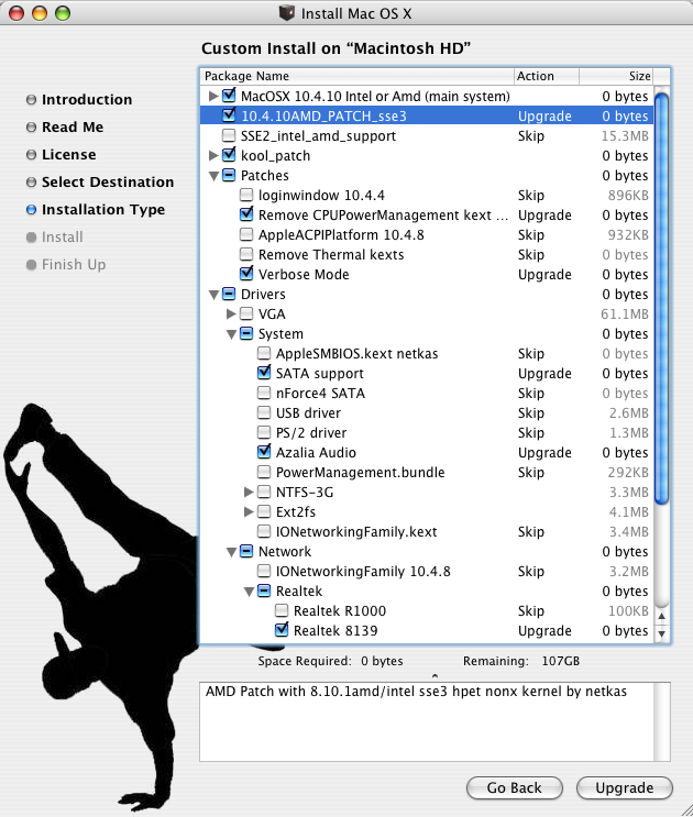

the very BEGIN of R20 installation:
Default installation options
KalyWay 10.4.10 (config image attached)
- Macosx 10.4.10 (cool main system)
- AMD_PATCH_sse3
- kool_patch (all)
- patches (remove CPUManagement, verbose mode)
- drivers (System: SATA support, Azalia audio; Network: Realtek: 8139)

Does any one know how to get the trackpad scroll function to work
no joy with graphics yet
could it be possible that the garbled screen could be down to the timings and other settings in the plist.
the problem is i dont have a clue where in the plits these values are or what they should be.
i mite try katana as i only want the correct resolution but i have reinstalled my system so many times
southbridge fix causes AppleLPC::start - RCBA not enabled error on boot
i can not find any reference to what this means, but the system boots fine. After southbridge fix on 2nd boot sound is disabled.
battery indicator works fine, sound and wifi worked without any addtional tweaks needed.
ACPI/PowerManagement deafult install coruptted my OS X86 and uninstaller did not work. may try again but install kext only.
My main issue is i can not get sleep mode to function.
i can live without everything else but i need sleep
has any one else experienced this issue
Hello, I don't know why I find this topic too late like this... This topic will be awsome one to me.
I have Samsung R20 Plus (NT-R20F/180)
My spec is completely same as you guys'.
Unfortunately, I don't have much time in this week... I am gonna try this great solution in this weekend and I'm gonna feedback the result!
Thanks and I am sorry about not be able to help you until weekend.
P/S. I am korean user so I cannot use English as well as you do. If you don't understand what I am saying, please ask me like this. "What did you mean? I don't understand because of your English skill."
welcome on board Nucleus
the port on R20 is not finished yet, so you didn't missed much
post your results and get ready for future QA activities!

Hola amigos, (Un saludo a toda la peña, soy un nuevo usuario que intenta conocer el mundo "MAC" )
He usado la version "OSx86 v10.4.10 Installer v1.1 de Kalyway" para mi Samsung R20 siguiendo las instrucciones del hilo http://forum.insanelymac.com/index.php?showtopic=86094 y la instalacion se ha completado sin problemas. Sin embargo, al reiniciar cuando carga Darwin y elijo la particion donde lo he instalado (Particion primaria) empieza a cargar el sistema y al rato me arroja el mensaje de "still waiting for root device".
En el mismo hilo que mensiono arriba otro usuario que ha tenido el mismo problema comenta que ha tenido que agregar el ID del disco SATA para que sea reconocido por el sistema.
i need mac money dice :
"I have kalyway 10.4.10 working on the R20
I had to add the correct device id and vendor ID to AppleVIAATA.kext and AppleACHIPort.kext to get os x to recognize my hard drive.
installed and functioning
only after editing the id for the sata controller as it was not detecting my hard drive"
Ya tengo el ID de mi disco (PCI\VEN_1002&DEV_4380) = 0x43801002 pero no se como editar esos archivos.
¿Alguno de vosotros me puede hechar una mano con esto?
¿Se puede hacer esta modificacion desde WinXP o Linux?
Agradezco de antemano vuestras respuestas.
Saludos
--maelva
PD: He usado primero que nada la busqueda del foro y luego "san google" pero no tengo nada claro ya que no hay un caso especifico de esta modificacion, ademas aun no tengo un sistema "MAC" operativo para poder usar un editor.
EDITADO:
(Solucionado) ...he logrado agregar el ID de mi SATA y arranca sin problemas.
Saludos.
(Now I also have kalyway 10.4.10 working on the R20)
--maelva
