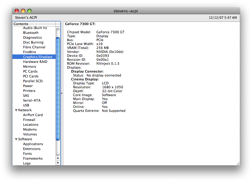

cipherworld Posted December 12, 2007 Share Posted December 12, 2007 Hi all, I need help to get my XFX 7300GT 512MB graphic card to support Q/E. I put a BrazilMac copy of Leo and installed 0.1.5 NVinject patch (cp -r to Extension) but I still got black screen at start and have to use -x to boot into system. Please help!! Link to comment https://www.insanelymac.com/forum/topic/75910-need-help-with-xfx-7300gt/ Share on other sites More sharing options...

elton926 Posted December 13, 2007 Share Posted December 13, 2007 Did you edit the other kexts? copying over nvinject isn't the only thing you need to do. There are three.- Geforce.kext - - NVDANV40HAL.kext -- NVDAResman.kext -you need to add your device ID to each. There's a great posting in this forum detailing what you need to do. check it out. no one Or I need to flash the Rom first?flashing the rom will allow you to display 512MB instead of 256MB. Link to comment https://www.insanelymac.com/forum/topic/75910-need-help-with-xfx-7300gt/#findComment-536634 Share on other sites More sharing options...
