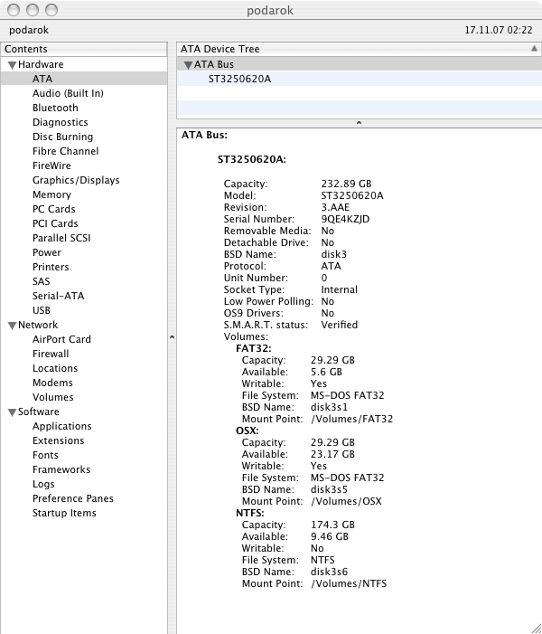

podarok Posted November 17, 2007 Share Posted November 17, 2007 Really good day! After making SATA fully working I using the same method add support for Marvell 88SE61xx onboard PATA controller and make it possible to use it in Tiger Patch in my signature My system is Tiger 10.4.11 Installation only for P5K-SE with pci id`s 0x29268086 and 0x29218086 and Marvell Id 0x612111ab Installation 1. Revert any kext patches for your SATA and PATA chipset 2. Install kext from attachement against current in your system 3. Fix permissions using Dusk Utility 4. Remove file:///System/Library/Extensions.kextcache and file:///System/Library/Extensions.mkext 5. Reboot and post bugs here Good luck!!! Link to comment https://www.insanelymac.com/forum/topic/71812-p5k-se-ich9-sata-marvell-88se61xx-pata-patch/ Share on other sites More sharing options...
