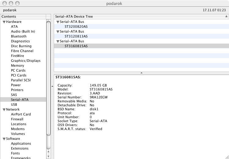

podarok Posted November 16, 2007 Share Posted November 16, 2007 Good day Guys I braking my brain but can`t patch ApplePIIXATA kext sources cause we need many work for supporting SATA channels 3 and 4 for ICH9 But using AppleVIAATA kext I add some code and make it possible to use 1 2 3 and 4 channels 8))) This is the shot for working channels Patch is for Tiger 10.4.* Patch U can install from website in my signature Installation only for P5K-SE with pci id`s 0x29268086 and 0x29218086 1. Revert any kext patches for your SATA chipset 2. Install kext from attachement against current in your system 3. Fix permissions using Dusk Utility 4. Remove file:///System/Library/Extensions.kextcache and file:///System/Library/Extensions.mkext 5. Reboot and post bugs here Other id`s will be added in feature after a good status for this motherboard Good Luck!!! And for adding support for others ICH9 psi ID`s please post for me your real ID`s (not heared elsewhere) Link to comment https://www.insanelymac.com/forum/topic/71803-p5k-se-ich9-all-channels-patch-enchaced-mode-in-bios/ Share on other sites More sharing options...
