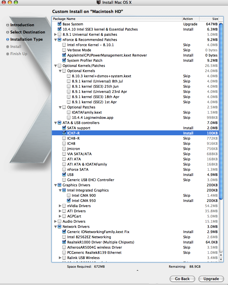

OSXtotheZ Posted November 2, 2007 Share Posted November 2, 2007 I finally got my 10.4.10 macdotnub install working and booting properly. Here is my set up • Intel 945GNTLR motherboard • 4gb of DDR2 • Pentium 940D • 200gb SATA • DriveDVD-RW IDE Drive If you'd like to see what options I checked unchecked see screen cap below. Also One thing I did that I think helped was to do a clean format/partition using the diskutil off the macdotnub installer I selected partition and set to 1 and then option MBR. On the ECS board it cause it to go from blinking cursor at boot to kernel panic which is an improvement if you ask me. *Note I tried same install in ECS 945GCT with Core2duo E6320 and I got Kernel Panic on reboot. Install went fine and -v reboot says Unresloved Kernel Trap...blah blah Backtrace terminated-invalid frame pointer. Gonna try different kernels see if it fixes. Oh I should note some things that needed fixing. • Sound-- fixed with older AppleHDA.kext from previous 10.4.6 install • Networking-- fixed with IONETWORKING.kext previous 10.4.6 install • System Profiler reports some wrong or missing info like Ram is not accurately reported • Core and QE are good. Link to comment https://www.insanelymac.com/forum/topic/68393-os-x-10410-installed-but-will-not-boot/#findComment-491307 Share on other sites More sharing options...
