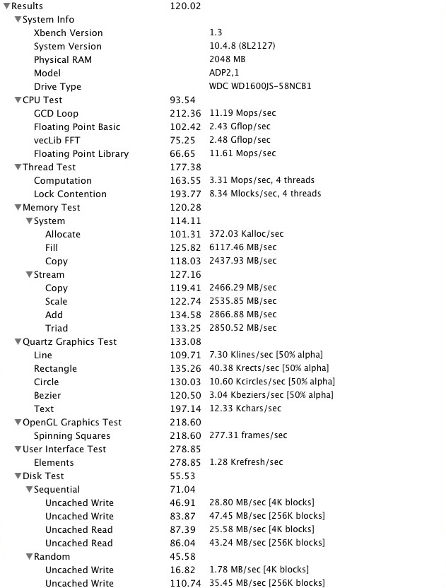

michaspoli Posted May 29, 2007 Share Posted May 29, 2007 Can you post a Xbench Log of this system , please? Thanks Link to comment https://www.insanelymac.com/forum/topic/52459-asus-p5gz-mx-perfect-match-with-e4300/#findComment-374540 Share on other sites More sharing options...
moarfish Posted May 29, 2007 Author Share Posted May 29, 2007 Ok Attached the screenshot of Xbench. 120.02 marks Link to comment https://www.insanelymac.com/forum/topic/52459-asus-p5gz-mx-perfect-match-with-e4300/#findComment-374692 Share on other sites More sharing options...
