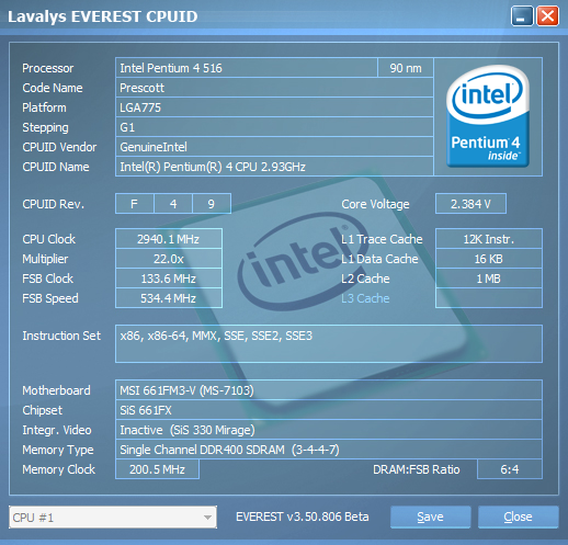

nicknowsky Posted May 8, 2007 Author Share Posted May 8, 2007 Check out the .png I attached 160 SATA and various IDE HDs Nvidia geforce fx 5200 128 AGP Link to comment Share on other sites More sharing options...
Oracle67 Posted May 8, 2007 Share Posted May 8, 2007 nForce chipset and sata HDD is not the best compination, IDE works most of times. Try to instal on IDE HDD primary master, dvdDrive slave, SMART disabled from bios. Link to comment Share on other sites More sharing options...
