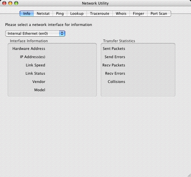

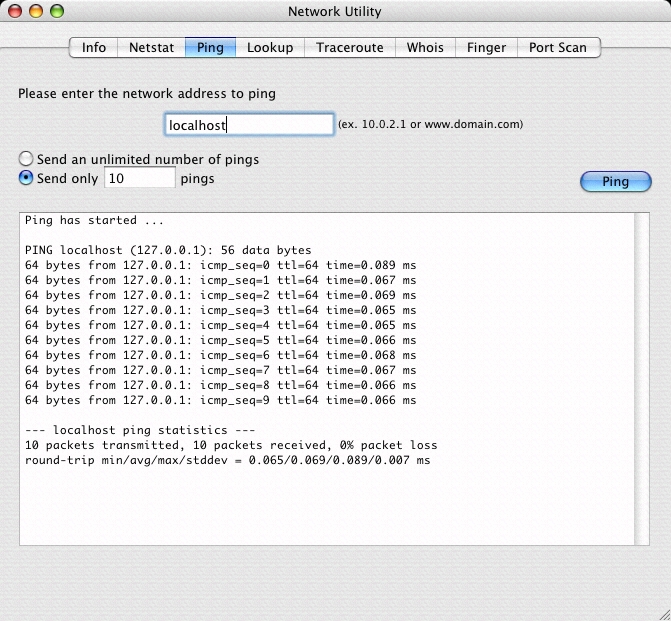

zazman Posted November 24, 2005 Share Posted November 24, 2005 Hello, I've seen that the NETGEAR FA310 TX ethernet card has been updated on the wiki (unsupported hardware/ethernet) so digital chip on some FA310TX seems to be supported How can i know if mine as a digital chipset ? In the supported hardware wiki : "FA310 - uses built in DEC 21xx4 driver (specifically "digital" chip) " FA310 and FA310 TX same chipset ? uses built in DEC 21xx4 driver : by default into OSX86 10.4.1 ? lauched at startup ? i've not see any extention seems to DEC driver runnig on my system. Could you help me please about this ? I made tests yesterday Here they are : I have currently no high speed connection at home, so the only way to test it is to lauch a ping to localhost. As the ping is responding, i am wondering if this card is (partially) supported by osx86 on my system. My system : UPDATED : i miss to say an important thing : I need to boot with platform=X86PC to make OSX86 10.4.1 running on my system... Mobo ASUS P4B266 Intel P4 Northwood 2,4 Ghz at 2,65 Ghz Mushkin PC 2100 SD-RAM 2x256 Mo high speed memry HD Maxtor 6Y080P0 ATA 80 Go ATI radeon 7500 AGP 1024x768x32 at 60 Hz (openGL works/no QE) coreaudio with CMI8738 mobo chipset /added CMI8738 extension driver from Dogbert (no input, but out ok) STaudio DSP24 pci sound card not working (tried ppc native STaudio OSX driver) HSF SOFTMODEM not recognized /not working DVD RW PIONEER DVR 107D (Apple shipped/supported) NETGEAR FA310 TX pci ethernet card... without driver installed / no hardware address found. What the system profiler says about it : Built-in Ethernet: Type: Ethernet Hardware: Ethernet BSD Device Name: en0 IPv4: Configuration Method: DHCP IPv6: Configuration Method: Automatic Proxies: FTP Proxy Enabled: No FTP Passive Mode: Yes Gopher Proxy Enabled: No HTTP proxy Enabled: No HTTPS Proxy Enabled: No RTSP Proxy Enabled: No SOCKS Proxy Enabled: No what the network system panel says : (i can't make built-in Ethernet on into this panel : stay inactive) what the network utility says (no hardware address found) Test ping to localhost : OK NETWORK UTILITY : NETSTAT Routing tables Internet: Destination Gateway Flags Refs Use Netif Expire 127 localhost UCS 0 0 lo0 localhost localhost UH 4 1656 lo0 224.0.0/4 localhost UCS 1 0 lo0 224.0.0.251 localhost UHW 1 25 lo0 Internet6: Destination Gateway Flags Netif Expire localhost link#1 UHL lo0 jfs-computer.local Uc lo0 jfs-computer.local link#1 UHL lo0 ff01:: localhost U lo0 ff02::%lo0 localhost UC lo0 multicast information No IPv4 multicast routing compiled into this system. IPv6 multicast forwarding: 0 multicast forwarding cache lookups 0 multicast forwarding cache misses 0 upcalls to mrouted 0 upcall llueue overflows 0 upcalls dropped due to full socket buffer 0 cache cleanups 0 datagrams with no route for origin 0 datagrams arrived with bad tunneling 0 datagrams could not be tunneled 0 datagrams arrived on wrong interface 0 datagrams selectively dropped 0 datagrams dropped due to llueue overflow 0 datagrams dropped for being too large state of all current sockets connections Active Internet connections (including servers) Proto Recv-Q Send-Q Local Address Foreign Address (state) tcp4 0 0 localhost.ipp *.* LISTEN tcp4 0 0 localhost.netinfo-loca localhost.1019 ESTABLISHED tcp4 0 0 localhost.1019 localhost.netinfo-loca ESTABLISHED tcp4 0 0 localhost.netinfo-loca localhost.1021 ESTABLISHED tcp4 0 0 localhost.1021 localhost.netinfo-loca ESTABLISHED tcp4 0 0 localhost.netinfo-loca *.* LISTEN udp4 0 0 *.ipp *.* udp4 0 0 *.mdns *.* udp6 0 0 *.5353 *.* udp4 0 0 *.mdns *.* udp4 0 0 *.* *.* udp4 0 0 localhost.netinfo-loca *.* Active LOCAL (UNIX) domain sockets Address Type Recv-Q Send-Q Inode Conn Refs Nextref Addr c17b3220 stream 0 0 c1ff2528 0 0 0 /private/var/run/cupsd c17b3660 stream 0 0 0 c17b3cc0 0 0 /var/run/mDNSResponder c17b3cc0 stream 0 0 0 c17b3660 0 0 c17b3770 stream 0 0 c1a04a50 0 0 0 /var/run/pppconfd c17b3990 stream 0 0 c1991210 0 0 0 /var/run/mDNSResponder c17b3880 stream 0 0 c19918c4 0 0 0 /var/run/asl_input c17b3d48 stream 0 0 c1987084 0 0 0 /var/run/portmap.socket c17b3ee0 stream 0 0 0 0 0 0 c17b3f68 stream 0 0 c17ac4a4 0 0 0 /var/launchd/0/sock c17b32a8 dgram 0 0 0 c17b37f8 0 c17b33b8 c17b33b8 dgram 0 0 0 c17b37f8 0 c17b3440 c17b3440 dgram 0 0 0 c17b37f8 0 c17b34c8 c17b34c8 dgram 0 0 0 c17b37f8 0 c17b36e8 c17b3550 dgram 0 0 0 c17b35d8 c17b35d8 0 c17b35d8 dgram 0 0 0 c17b3550 c17b3550 0 c17b36e8 dgram 0 0 0 c17b37f8 0 c17b3908 c17b3908 dgram 0 0 0 c17b37f8 0 c17b3c38 c17b3c38 dgram 0 0 0 c17b37f8 0 c17b3b28 c17b3b28 dgram 0 0 0 c17b37f8 0 c17b3bb0 c17b3bb0 dgram 0 0 0 c17b37f8 0 0 c17b3a18 dgram 0 0 0 c17b3aa0 c17b3aa0 0 c17b3aa0 dgram 0 0 0 c17b3a18 c17b3a18 0 c17b37f8 dgram 0 0 c19917bc 0 c17b32a8 0 /var/run/syslog c17b3dd0 dgram 0 0 0 c17b3e58 c17b3e58 0 c17b3e58 dgram 0 0 0 c17b3dd0 c17b3dd0 0 What do you think about ? Thanks a lot ZAZMAN Link to comment https://www.insanelymac.com/forum/topic/4807-netgear-fa310tx-ethernet-card-working/ Share on other sites More sharing options...

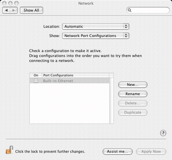

zazman Posted November 24, 2005 Author Share Posted November 24, 2005 thanks for your post. you say : "The ones with the "d.i.g.i.t.a.l" chipsets are recognized as "built in ethernet." The ones that don't have "digital" are not. Looks like you don't have one." Hows looks like mine ? Where should it be recognized as built-in internet ? My system profiler says at network/built-in internet/ : Type: Ethernet Hardware: Ethernet BSD Device Name: en0 IPv4: Configuration Method: DHCP IPv6: Configuration Method: Automatic Proxies: FTP Proxy Enabled: No FTP Passive Mode: Yes Gopher Proxy Enabled: No HTTP proxy Enabled: No HTTPS Proxy Enabled: No RTSP Proxy Enabled: No SOCKS Proxy Enabled: No I don't anderstand how OSX can communicate with the card (ping responding) if it's not a digital one and if it is not recognized. And how my system panel/network shows built-in ethernet ? UPDATED : i miss to say an important thing : I need to boot with platform=X86PC to make OSX86 10.4.1 running on my system... The fact that it's not in ACPI mode could explain why this card would be only partially recognized ? Anyway, i will take off the card this evening to see what kind it is... Link to comment https://www.insanelymac.com/forum/topic/4807-netgear-fa310tx-ethernet-card-working/#findComment-30591 Share on other sites More sharing options...
fruktsallad Posted November 28, 2005 Share Posted November 28, 2005 I've got an FA310TX as well - it's a REV-02. It doesn't have the "digital"-marking on the largest chip, and my built-in ethernet is greyed out just as zasman's. So I guess i'm out of luck. However, with the FA310TX plugged in, the system DOES detect something it refers to as "builtin serial", although my ABIT KV8 Pro doesn't have a built-in modem. What's up with that? Link to comment https://www.insanelymac.com/forum/topic/4807-netgear-fa310tx-ethernet-card-working/#findComment-31797 Share on other sites More sharing options...
zazman Posted November 30, 2005 Author Share Posted November 30, 2005 Another important thing : I removed the FA310TX pci card and made a ping into network utility and console : the ping is responding too, without any network hardware !!! so i think i'm gonna buy another ethernet card : Realtek 8139 ? what do you think about ? works in 10.4.3 (8F1099 and 8F1111) ? Thanks Link to comment https://www.insanelymac.com/forum/topic/4807-netgear-fa310tx-ethernet-card-working/#findComment-32509 Share on other sites More sharing options...
