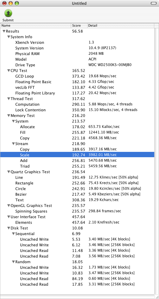

dc297spec Posted March 24, 2007 Share Posted March 24, 2007 Just updated to 10.4.9 and ran xbench now my overall score is at 52 before upgrade I was at 208. Attached is screenshot from xbench look at hd speed very slow... any ideas ???? Link to comment https://www.insanelymac.com/forum/topic/46308-1049-update-slow-hd-speed/ Share on other sites More sharing options...
gotoh Posted March 24, 2007 Share Posted March 24, 2007 use the previous IOATA kext, you might be running in PIO mode... Link to comment https://www.insanelymac.com/forum/topic/46308-1049-update-slow-hd-speed/#findComment-331498 Share on other sites More sharing options...
c*bass Posted April 3, 2007 Share Posted April 3, 2007 Hello, I've got the same problem ! Have you find a solution ? Regards Link to comment https://www.insanelymac.com/forum/topic/46308-1049-update-slow-hd-speed/#findComment-339387 Share on other sites More sharing options...
sg Posted April 4, 2007 Share Posted April 4, 2007 Hello, I've got the same problem ! Have you find a solution ? Regards the post before yours provides the solution : revert to your IOATA from 10.4.8 or whatever you had. Link to comment https://www.insanelymac.com/forum/topic/46308-1049-update-slow-hd-speed/#findComment-339475 Share on other sites More sharing options...
